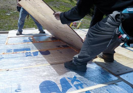

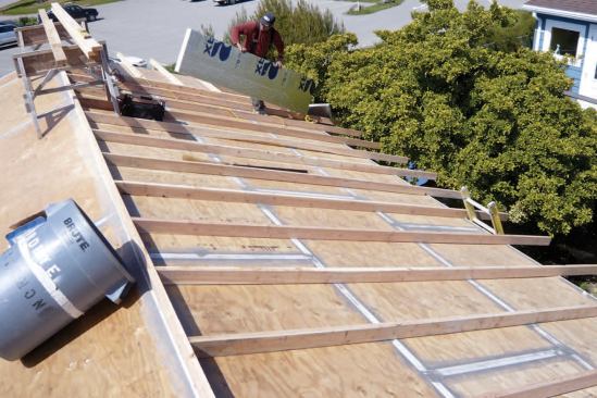

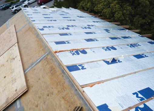

To reduce thermal bridging through the 2×8 rafters, the plan called for framing and insulating what amounted to a second, outer roof over the first. We started by laying 2×4 sleepers on edge over the plywood roof sheathing – staggered between the rafters below – and nailing them in place from beneath. These “outer rafters” extended beyond the wall to create a 2-foot overhang at the eaves. The spaces between the sleepers were filled with 3.5 inches of polyiso board, which was allowed to overhang the wall sheathing by an inch.
Finally, the assembly was sheathed with more 1/2-inch plywood – which, like the sleepers and the rest of the framing and sheathing, was also treated with Bora-Care. Combined with the dense-pack cellulose that would later be blown into the framing of the lower roof, the assembly had a nominal R-value around R-49.

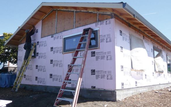

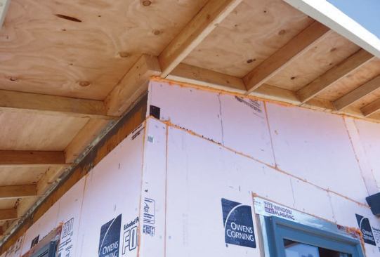

To create a continuous blanket of foam around the air-sealed shell, a layer of 1-inch XPS was then applied over the wall sheathing. At its upper edge, the foam on the walls was beveled to match the overhanging lip of polyiso foam exposed at the edge of the roof , and was sealed to it with more spray foam.

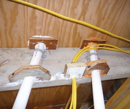

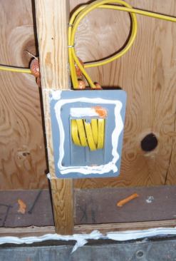

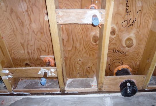

All pipes and wires that penetrated the sheathing were carefully sealed with SIGA tape, caulk, spray foam, or some combination of the three. We also screwed flat plywood backing plates to the framing so the drywall could be caulked around them.

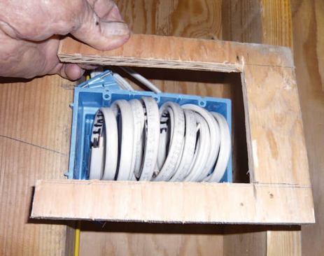

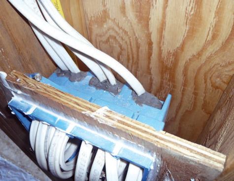

Electrical boxes. We used airtight electrical boxes from Airfoil (612/280-8331, airfoilinc.com) wherever possible. Because Airfoil doesn’t make a sealable three-gang box, we made our own by fastening and caulking plywood “horseshoes” in place around them, and sealing the wire penetration with nonhardening duct sealer.
