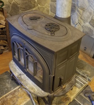

All fireplaces and wood or pellet stoves must be cold. An active fire or even hot coals from a recent fire can become a fire risk during testing. A homeowner needs to be made aware that there can be no fires the day before the test, and, if possible, all ashes should be removed from the fireplace or woodstove.
Fireplace and stove dampers need to be closed during blower door testing. Any doors on these units should also be closed.

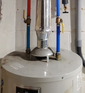

Natural drafting appliances, such as this vented water heater, are not allowed to be sealed.
Any combustion appliances need to be turned off or set to “pilot” so they cannot start during the test. This includes space heaters and water heaters. A negative-pressure blower door test can easily pull carbon monoxide into the home. Fan-assisted combustion appliances may also influence the home’s pressure during the test. Tip: I place my car keys next to an appliance that I have turned off; this way, I cannot leave the home without turning it back on. I also suggest checking any pilot lights after testing. I have yet to have one extinguished during testing, but I’m sure a homeowner wouldn’t appreciate not having hot water or heat.

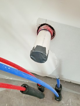

All plumbing traps need to be sealed or filled with water. I often find open plumbing waste and vent piping, especially during new-home testing; a custom shower or bathtub may not have water in the traps. The smell of sewage is the giveaway. Duct tape can make an effective seal when plumbing traps have yet to be installed.
Plumbing drains should be sealed; if the trap is present, filling the trap with water will stop air moving through the waste and drain system. Duct tape can create an effective temporary air seal.

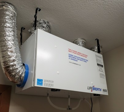

All equipment capable of moving air into, out of, or around a home needs to be turned off before testing begins.
All fans should be turned off. This includes dryers, bath fans, kitchen exhaust fans, whole-house ventilation fans, HRV and ERV systems, and any ventilation fan providing either supply or exhaust ventilation. All heating and cooling equipment fans should also be off. In the case of a whole-house ventilation fan, one that is located either in the attic or crawlspace, the shutters for the fan should be closed, and if there is a seasonal cover, the cover should be installed.

The flue vents for natural drafting combustion appliances shall be in their “as found” position. In other words, you are not allowed to seal off the vent hood of a natural venting gas or oil water heater or natural drafting gas or oil furnace, though I have had inspectors in my area allow builders to seal these vents off during code-compliant blower door tests. They are normally open holes to the exterior and according to the 380 standard, should remain unsealed.

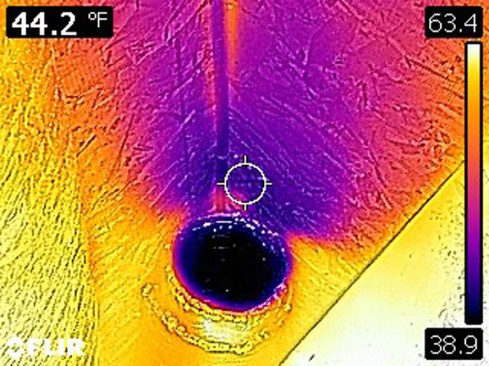

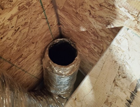

Ducts, like this non-dampered combustion-air supply to a mechanical room, cannot be sealed during a blower door test.
A thermal image of the same vent taken during a final blower door test shows leakage that will increase test results.

The last area is non-dampered openings. Most are not allowed to be sealed. For example, a combustion air vent for natural drafting combustion appliances must remain unsealed. This often results in a 6-inch, non-dampered opening (hole) directly to the exterior that will remain open during the blower door test. (This should influence the decision to install all sealed combustion appliances.) There are two exceptions to the non-dampered rules where non-dampered openings can be sealed. These include continuously operating local exhaust ventilation systems, like bathroom or kitchen exhaust, and continuously operating dwelling unit ventilation systems, such as HRVs or ERVs, that connect to the exterior. Both can be sealed. If either of these ventilation systems operates intermittently, it must be left open. (If either of these ventilation systems is intermittent, the exterior vent will most likely be dampered and will be left as found.)
The thinking behind what is turned off, left open, closed, or sealed is for the home to be in as close as possible to a natural state, or how it operates normally. This gets us the most accurate blower door test that best represents the actual conditions of the home.
