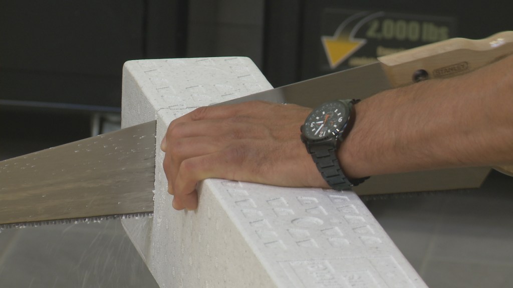

Tip 1: Cutting Trays, Curbs & Benches
Prefabricated shower substrates such as trays, curbs, and benches are ideal solutions for including mortar-free components in any tiled shower. But what if your client has a smaller shower? These prefabricated shower substrates can be cut to size to fit nearly any shower application.
Here’s how:
  • For the shower tray, you can use a utility knife to cut to size. Keep in mind that because the tray is sloped, when you cut it, the perimeter will be thinner. Ideally, cut the tray by equal amounts on all sides—this will keep the height consistent and help ensure an even elevation for the first course of wall tile.
  • The shower curb and bench are both much thicker, so the best approach is to use a hand saw if you need to trim these down in size. Make sure to use a sharp blade, and take the time to draw a square line on the curb or bench to ensure a straight, clean cut. You can cut the curb to height by using a hand saw as well.
