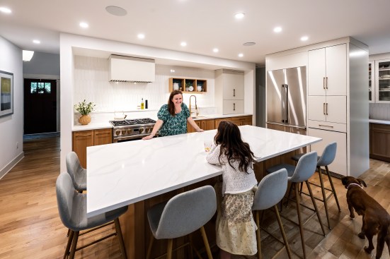

–Look inside first. The dining room is the most reliable source of reclaimed space. Dave Pollard of LivCo in Chicago’s suburbs says that the formal room used a few times a year can easily become the kitchen expansion that makes space for an island, a pantry, and better backyard access. “People tried having dinner parties and couldn’t get anybody to go into the dining room anyway,” he says. “They were all hanging around the island.”

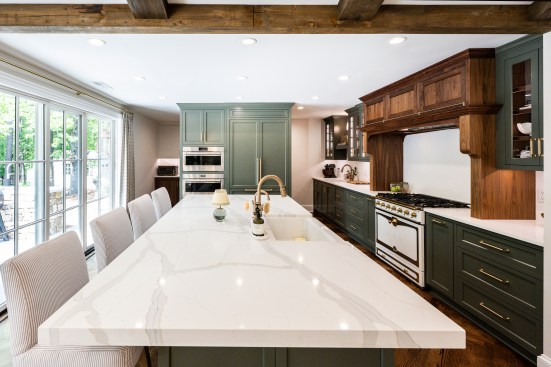

–Consider every adjacent space. Unused closets, enclosed porches, and bump-out breakfast nooks are all candidates. Michelle Merck of DBS Remodel in the Hudson Valley recently extended a galley kitchen into an unused master closet. In another project, she squared off an oddly angled kitchen by borrowing space from a pantry closet. The footprint barely changed on paper. The sense of space doubled.
DBS Remodel
Merck removed a wall and reorganized the space, making room for an expansive island while still giving the kitchen a roomy feeling.

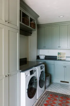

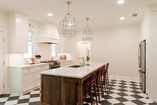

–The laundry room is also a good place to steal space. In Tallahassee’s standard ranch layout, the laundry room sits directly adjacent to the kitchen, so McManus asks every client the same question: Do you actually fold clothes in there, or do you carry the basket to the bedroom? “Most people laugh, because they know the answer,” he says. When front-loaders get stacked and the folding counter disappears, that room can become a pantry or just extra space.
McManus Kitchen and Bath
McManus rearranged the laundry room to create a more efficient space and make room for a pantry.

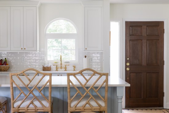

2 Windows aren’t the only way to get more light
Customers ask for more light as often as they ask for more space. “Almost to a T, everybody opens the conversation with ‘I want more light in my kitchen and a better workspace,’ ” Anschel says.
A first instinct is to add windows. But the bigger opportunity is reorganizing the space to let existing light move more freely and strategically using artificial lighting and design tricks to make spaces feel more open.

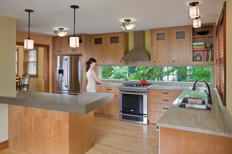

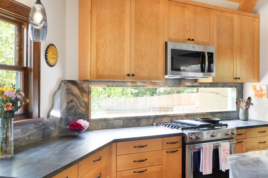

–If the cooktop and range hood are on an exterior wall, consider installing a fixed window between them. Anschel uses this detail to pull light directly onto the work surface in kitchens where windows are limited. It’s unconventional, and it consistently surprises clients with how much it changes the feel of the cooking area.

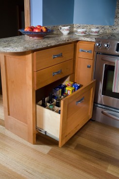

–Convert base cabinets from doors to drawers wherever possible. Clients rarely appreciate how much dead vertical space sits above items piled on the floor of a door-and-shelf base cabinet until a contractor opens one and shows them. Customize drawer heights to match what actually goes in them. A four- or five-drawer bank with modified heights outperforms a standard three-drawer base for small items like utensils, spices, and potholders.

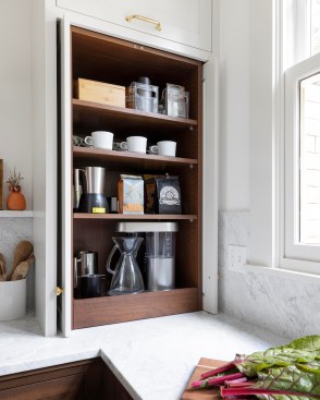

–Keep the beverage and coffee zone outside the cooking work area. The goal is a space guests can access independently—ideally with its own landing surface, a secondary prep sink nearby, and enough distance from the range that two people aren’t crossing paths constantly. Rice recently completed a kitchen where the espresso machine, French press, and microwave all live behind pocket doors in a dedicated zone entirely outside the cooking area.
–Ask whether clients want the zone visible or concealed. A larder cabinet or pocket door cabinet that covers the countertop when closed gives clients the clean look they want for entertaining without sacrificing convenience. Pocket doors stay open most of the time; they close when company is coming.

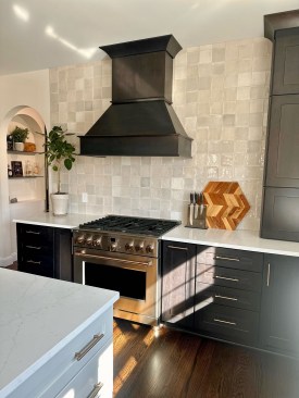

Correctly detail big range hoods
The range hood wall has become an ambitious design statement. Custom hoods anchor the entire room. Think wood, plaster, or tile surrounds that command a wall the way a fireplace commands a living room.
A dramatic hood gives the room a focal point that doesn’t require anything to be clean or put away. “People are really making the hood a decorative piece of the kitchen,” Merck says. “It’s the detail.”
Guidelines
–A large hood needs to be complemented with negative space. Flanking it with equally large cabinet masses makes the wall feel heavy. Flanking it with open shelving, tile, or empty wall space lets the hood breathe and do its visual work.
–When the hood wall eliminates a run of upper cabinets, that storage has to come from somewhere else. Design the compensation before committing to the hood. Options are full-height pantry cabinets on other walls, deep island drawers, or an additional cabinet run where space allows.
–Large hoods above a certain cfm threshold require a makeup air kit—it’s code in many jurisdictions and a genuine safety issue on gas ranges. When the hood activates and depressurizes the house, makeup air prevents flames from being pulled off of burners. Plan for it during design, not during rough-in.
–Vent pipe for a high-capacity hood runs 8 inches in diameter. Getting it to the exterior without a soffit requires knowing where the ceiling joists are before the cooktop location is finalized. Pollard identifies this as another detail that has to be resolved at design.

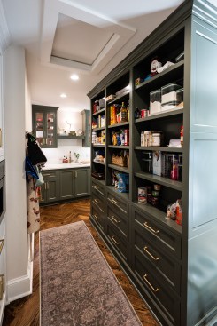

5 The scullery is a practical upgrade
The open kitchen was supposed to make cooking more social. It did. But it also revealed a flaw. When the kitchen is visible from the living room, the dining area, and the front door, the pressure to keep it looking good is constant. Dishes in the sink, appliances on the counter, groceries waiting to be put away — all of it is on display, all the time.

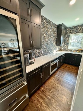

The answer is the scullery, or butler’s pantry, a secondary kitchen where the real work happens while the main kitchen stays camera-ready. It might be a converted laundry room, a walk-in pantry with a countertop added, or a purpose-built room behind the main kitchen.
And while the main kitchen trends neutral, this space gets bold cabinet colors, patterned tile floors, wallpaper, beadboard, soapstone countertops. The design decisions clients talk themselves out of in the main kitchen can find a home in the scullery.
Guidelines

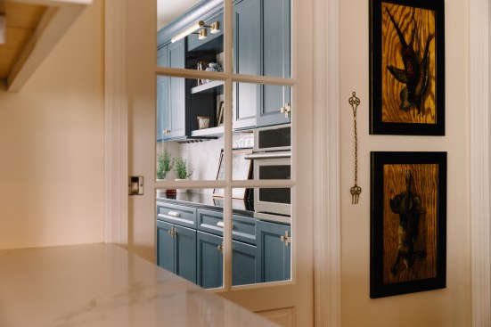

–Design the scullery as an extension of the kitchen, not a separate room. Pollard’s preferred approach runs the perimeter cabinetry straight from the kitchen into the scullery without interruption, with the refrigerator and wall ovens floating as a visual divider between the two spaces.
–Manage sightlines. If clients want a separate area, someone sitting at the island shouldn’t have a direct view into the scullery’s open shelving. Alternatively, the glimpse of color and personality from the kitchen into the pantry is something clients consistently love. A doorway without a door maintains the visual connection while keeping the spaces functionally separate. A pocket door that’s kept open most of the time and closed for entertaining gives clients both options.
–Think about function before footprint, Merck says. The minimum viable scullery is a walk-in pantry with a counter added. A good formula: 16- to 18-inch-deep base shelving for bulk items underneath, a counter at working height, and 12-inch shelves above. Grocery bags land on the counter; you unload standing in the pantry instead of making repeated trips between the island and the shelves. Add outlets and small appliances can live and operate there without ever coming into the kitchen.
