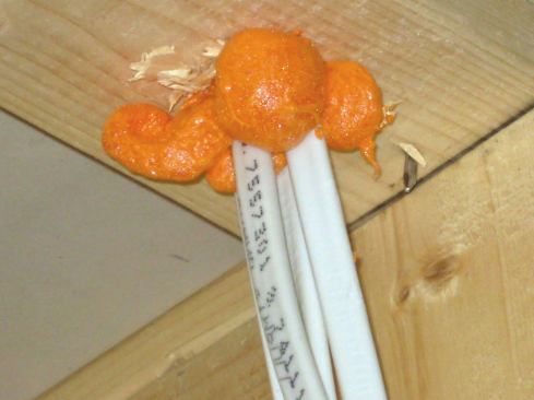

When I’m talking about air sealing the assembly with drywall, my focus is on caulking and foaming the drywall panel edges, sealing electrical boxes and recessed lights, and sealing the intersections where interior partitions attach to exterior walls and ceilings. (Air leaks in hidden places such as the rim-joist and ceiling-joist areas should also be addressed, but those places are usually beyond the scope of my work.) All this attention to detail helps the drywall work become part of the assembly that serves as an air barrier.
To create a good air barrier, two things must happen: The drywall must be attached to the framing in an airtight manner; and all possible air leaks around holes cut into the drywall must be properly sealed. The combination of the drywall, framing, caulks, and sealants makes up the air-barrier assembly.

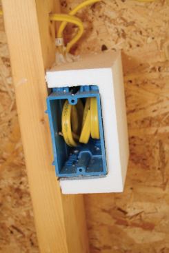

Before the drywall is hung, attention needs to be paid to sealing electrical boxes and other penetrations. Caulk or a non-hardening clay, such as the acoustic outlet backer from Kinetics Sound Control, can be used to plug the holes in electrical boxes. But applying either product is exacting work, and it’s easy to have gaps in the seal if you aren’t meticulous.
I prefer to isolate electrical boxes with Energy Blocks. These are fairly quick to install, and when I’m installing the drywall, I can caulk the thick edge around the box to create a tight seal.

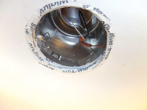

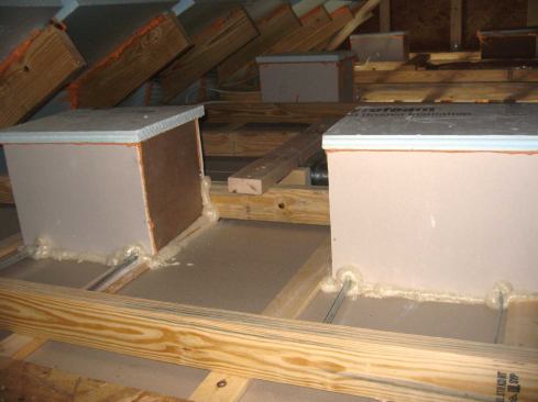

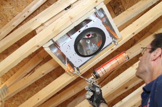

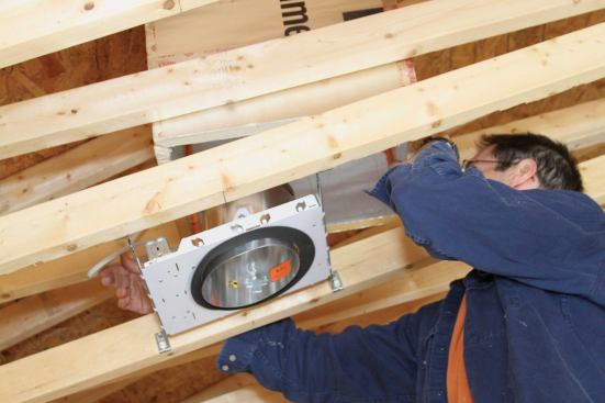

Isolating fixtures in ceilings is especially important because of the stack effect in a building. In a home with an unconditioned attic, recessed lights can be isolated with site-made boxes sealed to the drywall either as the lid is hung or from the attic-side after drywall. This is recommended even for so-called “airtight” fixtures. In most cathedral ceilings, however, the fixtures need to be sealed before drywall. I like to use a box made of foil-faced foam insulation board to isolate the fixtures, and once the box is in place, use spray foam to seal around the wire penetration and mounting brackets.
To complete the seal around the perimeter of each cut-out, I apply a thick bead of caulk to the edges of the isolation box just prior to hanging the drywall. If you have to seal around a box or fixture after the drywall is hung, a good tape such as one from Siga will work much better than caulk.

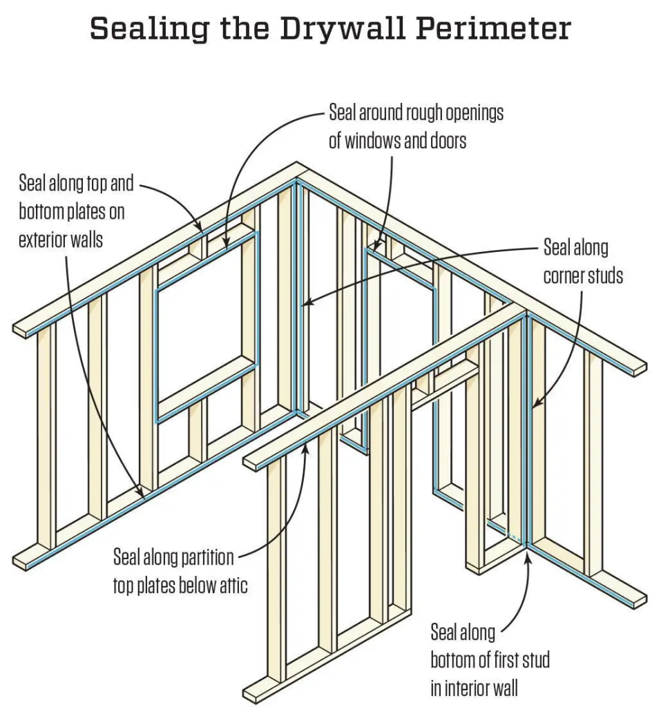

Airtight Perimeter

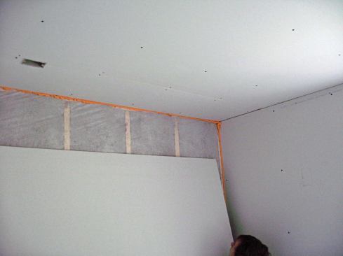

Turning the drywall into an air barrier requires a tight seal at the room perimeter. Drywall adhesive can be used, and most production crews will prefer this out of convenience, but they need to slow down and apply a continuous bead along the perimeter of each wall, as well as around the framing of window and door openings. (Typically, crews only apply beads along the framing in the center of panels.)
One of the most important locations to seal is along the shoe plate. Usually there is about a 1/2-inch gap at the bottom of the wall that is not covered by drywall. Running the adhesive or sealant along the top edge of the shoe plate will pick up the drywall, but the joint between the floor and the bottom of the shoe plate also needs to be sealed.
When I can, I prefer to apply a flexible caulking or an acoustical sealant, which remains elastic over time. Just make sure that the bead is continuous.

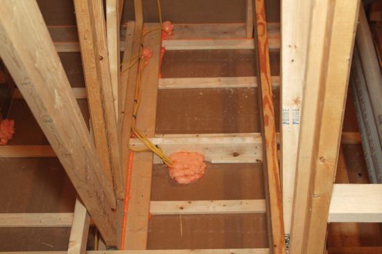

Because of the way that ceilings are constructed, it’s usually more difficult to seal the perimeter of the ceiling than it is to seal the perimeter of the walls. Where trusses cross an interior partition, there’s no continuous framing to seal against. In theory, if the wall panels are properly sealed to the top plates, and the wall panels are tightly butted to the ceiling and are taped, very little air will find its way past the ceiling. But this relies heavily on the paper tape and cured drywall compound as the corner seal, which is not enough. I suggest sealing the perimeter of the ceiling with expanding foam. This must be applied after the lid has been hung, but before the walls are hung.
In an unconditioned attic, the sealing can be done from above any time before the insulation is installed.
