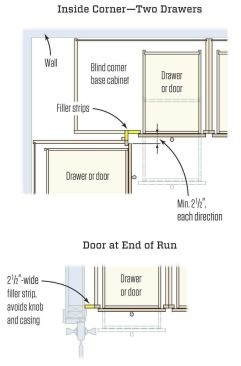

Corner drawers or appliances. Where cabinets meet at a corner, use filler strips to provide at least 2 1/2 inches of clearance in each direction to ensure that doors and drawers can open without interference (see Inside Corner—Two Drawers illustration). Where an appliance must be located at a corner, a filler will also prevent interference with doors, drawers, pulls, and handles.
Door or window at the end of a run. Where a bank of cabinets terminates at a wall next to a window or a door (see Door at End of Run), use a filler strip to prevent interference from a door knob or trim.

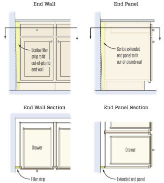

Out-of-plumb end wall. Where cabinet sides meet walls, use filler strips to close any gaps at the ends, scribing if necessary where a wall has an irregular surface or is out-of-plumb (see End Wall illustration).
Finish end panels. Cabinets at the end of a run may need an extended finish panel; the excess depth allows for scribing to walls that are out-of-square or out-of-plumb (see End Panel illustration).

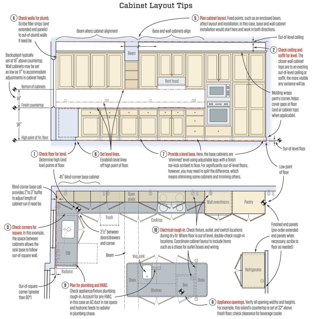

Floors, walls, and ceilings are never as level, plumb, or square as they look, and many kitchens—especially in existing homes—show variations in all three measures. Standard countertop height is 36 inches, but this may vary depending on where the high and low points are in the floor (see Cabinet Layout Tips illustration). Most installers are comfortable shimming or scribing cabinets to correct variances of 1 inch (possibly more, depending on the configuration of the cabinet run).
Check the floor for level. Using a laser level or long spirit level along the wall, find the high and low spots in the floor (check island or peninsula locations, too, particularly if they will house an undercounter appliance). Also spot-check a line about 2 feet out to see if the floor is at the same level across the depth of the cabinets. Mark high and low spots on the floor (or on painter's tape), as well as any other humps or sags—these dimensions will help later when you are setting final base cabinet height.

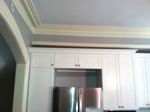

Check soffit and ceiling. The ceiling will usually follow the floor, but not always. Check whether an existing soffit compensates for an out-of-level ceiling, and make sure it is level across its depth. The closer that wall-cabinet tops are to the ceiling or soffit, the more visible any variance will be. Simple, square-profile molding may disguise a small variance; if there are larger problems, now is the time to fix them.
Check corners for square. Measure out a 3-4-5 triangle in three locations—at the floor, at the ceiling or soffit, and at approximate countertop height. Obtuse-angled corners may permit cabinets to be set flush against both walls, depending on the type of corner cabinet used; acute angles may require spacing cabinets away from the wall to accommodate carousel-type hardware. Even where walls are square, a buildup of joint compound may have to be removed to prevent interference with corner base and wall cabinets.
Check walls for plumb. If out-of-plumb walls are discovered before the cabinets are ordered, specify extended panels, whose extra depth will make it possible to scribe cleanly against the wall. (Added height at tall end panels may also be needed to compensate for low spots in the floor.) Where an out-of-plumb wall is discovered after the fact, adding a custom extension on site or adding molding to conceal any gaps may be the only solution.
Check backsplash. Wall cabinets are typically set at 18 inches above the finished countertop, but if you need to adjust this dimension, 17 inches is the recommended minimum. Where wall cabinets and backsplash are in different planes because of an out-of-plumb wall, you may need to use molding to conceal any gaps.
