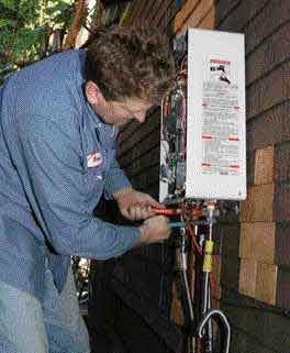

As a remodeler, the thing I like most about on-demand heaters is that they are small — typically 24 inches by 18 inches by 9 inches — and will fit in places conventional heaters won’t. Since basements are not common in this area, water heaters have traditionally been housed in a closet or attached garage. Changing over to a tankless model allows us to put this space to better use.
It’s possible to vent the heater through the roof, but venting through a sidewall minimizes the flue run and frees up additional space where the flue used to be. We frequently remove masonry chimneys that can’t meet seismic code and, with no need for a vertical flue, pick up space on both floors of the house. If you consider what it costs to add square footage during a remodel, spending more for a tankless heater may be the least expensive way to go.
Combustion-air requirements. On-demand heaters burn gas quickly, so don’t install them in enclosed spaces without providing an adequate supply of combustion air. The manual will tell you how much you need. One way to deal with this complication is to use a direct-vent model; combustion air is piped directly to these units from outdoors. We have installed a number of tankless heaters in crawlspaces, which is legal provided the access door is large enough to enter the area and service the unit.
The area where I work has a very mild climate — it never freezes. For this reason, it’s common to install on-demand heaters outdoors on the side of the house. This frees up interior space and eliminates the cost of installing a flue. Units designed for outdoor use have an internal electric heating element that prevents freezing, allowing outside installations in climates cooler than ours. But if the power goes out, the heater can freeze and be seriously damaged.
Also be aware that the heating element protects only the heater — the water lines must be insulated and may require heat tape or a conditioned chase.
Clearances. As with any heating appliance, certain minimum clearances are required around the unit and between the flue and flammable materials. The rules are straightforward and can be found in the installation manual. Clearances apply indoors and out. For example, the flue outlet for a side-vented unit needs to be some minimum distance from doors, operable windows, and intake vents.
Setback rules can be an issue, too. There have been instances where we were unable to install the heater on the side of the house because we were too close to the property line.
