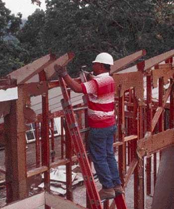

We also sell plenty of 1 1/2-inch T&G roof decking, heavy posts, and structural beams (Figure 2). Around here, there’s a big demand for old clay roofing tiles that can be used for repairs or additions to existing structures. Patio bricks and pavers are also easy to sell.
Figure 2.It’s not economical to salvage short pieces of framing lumber or sheathing, but longer material readily finds buyers. This 1×4 skip sheathing was sold from the site, along with most of the 2-by framing stock.
