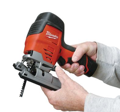

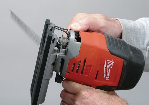

The M12 has several deluxe features, including a keyless shoe that tilts 45 degrees both ways with a stop at 90 degrees, a tool-free Quik-Lok T-shank-blade clamp controlled by a lever so you don’t have to touch hot blades, a trigger-activated LED headlight that stays on for about 10 seconds after you release the trigger, and an LED battery gauge that stays lit for about two seconds after you pull the trigger.
On the downside, the tool doesn’t let you switch to an orbital mode for coarser but faster cutting and doesn’t have a blower to help clear the cut line. Like other cordless jigsaws, it also lacks a trigger lock-on button.

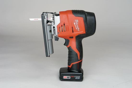

What really distinguishes the M12 is its vertical power plant and “Hybrid Grip.” The motor in conventional top-handle and barrel-grip models nests horizontally inside a barrel-shaped housing directly behind the gearbox. For the M12, Milwaukee stood the motor up and moved it forward beneath the gearbox so most of the weight rests on the cutting area, dampening vibration. This configuration allowed Milwaukee to replace the traditional fat motor housing with a slender handle that’s essentially an ergonomic barrel grip equipped with the type of variable-speed trigger previously found only on top-handle models. The grip is close to the work surface for maximum control when cutting curves, and the variable-speed switch lets you conveniently change speeds on the fly. The hybrid grip also holds the battery.

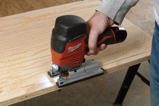

To gauge the battery runtime, I installed a 6-tpi Bosch T144D Speed for Wood blade and made straight cuts in 1/2-inch and 3/4-inch Douglas fir plywood, running the test twice in each panel and averaging the results. The tool cut over 33 feet in the 1/2-inch panel and over 19 feet in the 3/4-inch panel. You can double the runtime by using Milwaukee’s XC high-capacity battery instead, which costs an extra $70.
I also used Bosch blades to cut a sink opening in a laminate countertop, notch Armstrong laminate flooring, cut outlet openings in 1/8-inch paneling, cope pine crown molding, complete the cutouts in 2-by Douglas fir stair stringers, make plunge cuts in 3/4-inch oak plywood, and notch sheet metal. Turning up the heat, I tried to trim 4/4 oak and poplar to fit against a wavy surface, notch 1 5/16-inch Tamko EverGrain composite decking, cut decorative curves in 2-by Douglas fir rafter tails, and plunge-cut the fir.
The M12 accomplished all of these tasks, but it had an obvious comfort zone. It easily cut the laminate flooring, paneling, plywood, and sheet metal, and could turn on a dime. To cope crown molding with a jigsaw, you normally hold the tool upside down and cut from behind the stock. I was able to do that with the M12 by squeezing the trigger with my thumb. According to Milwaukee, the tool also accepts the dome-shaped aftermarket Collins Coping Foot that’s popular with finish carpenters. I wish I could have turned off the headlight while coping, because it shined right into my eyes. It also can create unhelpful glare on glossy or bright surfaces.
In a pinch, I wouldn’t hesitate to cut a sink opening with the M12, but jigsaws with orbital action can be much faster. With a Bosch T308B blade, for instance, the M12 cut my laminate countertop sample at about 21 seconds per foot. My corded model with full orbital action did it in about 11 seconds per foot. The M12 easily finished the stair-stringer cutouts.

I did encounter one problem: The tool I tested aimed the blades slightly to the right, which sometimes forced me to skew the tool to follow my cut lines. I confirmed this problem by trying to guide the tool with a straightedge; the tool veered away from the straightedge when cutting from left to right, and the blade itself bent toward the straightedge when cutting from right to left.
