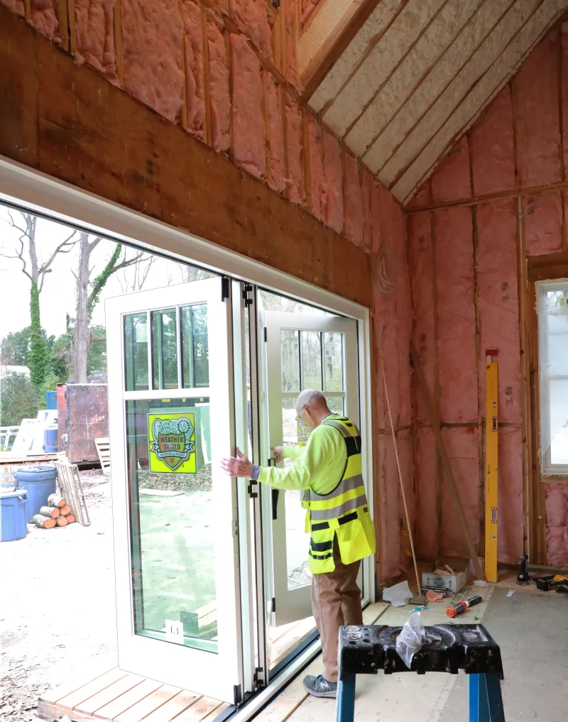

The header for a typical residential sliding or folding glass door is an example of a “deflection-critical” structural member that requires special design considerations over and above other common residential wood framing elements. If a sliding glass door is difficult to open, or inoperable, it may require a contractor to investigate and repair. Frustrating for a homeowner, the same issue may emerge again within a couple of years of repair if the repairs don’t address the root cause.
Difficulty operating a sliding glass door can stem from several causes. While a lack of homeowner maintenance is one common cause, problems are often due to a change in the size and shape of the rough opening, as well. Such a change may result from differential movement of the foundation, seasonal shrinkage or swelling of the wall framing, or, as we’ll examine in this article, deflection of the header.

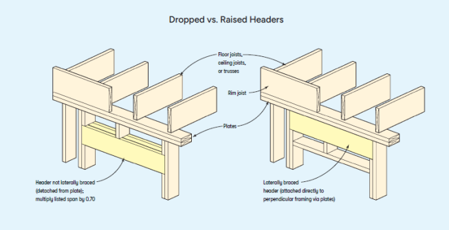

The authors’ case study example assumes a dropped header. This is the more stringent framing condition because the header’s compression edge (the top edge, which is loaded in compression) is not braced by the floor or roof framing above in the same way it would be for a raised header. If a builder assumes a raised header with a braced compression edge but does not apply the appropriate IRC reduction or does not use the correct WFCM table for the actual framing condition, the selected header span could be longer than appropriate. Longer allowable spans can result in greater header deflection.

The first step is to determine the header size required for a 6-foot dropped header. The contractor has several options, starting with the 2024 International Residential Code (IRC) Table R602.7(1), which provides the allowable spans for girders and headers used in exterior bearing walls when the header is laterally braced on the top compression edge (commonly referred to as a raised header).
The top edge of a dropped header is not laterally braced by horizontal framing (see illustration, previous page). Footnote “f” for Table R602.7(1) of the IRC guides builders to multiply the allowable span in the Table by 0.70 for 2×8, 2×10, or 2×12 dropped headers. Alternatively, footnote “f” adds, the header “shall be designed.” Depending on the application, the 0.70 factor can be overly conservative, so for this sliding glass door header we are choosing the Wood Frame Construction Manual (WFCM) instead, which is referenced in the 2024 IRC as one “design option.”

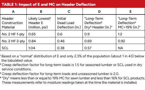

Impact of E variability. For discussion purposes, it is assumed that the clearance height between the top of the door and the frame above it is ½ inch. For our 6-foot door header, each of the three possible header designs are shown in Table 1, Column A (facing page) and each has the same dead-load-deflection limit of 0.30 inch based on L/240.

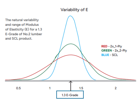

In the graph, “Variability of E” (above), the assumed E for the tabulated spans is based on the E-Grade of 1.3 million psi, the lowest value for the four species groups referenced in the IRC and WFCM (DFL, HF, SP, and SPF). It is important to note that the E-values published in the 2024 NDS Supplement: Design Values for Wood Construction for different species groups and grades are average values, not the E of a single piece (or pieces) of lumber selected from a species group and grade.
As depicted by the Red curve, the range of possible E values in a 1.3 E-Grade when used as a 1-ply header is plus or minus 50% of 1.3 (0.65 to 1.95). The range of possible E values when two pieces of lumber (from different boards) are used in a 2-ply header (Green curve) is plus or minus 35% (0.84 to 1.76). When both pieces of a 2-ply header are cut from the same board, the Red curve would apply. And for a 3.5-inch-thick SCL header (Blue curve), the range of possible E values would be plus or minus 20% (1.04 to 1.56).
The “Likely Lowest Header E” values (Table 1, Column B; above) are the lowest values in the respective E ranges. “Initial Dead Load Deflection” (Column C) was calculated by using Column B values and the header deflection formula (see calculation for ∆LL above). Based on 100% of the design dead load (20 psf for the case study), the tabulated values (Column C) overestimate the apparent dead load deflection because, by engineering practice, design dead loads are greater than actual dead loads.
Impact of long-term loading on deflection. “Long-Term Deflection Dry Header” (Table 1, Column D) is the predicted deflection due to sustained loads (dead loads) when dry framing (less than or equal to 19% MC) is installed and loaded by all sustained loads present when the structure is completed. While the deflection increase is 50% for dry lumber or SCL used in dry-service conditions, for partially or unseasoned lumber the initial dead load deflection can double (Column E). In the 2024 National Design Specification (NDS) for Wood Construction, Section 3.5.2 Long-Term Loading states, “Where total deflection under long-term loading must be limited, increasing member size is one way to provide extra stiffness to allow for this time dependent deformation…” and references the 1.5 and 2.0 time-dependent creep deflection factors used in this article.

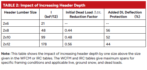

Method 1: One size deeper. When using solid-sawn lumber, the simplest way to protect against excessive header deflection is to use one size deeper than required per code, yielding a large decrease in likely deflection. In addition to using one size deeper, framers can cut lumber pieces for a multi-ply header from different boards to greatly reduce the likelihood of having an extremely low effective stiffness (E) of the header assembly. This benefit stems from the “averaging effect” wherein the variation of the average is much less than the variation of a single element. The variation difference in two versus one element is demonstrated by the Green versus Red curves on the graph “Variability of E.”

When comparing methods, the most practical is Method 1. As demonstrated in Table 2 (below), the “Added DL Deflection Protection” shown in Column 4 is approximately 50%. This can compensate for a header assembly having, for example, an effective E-value less than the published average for the grade and species of lumber.
Referring to the graph, “Variability of E,” the “one-size-deeper” practice is the simplest way to manage the natural variability of E of visually graded lumber at a minimal additional cost. In general, for deflection-critical headers and beams, design professionals are encouraged to adopt a more conservative member depth than the minimum code-determined depth.
