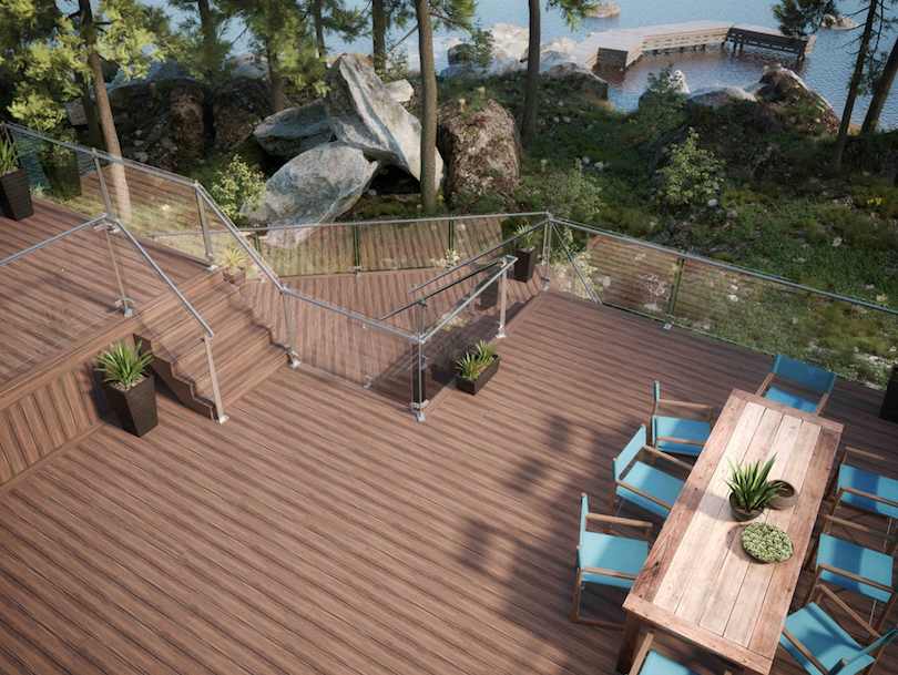

Deckorators' "Mesa" decking is one of several new colors in the Voyage line of composite decking.
Deckorators’ new Voyage line of composite decking features the company’s “Eovations technology,” a fiber-like interior structure made from a blend of polypropylene and mineral filler. The manufacturer claims that this configuration delivers the industry’s best strength-to-weight ratio, absorbs virtually no moisture, and minimizes thermal expansion and contraction. Voyage also has a protective capstock with textured embossing for improved traction. New for 2019, Voyage will be available in 12-, 16-, and 20-foot solid and slotted-edge profiles, as well as in 12-foot fascia. Pricing starts around $4.75 per linear foot.

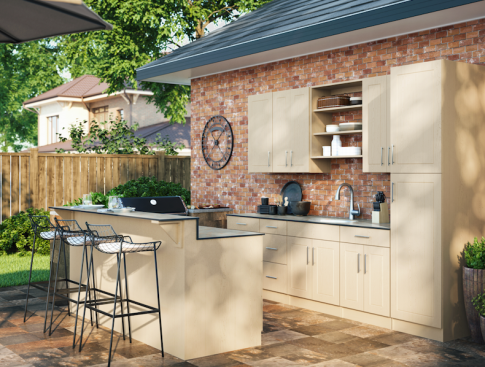

WeatherStrong outdoor cabinets.
WeatherStrong outdoor cabinetry is made from a ¾-inch marine-grade waterproof polymer. The manufacturer reports these cabinets are assembled with precisely positioned dowels and a fast-cure, solvent-free adhesive. Door pulls, hinges, and drawer runners are 316 stainless steel. The factory finish is an embossed wood-grain texture that’s offered in four styles and three colors. Pricing starts around $175 to $250 per linear foot, depending upon model and door style.
