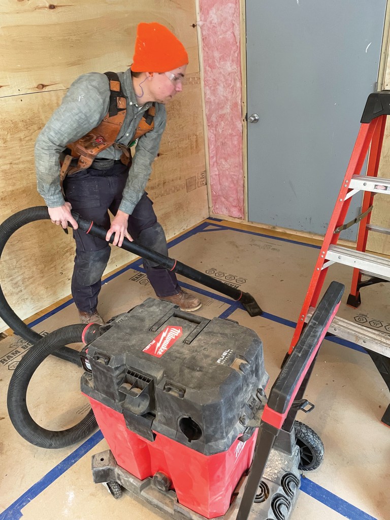

The Milwaukee M18 Fuel cordless wet/dry vacuum is powered by a dual-battery motor head that can be fitted to a 12-gallon tank (top photo) or to smaller and more portable 6-gallon (above) or 9-gallon tanks. The 0930-22HD kit includes the 12-gallon tank and matching cart with a handle, along with a hose, extension tubes, a filter, and other accessories.
Power. The Milwaukee 0930-22HD is a true shop vacuum in that it is not specifically designed for attachment to power tools for use as a dust extractor. Compared with the other corded shop vacuums that we own, the Milwaukee performs well in terms of suction, though we noticed some loss of power when attempting to vacuum larger debris as the battery charge dropped. Milwaukee advertises the runtime for two 12-Ah batteries as 49 minutes for light debris and 34 minutes for heavy debris. For our typical remodeling work and our start-of-the-year shop cleanup, the vacuum performed closer to the 49-minute advertised runtime.

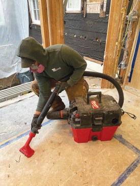

We also tested the dual-battery motor head on the smaller, 6-gallon tank, which, when used without the cart, reduces the vacuum to a portable unit that lends itself well to punch-list work. Milwaukee also offers a single-battery M18 motor head, which we didn’t test, and says that it plans to release a 120-volt AC motor head that will work with all parts of this system.

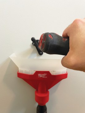

Dust collection. The large, 2 1/2-inch-diameter hose performed well without clogging in post-demo cleanup, and the Air-Tip dust collector attachment was a favorite among our team. This attachment uses the suction created by the vacuum to stick to a wall under­neath the work area where dust is being created. Whether used for dust collection for cutting plaster with a multi-tool or drilling pilot holes for handrail brackets, this attachment has proven to be valuable in keeping finished interiors clean.

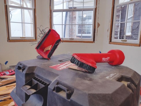

Crew members used several optional Air-Tip vacuum accessories that are available from Milwaukee, including a magnetic utility nozzle and a corner brush (above). When making cuts or drilling holes in walls, they found that the Air-Tip dust-collector attachment (right) was very effective at scooping up debris.
