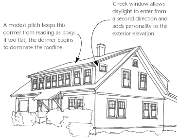

Continuous Shed Dormer
The shed dormer is a versatile option. When elongated, as shown at right, it’s a good choice for continuous headroom and maximum daylight. Though sizeable, this dormer is comfortably nested within the main roof thanks to the entry extension, the slight setback from the lower wall, and the fact that it doesn’t extend the full length of the house. Also, the dormer window size and style relate well to the windows on the rest of the house.
An Unfortunate Dormer
Here, interior space has been maximized at the expense of exterior massing and charm. Because the shed dormer isn’t subordinate to the main roof, it creates a towering, awkward three-story building. The sides of the dormer as well as its face are in the same plane as the walls below, which partially accounts for its unfortunate boxiness; the low slope of the dormer roof completes the boxy effect.

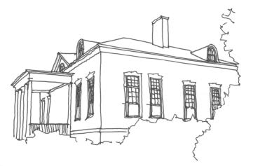

Eyebrow Dormer
The eyebrow dormer is a classic shingle-style feature. As in this example, it is traditionally a small curved-topped element folded into the roof much the way our eyes are folded into eyelids and brows. It provides a peekaboo of light and ventilation. It is not the right choice if your objective is to gain significant headroom. It is a quiet, beloved detail.

Barrel-Shaped Dormer
These elegant barrel-shaped dormers provide dynamic sculptural relief to the otherwise severe blocklike massing of this building. They may well play a more important role on the exterior elevations of this building than as functional devices to add headroom and daylight to the attic.
