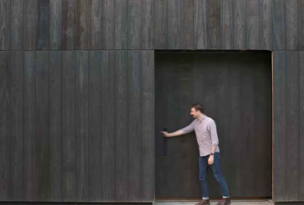

One established innovation is acetylation, a chemical modification process that enhances wood’s dimensional stability and resistance to biological degradation. In simple terms, the wood is treated with acetic anhydride—a vinegar-like, toxic substance that, after curing, leaves no harmful residue in the final product. This process does not turn softwood into hardwood, nor does it create a surface barrier against water. Instead, it alters the wood at the cellular level by reducing water-attracting hydroxyl groups and increasing naturally occurring acetyl groups. The result is a highly durable, long-lasting material that maintains its shape and resists rot—outperforming most traditional hardwoods in exterior use.
Accoya, the leading manufacturer of acetylated wood, offers products with impressive durability and sustainability credentials. Its acetylated wood comes with a 50-year warranty in above-ground applications and a 25-year warranty for use in freshwater or in-ground conditions. Accoya Wood Siding can now be used in WUI-designated areas

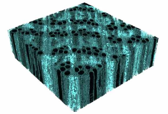

A Florida Atlantic University research team has developed a method to elevate the mechanical performance of hardwood as well. The technique strengthens the cell walls of trees by introducing an iron compound into their vascular systems. Ferrihydrite, a naturally occurring ferric nitrate and potassium hydroxide mineral, increases the material’s durability without much additional weight. “To test our hypothesis—that adding tiny mineral crystals to the cell walls would strengthen them—we employed several types of mechanical testing at both the nanoscale and the macroscopic scale,” explains FAU biomedical engineer Vivian Merk. Merk and her team imagine that such mineral enhancement methods could make wood more comparable to concrete and steel in building structure applications.
