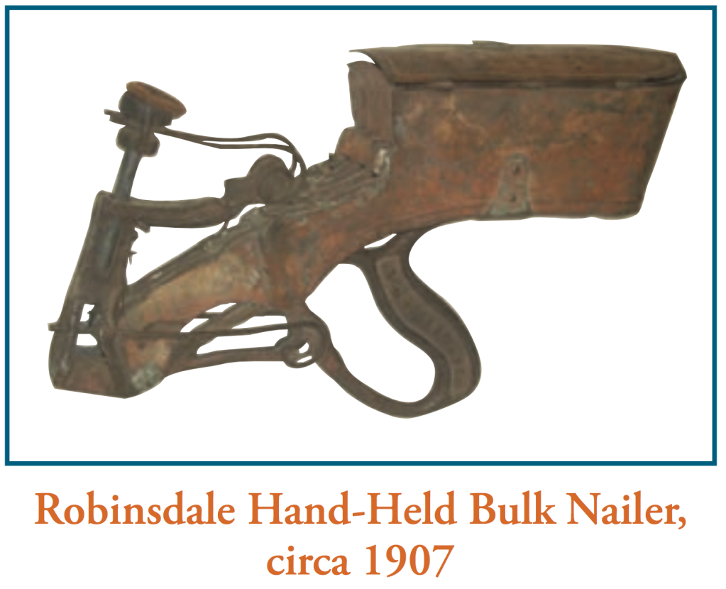

The first commercialized, fully portable nail gun was a hand-held bulk-fed nailer developed in 1907 in Robbinsdale, Minnesota. The machine has a small nail “hopper” that the user filled with .086 x 1-1/4-inch round-head nails. In use, the hopper was shaken so that one nail would randomly feed down the driving shoot. Then you would engage the nailer’s plunger using a mallet - much like the flooring staplers in use today. The mallet that was used had two faces on it: a raw hide face to hit the nailer plunger, and a steel face for the user to finish driving the nail if it didn’t get driven all the way in with the first shot. The nailer never gained great success in its intended purpose to install wood shingles, since in essence it would require three hands to work: one to hold the shingle in place, one to hold the nailer, and one to hit the nailer with the mallet.

The development of the practical portable nailers as used today took a little longer to evolve from there —about 100 years! Preliminary attempts came in the early 1900s focused on creating hand-held nailers that fed and drove loose bulk nails. History shows there were at least three approaches. First was the Robinsdale, Minnesota Hand Held bulk nailer (see photo. You can see a later version restored and in use here.).

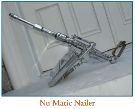

The first commercially successful portable nailing machine used for job-site construction was the Nu Matic Nailer, invented by Bill Burnison in 1951-52.
The most successful portable bulk nailer was the Nu Matic Nailer developed and commercialized in the early 1950s by Bill Burnison in Los Angeles, a true pioneer in the nailing business. It was for nailing wooden roof deck boards used prior to the introduction of plywood. Subsequently Burnison became a leader in the nail collating and in nail gun development.

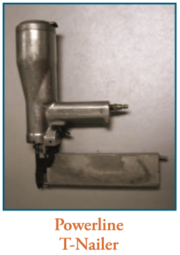

Powerline: Powerline attempted to overcome the recoil problem by developing a cylinder cap which had a spring-loaded clevis. There was a knob on top of the drive piston that would be held in place by the clevis until enough air was dumped on the piston to break the hold of the spring on the clevis. This system never worked very consistently, due to wear and durability of the springs.

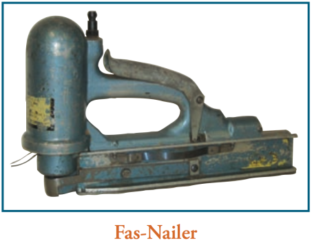

Fas-Nailer: Fas-Nail, founded by Lauren Working (who was an ingenious salesman for Spotnails of Southern California), had their own unique solution to the problem, with a tool that was later developed by International Staple and Machine. Lauren’s idea consisted of welding 50 round head nails into a specially-stamped “ladder appearing” metal strip. His thinking was that when the trigger of the tool was pulled, air would push the drive piston and driver blade down, making contact with the nail held in the strip. When there was enough pressure the driver would shear the nail from the ladder and drive the nail into its position. Although very ingenious, his product failed because of the inconsistency in which it sheared and drove the nails. Since metal varies in hardness, the shearing process would be variable. Sometimes the nails would be counter sunk; sometimes the nails wouldn’t even shear out of the strip.

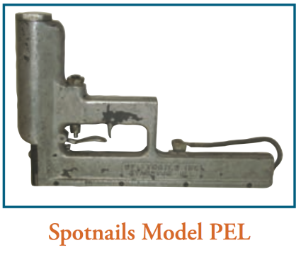

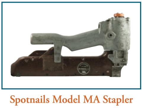

Spotnails: In 1957, Spotnails developed the model PEL, which drove 1/4" to 1-1/4" narrow crown 18 gauge staples. In an attempt to achieve the critical fire power to overcome recoil, it had a two-step trigger. As the operator pulled the trigger through the first step, air moved the drive piston and driver blade of the tool down until the driver made contact with a “sear” that held the driver and piston until the operator finished the pulling of the trigger, which then pulled the sear out of the way. While this approach did develop sufficient fire power to build up behind the piston to drive the staple, it was ultimately unsuccessful due to the erratic relationship between the driver and the sear. Drivers would wear or break; sears would wear or shear.
In about 1958, Spotnails came up with a breakthrough technology that they discovered in an unlikely way. Bill Beckman, chief engineer for Spotnails, gained his engineering knowledge having worked for the Duisenberg brothers in the car industry. Bill happened to be at an industrial design show in Chicago in 1957 and saw a demonstration of a “pop-it” type air system used in the pilot injection seats of fighter aircrafts. This special “pop-it” system was developed by Modernair Corporation of San Leandro, California.
Simply explained, the idea behind the “pop-it” system was to position a large upper piston on top of the drive cylinder to keep the surrounding compressed air from making contact with the drive piston in the tool until the upper piston moved out of the way and dumped (exploded) the air that was in storage in the tool handle into the cylinder to drive the piston. The upper piston was propelled upward and out of the way when you pushed the button or pulled the trigger on the tool, thus leaking the air from the tool. To this day, the “pop-it” principle is the key in the method used to overcome recoil and drive long fasteners. Initially, Spotnails commercialized this as a conversion kit for their mallet driver tools, but soon developed a fully integrated gun.
