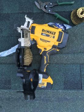

DeWalt's DCN45RNB 20V MAX 15-degree coil roofing nailer is powered by a brushless motor that requires no gas canisters, and accepts 3/4- to 1 3/4-inch-long fasteners.

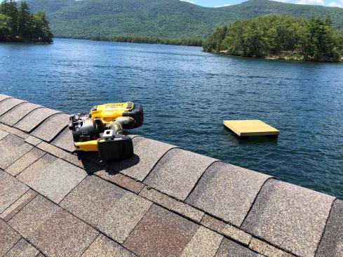

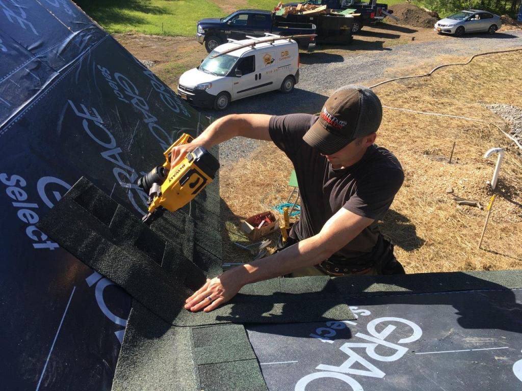

If DeWalt had a specific job in mind when it designed this tool, I think this was the one: A boathouse on beautiful Lake George in upstate New York’s Adirondack Park. Who wants to lug a compressor and hoses down through the woods and over boulders to shingle a 1,000-square-foot roof over the water? Not this guy. So away I went: Step out of the truck, grab the Dewalt bag, head down the trail, climb up on the roof, hold down the trigger, and bump fire four nails into each shingle. Pop-pop-pop—-pop. It did the job, and I would never want to do a boathouse again without it.
After about four hours of shingling, I switched from 1 ¼-inch coil nails to 1 ¾-inch nails for the ridge caps. Again, it performed well. Had I used my trusty old pneumatic Hitachi nailer, I would have shaved about 30 minutes off my shingle install. But then I would have added more time than that in loading the compressor at the shop, unloading at the job, setting it up, taking it down, and lugging it back to the shop. Here’s a quick look at the nailer in action.

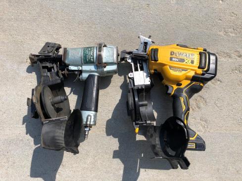

The nailer came with a 2.0-Ah battery, which lasted through almost two square (six bundles) installed. With a larger 5.0-Ah battery, I installed about five square. With the 2.0-Ah battery and no nails, it weighs about 7.4 pounds (for comparison, my Hitachi pneumatic nailer weighs 6.2 pounds); its size and balance make it feel a little awkward in the hand. To adjust, I found myself using a looser grip, letting the nailer hang more from my pointer and middle fingers.
The DeWalt nailer weighs about a pound more than the author's Hitachi pneumatic nailer, and has a plastic rather than aluminum body.
