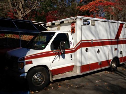

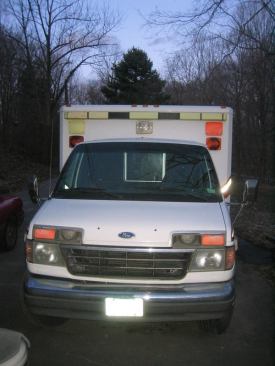

After fruitlessly searching on auction sites like eBay I found a website called ambulancetrader.com. There were several listing relatively nearby but none of them panned out. Then I found a unit for sale in NYC, a 1993 E-350 SuperDuty Ford van with a 7.3L normally aspirated diesel engine. It was owned by a crane operator and had most recently been used as a mobile office and rigging supply truck (he had three). I bought it from him for $1,800.

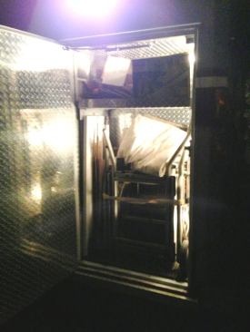

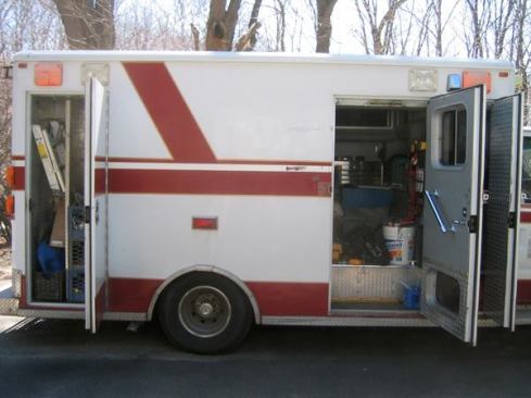

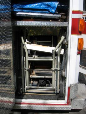

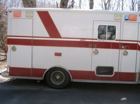

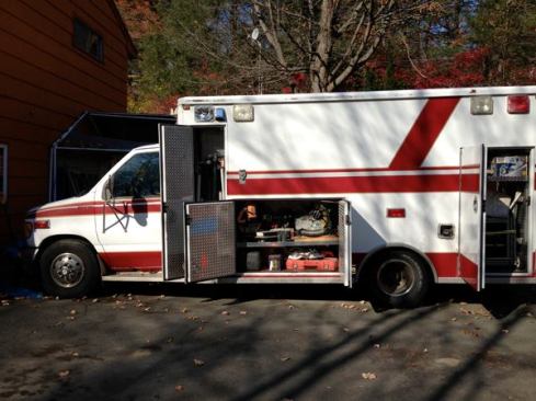

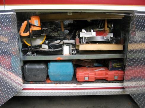

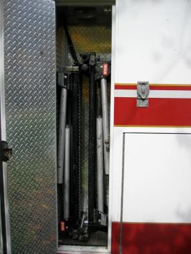

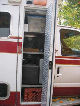

For me, the main attraction of a used ambulance was all the exterior accessible storage in the box, or “module”. One of the compartments is large enough to fit my job site table saw and accessories—at a height where the saw was easy to lift. All the compartments are double weather stripped, illuminated and lockable. And the box is aluminum with stainless steel hardware so it won’t rot out like a service body.

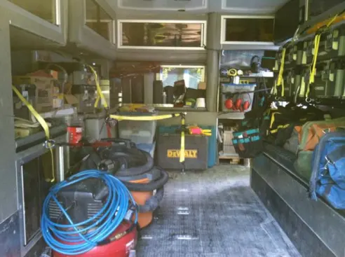

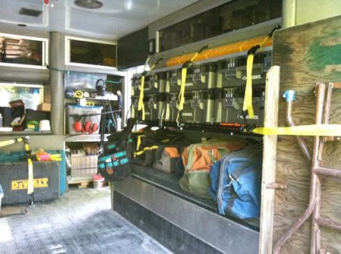

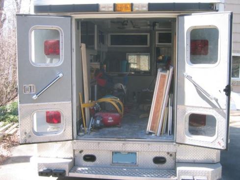

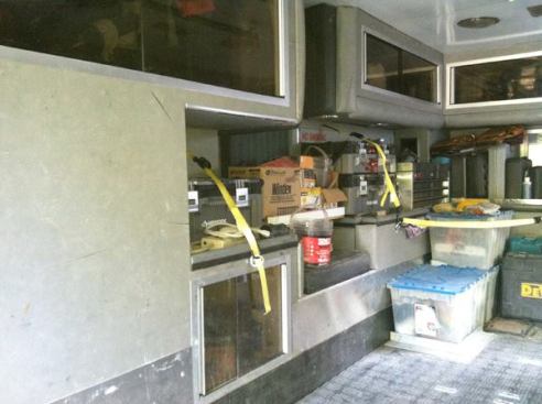

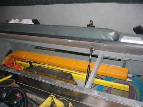

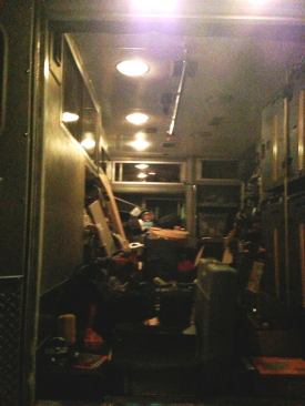

The interior of the module has 6′-0″ of headroom and all kinds of built-in storage cabinets. Between the cabinets is a clear floor area 50″ wide by 12′ long. I can get a 24′ extension ladder inside with the doors closed—or 18′ trim if I’m willing to run it between the seats of the cab. A built-in 1500-watt inverter powers three 110-volt receptacles.

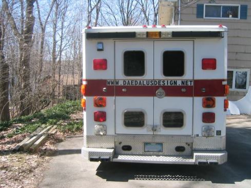

The vehicle required little in the way of conversion. By law the sirens had to be disconnected and the ambulance markings removed. Fortunately, the markings were decals and came off easily. If you swap out the strobe lenses for amber colored ones you can use the strobes for towing and/or blocking traffic in the normal course of work. They have to be amber; anything else can be construed as “impersonating a first response vehicle”. Blue denotes volunteer fire or EMS, red/white/blue is for ambulance or police, and red/white is for fire.
In addition to strobes the exterior is equipped with scene lights that can provide 360 degrees of illumination around the vehicle. The scene lights are particularly handy early and late on short winter days.
