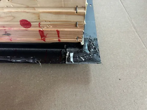

Nailing flanges vary widely by manufacturer. Some are continuous, molded flanges that wrap the entire perimeter. Others press-fit into kerfs in the window frame and overlap at the top and bottom. Some arrive folded and must be bent perpendicular to the frame prior to installation. Factory-applied foam corner fillers often fail to bridge exterior corner voids, especially when installed in cold weather. The worst, in my opinion, are flanges that terminate short of the corners.
When installing windows without a continuous molded flange, I make outside-corner L-pieces from butyl flashing tape. Bottom corners are installed on the inside of the flange and lapped onto the window frame. Top corners are installed similarly, but on the exterior. This extra step is quick and easy, and it adds a meaningful layer of insurance (see photo above).

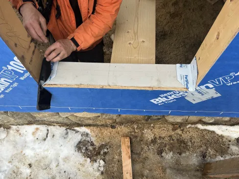

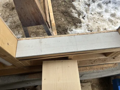

First, I install a piece of cedar clapboard cut to the rough opening width, fastened flush to the exterior edge of the sill with the thick edge facing inward. This creates a positive slope to the exterior (Photo left).

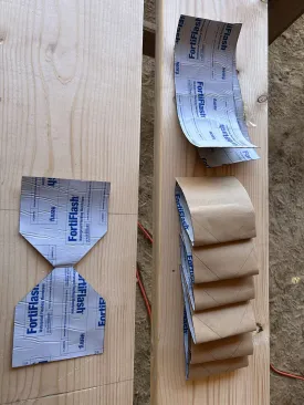

The clapboard thickness also aligns well with 2×6 wall framing. Next, at the bottom corners, I install bowties cut from 6×12-inch pieces of self-adhered flashing tape (Photos below). These bridge the corner, protect the framing, and eliminate the need to fold flashing into tight corners.

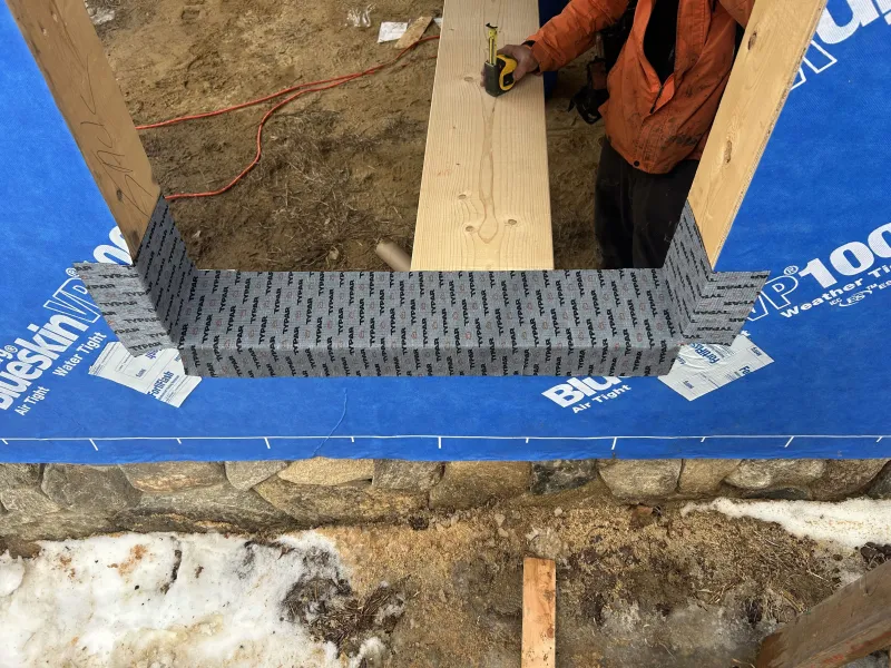

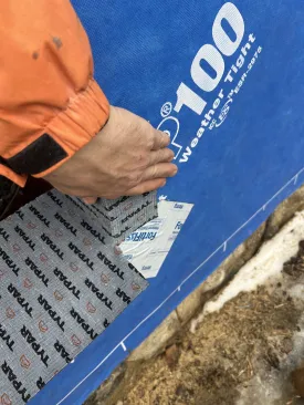

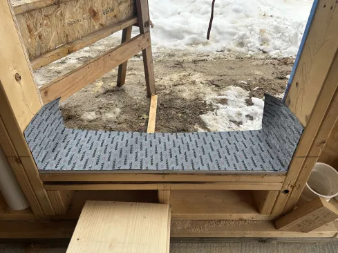

I then cut pan flashing 12 inches longer than the rough opening. I prefer Typar flexible flashing tape for its ease of use. For 2×6 walls, 9-inch flashing works well. Leaving a 2-inch exterior projection provides enough material to fold and adhere the flashing to the WRB, while the interior portion can be turned up to create a back dam. Horizontal relief cuts at the exterior corners allow the flashing to fold cleanly, creating a pan that will shed water if needed (Photos below).

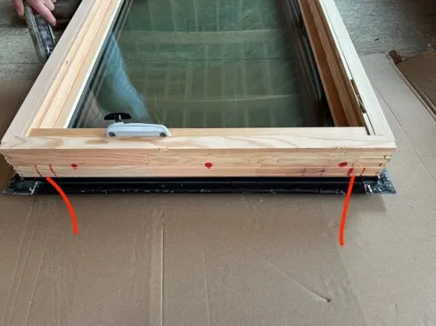

Confirm the rough opening size or dry-fit the unit. From each bottom corner of the window, mark 2 inches and 4 inches inward along the flange. These marks (Photo below) define where sealant will stop. Apply a 3/8-inch bead of sealant to the back side of the nailing flange around the perimeter, leaving two 2-inch gaps at the sill to allow any water that reaches the pan to drain out. Install and fasten the window per manufacturer instructions, taking care not to compromise sill drainage.
