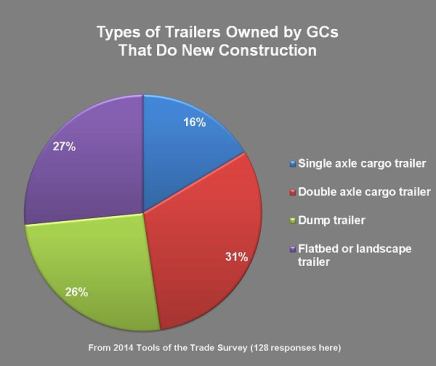

Earlier this year we conducted a survey and one of the questions was “Do you haul a trailer? If so, what kind?” The answers were multiple-choice; choices included:
Single axle cargo trailer
Double axle cargo trailer
Dump Trailer
Flatbed or landscape trailer
The pie charts in the slideshow on this page contain the responses from all who answered and from each trade with at least 25 survey participants: remodelers, GCs doing new construction; handymen, finish carpenters, and electricians. The responses from other trades count towards the total but are not individually called out. Nothing against those trades, but it would be unreasonable to draw conclusions based on the handful of responses received from plumbers, painters, and the like.
