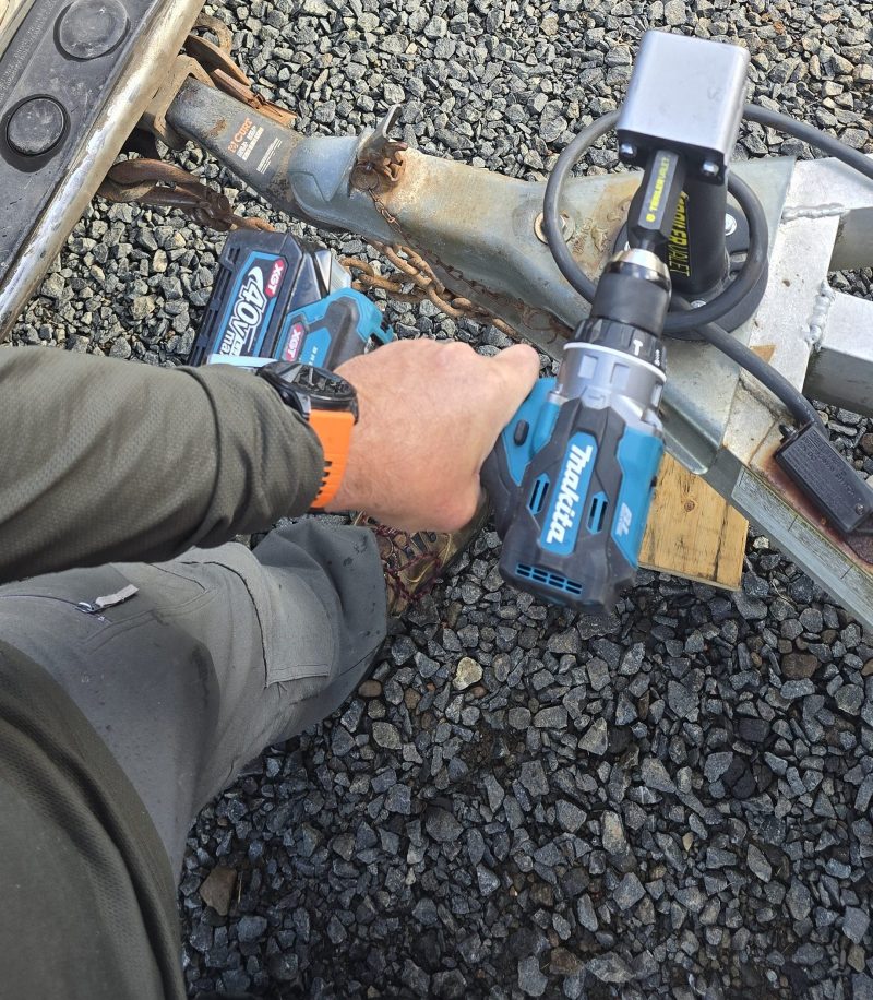

The GPH03 hammer drill is noticeably smoother than the previous GPH01. Makita reworked the motor control to deliver a more progressive soft start, which makes a difference when starting large augers, self-feed bits, or hole saws. The drill holds rpm longer under load and recovers faster when it hits knots or dense grain than its predecessor. Heat management is also improved; the tool maintains consistent power during long boring sessions instead of tapering off. It should be noted that all this torque comes with a sacrifice in speed; even with a 3-speed gear box the GPH03 is 200 rpms slower than the GPH01.

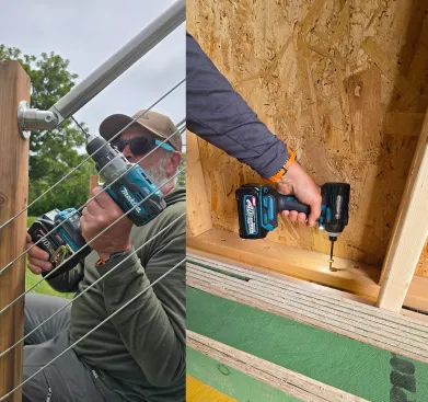

Makita’s GPH03 hammer drill (left) and GDT04 impact drill/driver (right) are optimized for heavy-duty work, especially when paired to 4.0Ah and 5.0Ah batteries. This extra torque and speed may not be necessary for all users, but for heavy work this pair meets real jobsite demands.
The GDT04 impact driver is ½ inch longer than its predecessor the GDT01. While this may seem like a negative to some, I believe this is an improvement. That ½ inch moves the collet out farther from the base and keeps the battery from getting in the way with shorter bits. But its speed is what stands out. With 4,400 rpms and refined assist modes, the driver starts screws cleaner and reduces cam-out—especially useful with structural screws and for decking and metal roofing work. The updated controller also keeps the tool cooler during repetitive fastening, which helps maintain speed throughout the day.
