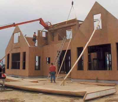

At least one Florida house has already provided a test case for SIP homes facing storm winds. Builder Cameron Bradford was the general contractor for the "Not So Big" Show House at the 2005 International Builders Show, a showcase home framed using Insulspan SIP panels ( www.insulspan.com). The building was hit by three hurricanes in a row while still under construction in the fall of 2004.
"Hurricane Frances brought 105-mph measured winds at the airport," Bradford says, "and our house survived without any damage at all. We didn't even have the windows or doors in yet, and the wind came right inside the building." But with SIP exterior walls and a flat SIP ceiling on the second floor supporting a truss roof, the Orlando house is "built like a plywood bomb shelter," notes Bradford. "It was not damaged at all."
Simple connection details were a real plus, reports Bradford: "The biggest advantage is the speed of construction." The house took just four days to set, he says, "and that's including our learning curve, using SIPs for the first time." Tying the house down was a snap: "We used Simpson hold-downs at every panel joint into the slab foundation — that was definitely overkill. Then we had flat straps spanning the first-floor frame, just at the panel joints.
"In a stick frame, you're installing two connectors for every stud, and six or eight nails per connector," he explains. "That is a lot of nailing. The SIP walls were much, much faster."~
