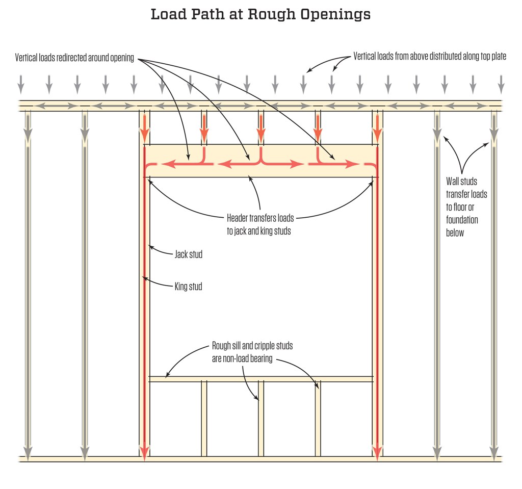

The wall framing transfers the weight of the house down through the frame. Studs, the vertical members in a wall frame, are primarily responsible for that duty. When we remove studs for a door or window, those vertical loads must be redirected around the opening. We accomplish this with horizontal framing members called headers that act as beams that span the openings. Headers then transfer the loads to vertical framing supports—known as king studs and jack studs—on the sides of the opening. (Jack studs are also referred to as trimmers.) If the opening is for a window, we install a rough sill between the jacks and the short studs known as cripples below the sill. (Short studs used above a header are also referred to as cripples.)
Click to enlarge illustration above
The other structural functions of a rough opening are more subtle but no less important. We frame house walls to resist lateral loads and shear forces from wind or seismic activity. A wood frame skinned with properly attached sheathing offers good lateral resistance, but the framing around an RO must be able to offer the same resistance. In special cases such as high-wind areas or in active seismic zones, you may need to beef up RO framing or limit the number of openings.

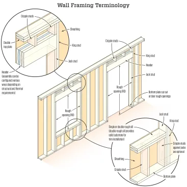

Vocabulary:
Rough opening (RO): Framed opening into which a door or window fits.
Plate: Horizontal framing members at the top and bottom of a wall that the studs nail to.
Jack stud: Vertical framing members that flank each side of a rough opening and support the header. These are also know as trimmer studs in many parts of the country.
King stud: Full height vertical framing members that the jacks attach to.
Header: Horizontal framing member that forms the top of the rough opening. May be structural if the wall with the opening is a supporting (load bearing) wall.
Cripple: Short studs that fill in under a rough sill.
Rough sill: Horizontal framing member at the bottom of a window RO, often doubled.
Sheathing: Typically plywood or OSB that is fastened (usually nailed) to the framing; provides shear strength to the wall frame and a nailing base for exterior siding and trim.
Centerline: Horizontal midpoint of an opening, usually designated with a CL.

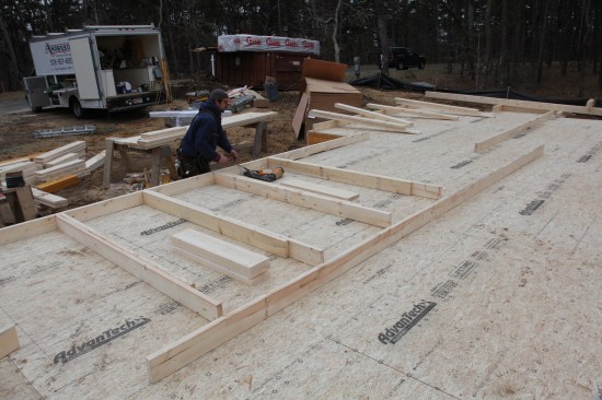

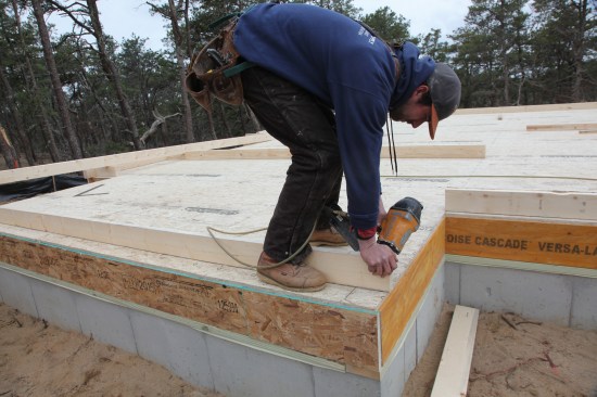

As with a stud-wall, the top and bottom plates should be cut to length, tacked together, and set in position along the snapped line on the floor deck. If a wall is to have openings, lay out the openings first before laying out the rest of the framing.

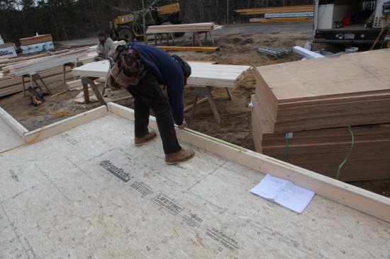

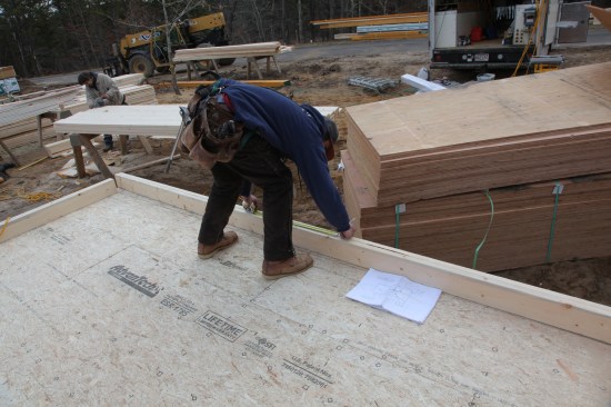

Measure to the Center To lay out and locate the RO, measure over the distance specified on the plans and mark the center of the opening.
Let’s say that the plans call for the center of the first opening on a wall to be 6 feet 6 inches from the end of the wall. Measure over an mark that point. Get in the habit of labeling every mark you make on the plates. Label the center of the opening with a “CL” (shorthand for centerline) along with the measurement that you pulled to that point. Many framers also write what the open is for and the RO size, such as “Window/32 inches.” Once you’ve established the center point, measure over 1/2 the RO—16 inches in this case. That point is the inside edge of the RO on that side, so keeping the hook of the tape on that point, measure over 32 inches for the other inside edge of the RO. Mark both of those points and then draw three lines: One for the inside edge of the RO and two more at 1 1/2 inch intervals from the first. In the space closest to the edge write a “J” for jack stud (the framers in the photos used an “O” to designate a jack), and in the space next to that, write an “X” for a full stud, which will be the king stud for that side of the opening.
First One Side... Measure from the center point half the width of the RO. This point indicates one inside edge of the RO.
First One Side… Measure from the center point half the width of the RO. This point indicates one inside edge of the RO.
...and Then the Other From the side of the RO that you just marked, measure over the total wdith of the RO and mark the other side.
…and Then the Other From the side of the RO that you just marked, measure over the total wdith of the RO and mark the other side.

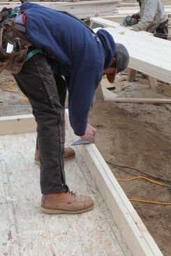

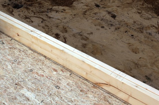

Mark the Kings and Jacks On each side of the RO, draw a line for the inside edge of the RO and then two more lines at 1 1/2-inch spaces. Mark the space closest to the edge of the RO as the jack (with a "J" or an "O") and mark the other space with an "X" for the king stud.
If the plans locate the center of the next opening in the wall at a measurement from the end of the wall, hook your tape on the end of the plates and pull that measurement, repeating the same layout procedure as before. If the location is measured from the center of the first opening, put the hook of your tape on the centerline point of the first opening and measure over for the centerline point of the next opening, and then repeat the layout procedure.
After all the openings are laid out, go back and pull the centers for the studs and other details such as ladder backs or partition studs. Pull the stud locations right across the openings. The layout points will locate any cripples that are needed between the header and the top plate, and if the opening is for a window, they will be needed for the cripples below the sill as well.
Completed Layout This completed RO layout shows the centerline of the opening as well as the king and jack studs on either side of the opening. Note that the RO dimensions were also written on the plate for reference while framing the opening.

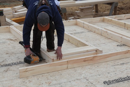

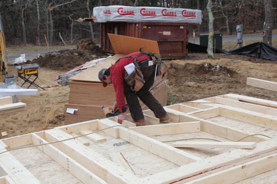

Building rough openings

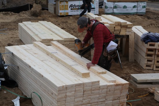

Assemble Kings and Jacks A production crew precuts and preassembles as many parts as possible. Here the crew member nails a jack onto a king stud. Headers are also preassembled to match the width of the 2-by framing stock, in this case 2x6s (Header Configurations).
Most production framing crews set up an impromptu “factory” to cut all the wall framing parts they’ll need ahead of time, including jack studs, cripples, and sills (see Building and Raising Exterior Walls, June 2016). Headers are cut to the proper length and assembled to the thickness of the wall framing. For the 2×6 wall in the photos, two 2x’s are sandwiched together with 1-inch layer of rigid foam and a final 2x layer to complete the thickness. (It should be noted that there are many different header configurations based on regional differences and energy-performance criteria, Header Configurations). As each framing part is cut, it is labeled and stacked for quick and easy access during the wall-building process. As part of the prep work they usually nail the jacks to the king studs ahead of time.

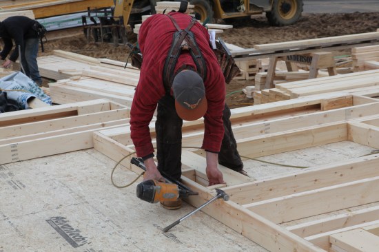

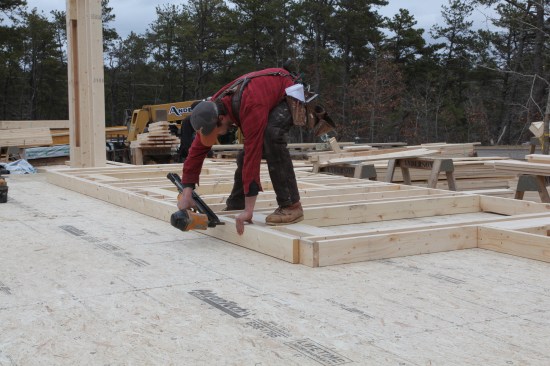

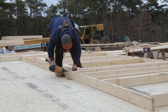

Tack the Bottom Plate After the layout is complete, the crew member separates the plates and toenails the bottom plate to the snapped line. The toenails keep the plate in place while the wall is built, and act as a hinge when the wall is raised.
When ready to begin building a wall, a crew member separates the two laid-out plates a little more than a stud’s length apart, and then tacks bottom plate to subfloor along the snapped layout line. He then brings over the king/jack assemblies (a pair for each opening), along with the header for that opening. After nailing the king/jack assemblies to the bottom plate, and he snugs the header to the tops of the jacks and drives nails through the king studs and into the header.

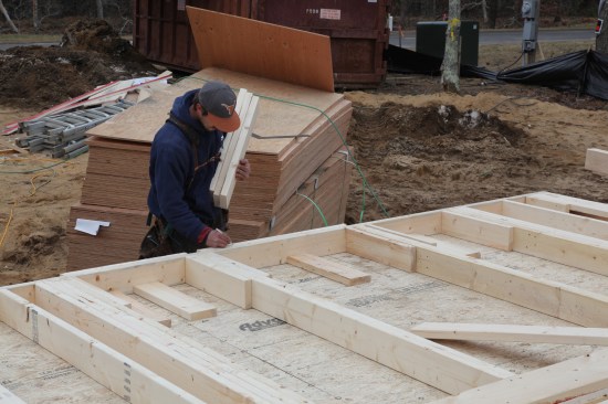

Kings and Jacks First The crew member distributes king-jack assemblies for each opening along with the appropriate width header. The kings and jacks are the first framing members to be nailed to the bottom plate.
Headers Come Next Next the header snugs up againt the jacks and the crew member drives nails through the king stud into the header to hold it in place.

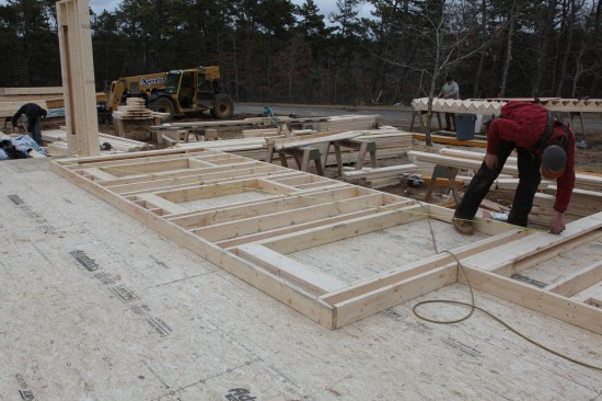

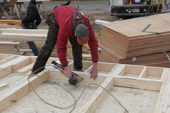

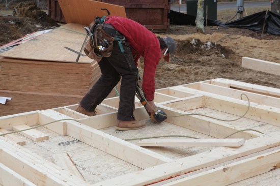

ROs for Windows For door ROs, the framing stops with kings and jacks. For windows, the crew member first loads the spaces with the right number of cripples. (Note that this crew installs cripples against the jacks to support the ends of the sill. These cripples are often eliminated to save material and to maximize insulation in the wall).
Sill Layout The crew member places the sill for each window against the plate and copies the cripple layout onto the sill.

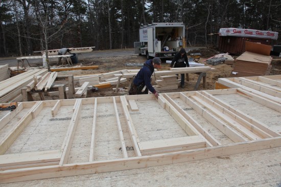

Next any full studs are set into place along the wall and nailed to the bottom plate as well. At this point the first top plate is nailed to all the vertical framing members. For door openings, the framing is complete except for short cripples between the header and the top plate (if they are needed). For window openings, the crew member then loads each opening with the right number of cripples as well as the sills (either one or two sills depending on the specifications). To lay out the sills for the cripples, he places the sill against bottom plate and transfers the layout.
Cripples Go In For each opening, first nail cripples to the jacks on either side if specified. Then nail the cripples to the bottom plate.
First Sill The first sill nails to cripples using the layout copied from the plate earlier.

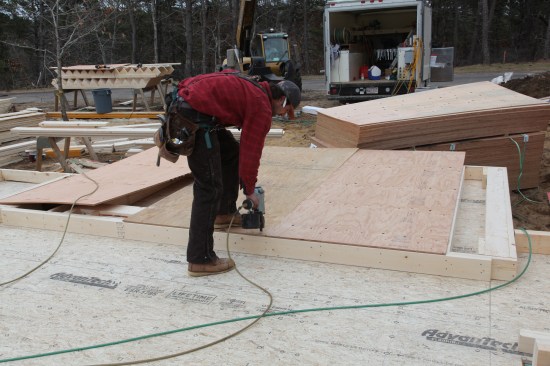

Sheathing The sheathing tacks to the frame with the specified gap between sheets.

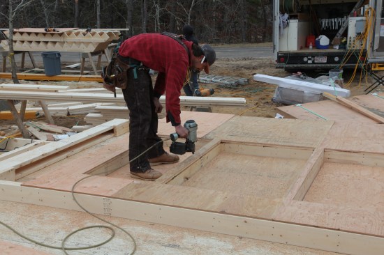

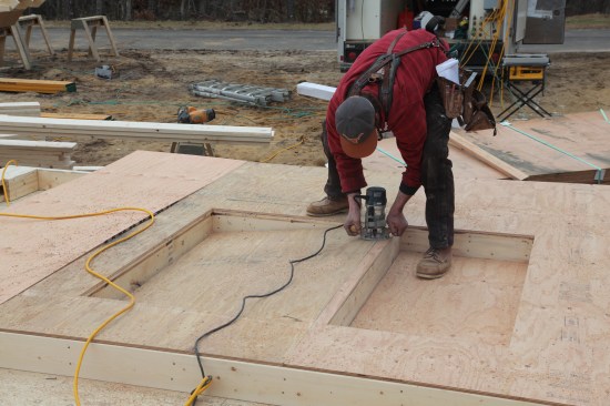

Rout the Openings After tacking the sheets in place, a router with a flush trim bit cuts the openings quickly and efficiently.

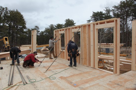

Up She Goes The crew raises the completed wall and then braces it plumb while adjacent walls are built.
