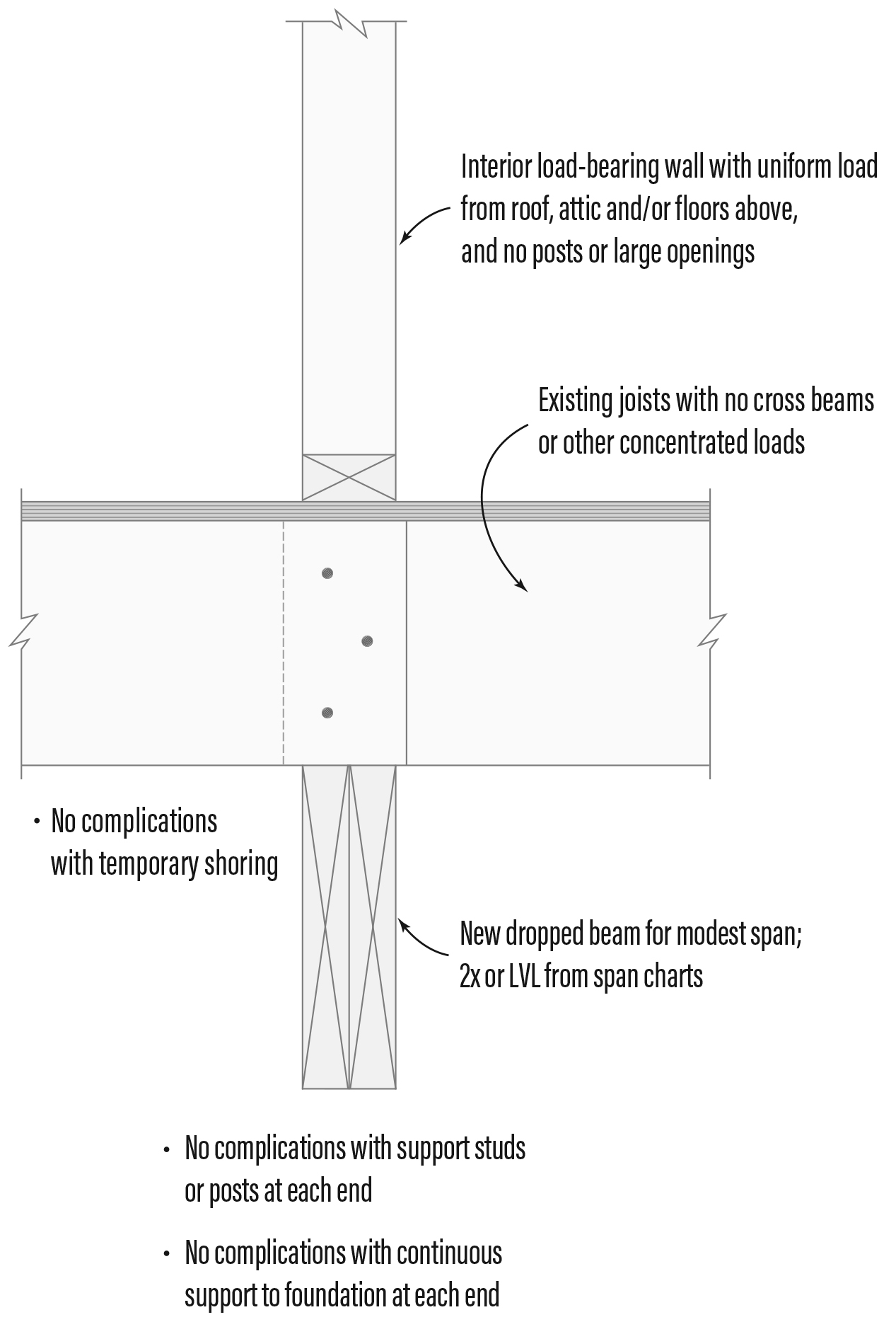

When You (Probably) Don’t Need an Engineer
If you’ve been in the business a while, you know how to specify structural wood beams using span charts from the code or engineered lumber manufacturers. If the project is relatively simple, those charts (and your skills and experience) are all you’ll need.
You likely will not have to call a structural engineer if most of the following conditions are met:
It’s an interior wall. The loads that most interior walls have to support are less complex than those borne by exterior walls, and you rarely need to worry about lateral bracing for wind and earthquake loads.
It’s a short span. A good guideline is 12 feet or less. The issue is deflection. Though 12 feet is not a magic number, anything shorter, in my experience, is rarely a problem.
The load will be uniform. The beam will not have to support perpendicular beams, braces, or other concentrated loads.
There’s room for posts. If you can install jack and king studs at each end of the beam, and there’s a clear and straightforward path to transfer those concentrated loads all the way to the foundation, you should be OK.
You don’t have to cut the joists. If the new beam will be installed below the existing ceiling rather than embedded in it, the job is a lot simpler.
The foundation is stout. The posts that support the beam for the new opening will need to transfer their loads to existing grade beams or crawlspace piers.
There are no unusual restrictions. These could include limitations on beam depth or the fact that the homeowner or architect wants to use decorative materials, whether a non-rated wood species or some other material.
You’re not drilling through the beam. Drilling should be limited to, at most, a few small holes for wiring.
There are no temporary support complications. Support should be a straightforward matter of building temporary walls on either side of the wall to be removed, as well as below them if there’s a basement.
There are no non-technical demands. That means no permitting, zoning, or customer requirements for an engineer.
If nearly all those conditions are true, then there’s likely no need to call an engineer. Use the span charts to identify appropriate beam and support sizes, shore it up, cut it out, frame it in, and you’re done.
Click here to enlarge
Simple load path and span under 12 feet. In the scenario shown above, conditions make it relatively straightforward to define a clear load path to the foundation. In this case, the job can probably be handled by a competent builder.

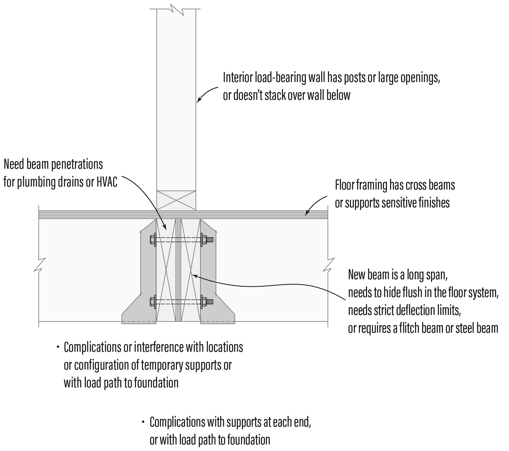

When It’s Wise to Seek Help
Although most jobs will be straightforward, there are situations where you will want to consult someone like me. Use the following complicating factors as a checklist to help you make that call.
This is a long list, but don’t let it stress you. The most common situations that call for an engineer are the first two: long spans and flush beams with depth restrictions. The other ones are much less common, but you need the ability to identify them.
Long spans. For most beams exceeding 12 feet in length (and for all beams longer than 14 feet), you should run your plans by an engineer.
Depth-restricted flush beams. Say that you’ll be recessing the beam into a floor system with 2×8 joists and that the span chart calls for an 11 1/4-inch-deep LVL. If you’re OK with 4 inches of beam protruding below the ceiling, there’s likely nothing to worry about. But if you want to create a flush ceiling by using multiple 1 3/4-inch LVLs side by side or perhaps a flitch beam or steel beam, an engineer should specify them.
Concentrated loads. These include cases where there was a post embedded in the old wall that supported a perpendicular beam. The new beam will have to support concentrated loads, and the needed calculations will go beyond the scope of standard charts. An engineer needs to specify the beam as well as the connections.
Load path questions. You will need an engineer if you don’t have room to install simple supports at either end of the beam extending continuously to the foundation.
A simple load path is where the ends of the new beam sit directly on posts (whether solid posts or built-up 2-bys). To transfer the posts’ concentrated loads down to the foundation or footing, you will probably need to add blocking in the depth of the floor system. If you have any uncertainty about how to do this, call an engineer.
You should also seek help if the load path is complicated and less direct. An example is where one of the new posts lands directly above a basement feature—whether a furnace closet or a countertop in a finished space—which means you’ll need to install a beam down there to transfer the concentrated load.
You can’t get to the foundation. Let’s imagine that there’s no clear way to transfer a post’s load to the foundation and that your only option is to install a post below the floor system that bears on a 4-inch basement slab—or perhaps on dirt, in the case of a crawlspace. Most contractors will dig and pour a new footing (which includes jackhammering a hole in the slab if there is one). It sounds straightforward, but you should consult an engineer on the required thickness and steel reinforcement.
Call an engineer. In this second scenario, the beam is embedded in the floor joists (a flush beam), and creating a simple load path is not possible. In this case, the builder should seek guidance from an engineer.

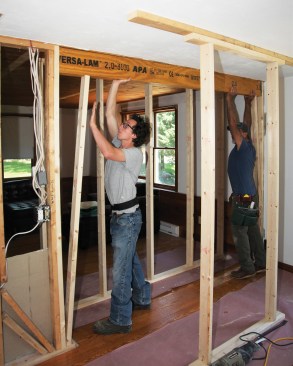

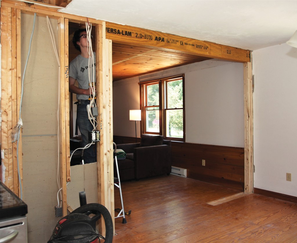

Removing part of an interior bearing wall to create an opening less than 12 feet long with a direct load path to the foundation is a straightforward condition that most competent builders can handle on their own. However, on the job shown here, an engineer provided by the LVL supplier verified the beam size and bearing requirements—welcome guidance for the builder.
