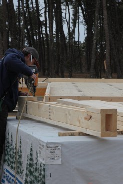

All headers are built before wall framing begins. For 2x6 walls, headers are made from three layers of 2-by material with a layer of 1-inch foam. Here the crew member squares the material before nailing it together.
All headers are built before wall framing begins. For 2×6 walls, headers are made from three layers of 2-by material with a layer of 1-inch foam. Here the crew member squares the material before nailing it together.
Typically, one person makes all the headers. Unlike our colleagues on the West Coast who have ready access to thicker stock such as 6x8s, we make our headers from built-up layers, depending on the thickness of the wall framing. For 2×6 framing, headers are made from three layers of 2-by stock and a layer of 1-inch solid foam insulation. As each header is assembled, the crew member writes the length on the header, stacks it with others that are the same length, and then crosses it off his list.

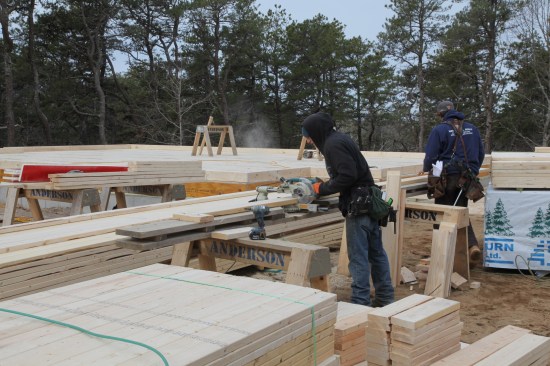

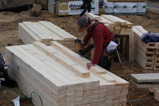

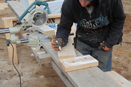

A chop saw station makes quick work of cutting cripples and sills. A stop attaches to the station table for making repetitive cuts.
As each piece is cut to length, it is labeled with the size and what the piece is. Then it is put in a stack with other matching pieces and crossed off the list.
In a different area of the jobsite, another crew member cuts sills and cripples. Cripples are the short studs that fill in the framing below window sills and above headers if needed. Each different window rough opening has its own size sills and cripples, and in most cases, there are many windows of the same size in a home. The crew member in charge of cutting these pieces works at a chop-saw station, where he can use a stop to make repetitive cuts. Working off the list, he cuts, labels, and stacks pieces in piles according to their length and function.

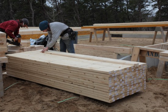

Most of the houses we frame use wall studs that come precut to a length of 92 5/8 inches from our lumber supplier. This length makes the interior walls the right height for two sheets of drywall without our having to piece in a narrow strip. Using precut studs not only saves us the time it would have taken to saw the boards to length, but also eliminates a ton of wasted wood. The exception to this is an area such as a garage where the walls are built on a stem wall rather than on a sheathed deck. The exact length of these studs is determined on site, and they need to be custom cut. For such studs, we cut a pattern with a stop nailed on one end. The crew member cutting the studs then simply butts the stop to the end of the stock, draws a line, and cuts the board to length.
Studs for the house walls come pre-cut from the lumber supplier. But for areas such as the garage, studs have to be custom cut. Here a crew member uses a template with a stop on one end to mark the length before cutting.

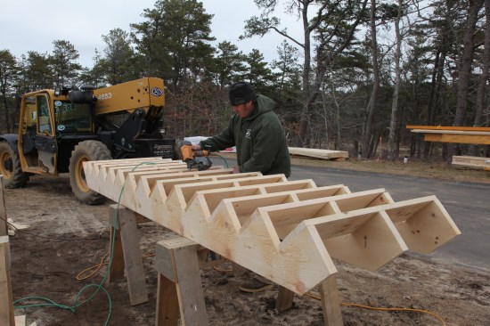

With rise and run taken from the plans, stairs are built ahead of time and installed when the deck framing is done. Solid stairs make it safer and more efficient for workers to move between floors during construction.

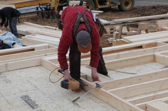

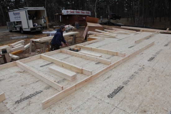

When all the framing parts are made, it's time to remove the tacks that were holding the pairs of plates together. The bottom plate is tacked to the layout line, with the ends set exactly where they're supposed to be.

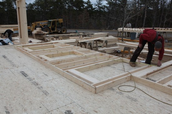

By lunch break, layout was done and most of the parts were cut and ready to go. At that point, one of the lead carpenters began building the walls. The first walls we choose to frame are the ones that extend all the way to the edge of the deck—in this case, the front and back walls of the house. The end walls fit in between those walls and are built after the first walls are raised. The front of this house was actually three walls separated by short jogs. To work efficiently, we assembled all three walls at the same time.

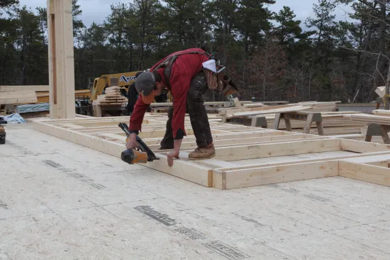

Working the three walls across the front of the house at once, the crew member sets king/jack assemblies where they go along with the right size header. He then works his way down the wall, nailing the king/jack assemblies to the bottom plate.

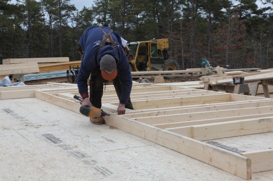

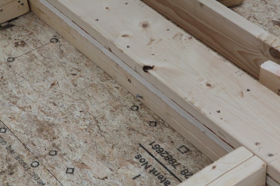

After removing the tacks that held the plates together during layout, we line up the edge of the bottom plate with the snapped line, making sure the ends are 5 1/2 inches from the layout line for the intersecting wall (or even with the layout for one of the jog walls). The tacks keep the plate in place while the wall is built and raised. The bottom plates are then tacked to the deck every 3 feet or so. The top plates are set on the deck more than the distance of a stud length away so they won’t be in the way during assembly.
Next he jumps up on the deck and nails the headers to the king studs after snugging them down to the top of the jacks. Additional nails secure the header to the jacks.

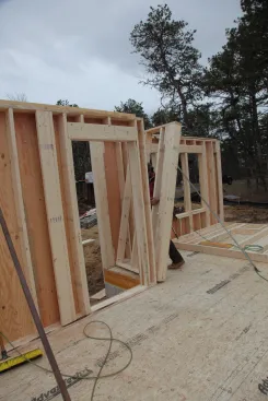

The first framing pieces loaded in are the king/jack stud combinations, which are set in place for the sides of each opening in the three walls. Based on the number written in the opening, the person loading the parts also grabs the right-size header and sets it in the opening. Working down the walls, we nail the king/jack studs to the bottom plates. Then, the headers are snugged into place, nailed through the side of the king stud, and toenailed to the jack as well.
Next the corner assemblies and partition backers are set in place along with the full-length studs. Again the crew member works his way down the walls nailing all of these parts to the bottom plate.

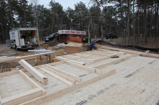

Corners, partition backers, and full-length studs come next, and the person doing the loading grabs them from their respective piles and sets them in place near the layout marks. When the walls are loaded, he nails these pieces to the bottom plate, working from one end of the house to the other. After nailing the last corner, he jumps up on the deck, scoots the top plates over to each of the walls, and nails them off one at a time.

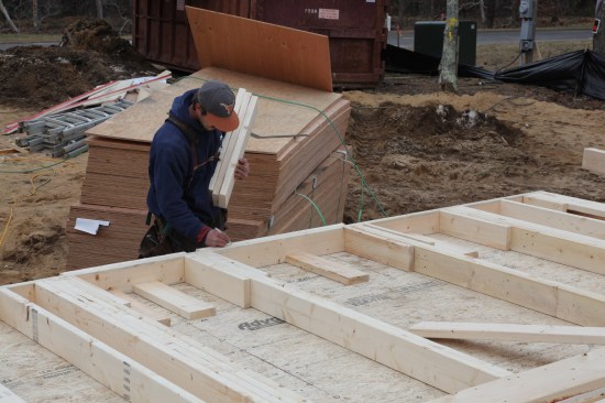

Next the cripples and sills are distributed to the  window openings. At each opening one of the sills is positioned against the plate, and the layout for the cripples is transferred onto the sill.

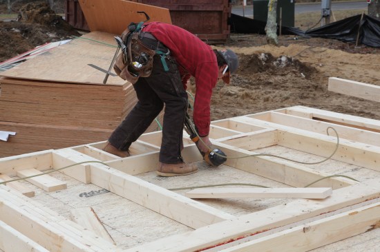

Cripples and sills for the window openings are next in line. One framer grabs the proper-size pieces from the piles and distributes them to their respective openings. As these are set in the openings, the crew member positions one of the two sills against the bottom plate and transfers the layout for the cripples from the bottom plate onto the sill (14). The other sill stays in the opening until installation.

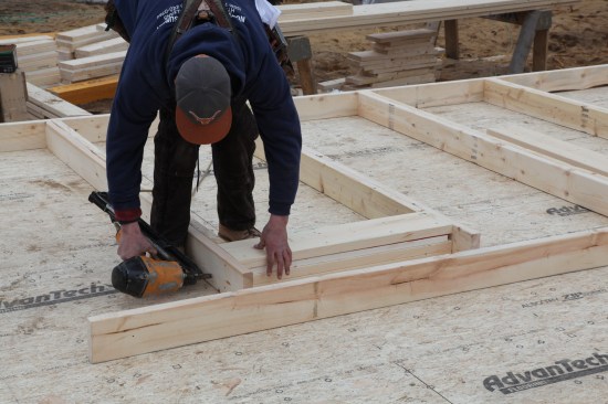

Cripples are first nailed to the bottom plate and then to the sill with the transferred layouts. A second sill nails in on top of the first one to complete the window rough opening.
If needed, short cripples are cut to fill in the framing between the top plate and the header.

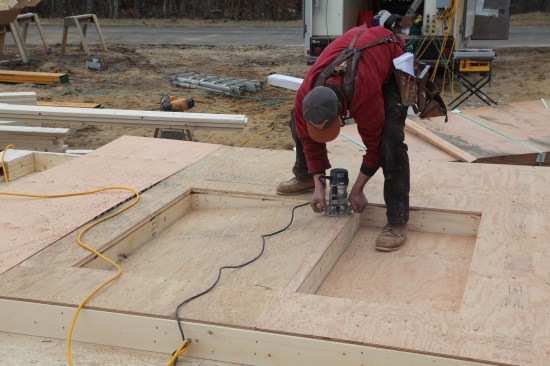

After the sheathing is tacked on, a plunge router with a bearing-guided flush-trim bit cuts out the rough openings. The sheathing is then nailed off according to schedule.

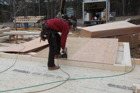

We lay the sheathing panels on the wall framing one by one and tack them to the frame with a nail at each corner. When all the sheathing is tacked in place, we cut out the openings for the windows. We’ve found that the quickest way to cut openings is using a bearing-guided flush trim bit in a heavy-duty router. We simply plunge the bit through the sheathing and then rout the opening, letting the bearing ride along the framing of the rough opening.
When the window and door openings are cut out, we go back and nail off the sheathing. To comply with the high-wind code, we drive nails 4 inches on-center for the perimeter nailing (including around all openings) and 6 inches on-center in the field. The sheathing has to extend down to cover the deck framing when the walls are standing, so we trim off the excess sheathing along the bottom edge.
Raise and Brace the Walls
Before lifting, we have the wall braces and the laser level ready. The last thing we do before lifting the walls is remove the tacks that we drove to hold the wall square. You’ll know pretty quickly if you’ve missed any.

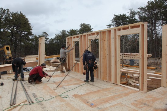

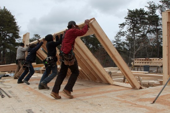

A coordinated effort by the crew makes raising most walls quick and easy. A telehandler can be used to lift the heaviest walls.
For most walls we build, a crew of four provides plenty of lifting power to raise them into position. Most walls are light enough that you can drive a hammer claw into the plate and lift it to get a grip. For longer, heavier walls, we slip blocks under the plates to get the most positive starting grip. On rare occasions, we use a telehandler to raise large, heavy walls, such as a tall gable wall. A coordinated effort sets the wall upright in just a few seconds.

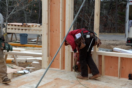

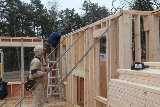

While one or two crew members hold the wall upright, the others work quickly to attach braces. There are many methods for bracing walls, including spring braces and scissor braces that use lumber that’s on site. We prefer using the adjustable metal braces from Proctor (proctorwalljacks.com) that attach to the top plate and angle back to the deck. After getting the wall close to plumb by eye, we nail the bottom of the brace to floor framing. We then set a laser level on the bottom plate and adjust the brace in or out until the wall is perfectly plumb. We put in one brace every 4 to 6 feet.
It’s important that the braces are nailed into floor joists (not just the deck) for maximum strength. This is easy for the walls that run perpendicular to the joists. If the wall is parallel to the joists, we nail a 2-by scrap across two floor joists and then attach the bottom of the brace to that.

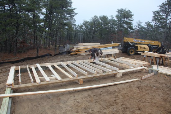

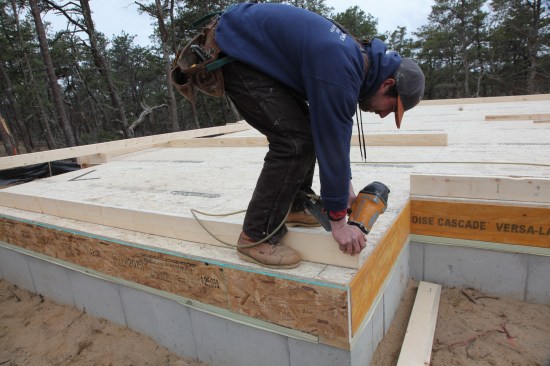

Because of the garage stem walls, there is no flat space on which to build the wall. Instead, the crew cribs up staging planks to support the top plate and sets the bottom plate on blocks next to the mudsills.
The garage presented a unique problem because the walls sat on top of stem walls—there was no flat surface to build the wall on. In cases such as these, we create a temporary support for the wall by setting staging planks on top of piles of 2-by scrap. The top plate lies on top of this support and blocks on top of the stem wall next to the mudsills support the bottom plate.

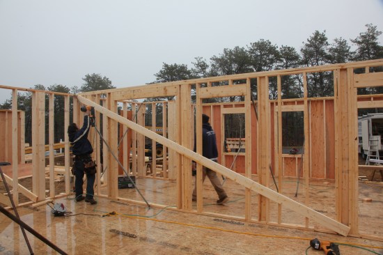

The bearing wall has no sheathing, so a diagonal brace is nailed on from corner to corner in order to hold the wall square and plumb.
We brace the wall plumb as before, but at this point, we still haven’t squared the bearing wall so that the ends are plumb. To do this, we first attach a metal brace to the intersecting wall and draw it in or out until it’s plumb. This in turn makes the bearing wall square and the end of the wall plumb. Then we nail on a diagonal 2-by to keep the wall square and plumb.

Straightening the Walls

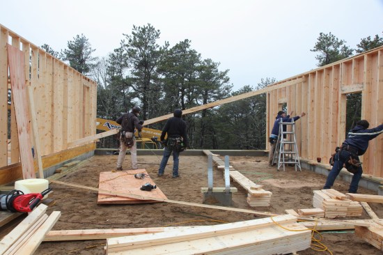

The final task before we can start framing the second floor is straightening the walls. In the past, we have rigged up elaborate strings and blocks, but we’ve run into problems because of irregularities in the material. Despite our best efforts, there were always places where the walls weren’t completely straight, and the strings always seemed to be in the way as the framing continued. We discovered that the best way to straighten the wall is by eye.
Here is where the adjustable braces really shine. One of the crew stands on a ladder and sights down the edge of the top plate, and a second crew member literally dials in the walls by turning the screw adjustment to make micro-adjustments at every brace (29). With braces every 4 feet, we can usually make most walls perfectly straight very quickly. On the rare occasions that a wall bends in or out in between braces, we either reposition the braces to the trouble spots or simply add another brace. These braces usually stay in place until the second-floor deck is framed.
