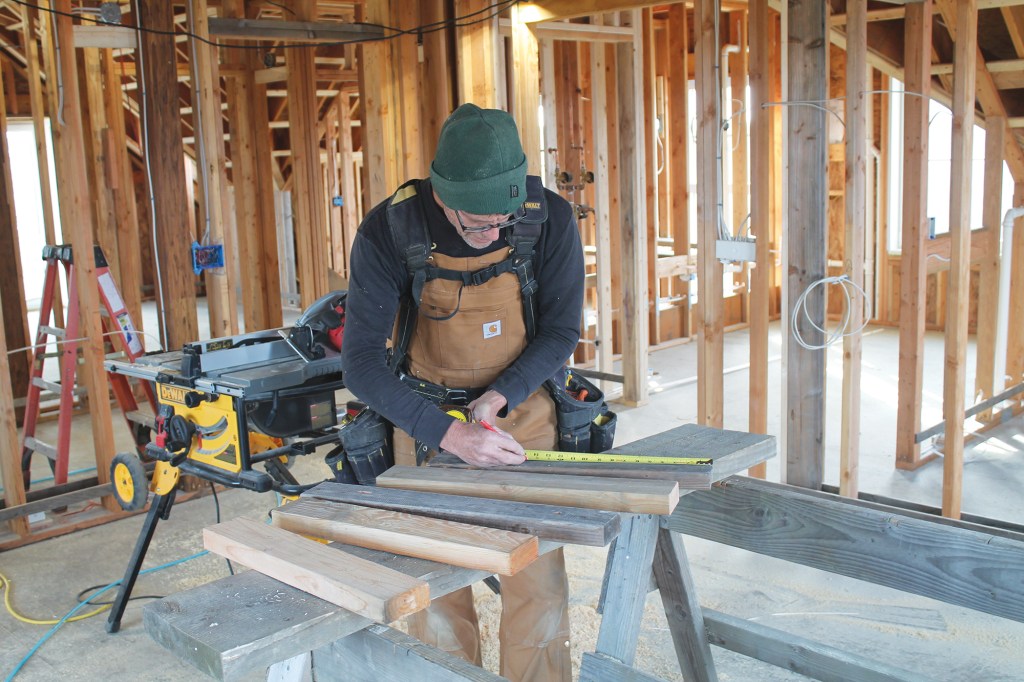

When you’re installing blocking, it’s more efficient to measure, mark, and cut all the pieces to length at once than handle them one at a time. Instead of trying to remember the lengths you need, write them down on one of the pieces.

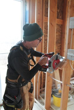

In my experience, speed of motion is mostly a matter of personality; whether you are a fast mover or a slow mover, being efficient means not wasting any of that motion. If you need six blocks, for example, collect six scraps, line them up, take out your tape, pencil, and square once, pick up the saw once, cut them all to length at the same time, and then take them all to where you need to nail them up. Instead of letting them drop to the floor, catch and stack them as you cut; this way, you avoid having to bend over to pick them up.
Practice minimizing your moves. If you can hold something where it goes and mark it, why use a tape measure and square? Better yet, if you can hold it in place and cut it, or nail it on and then cut it, you’ve saved a bunch of steps.
When “speed cutting,” the author aligns the left end of a scrap 2-by with the left edge of the stud on his left and registers the base of the saw against the left edge of the stud on his right, using the 1 1/2-inch offset between the saw blade and the right side of the saw base to deduct that thickness from the block he’s cutting.

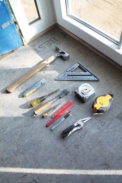

As we carpenters get older, toolbelts weigh heavier on our hips and shoulders. But the most inefficient thing you’ll see on a jobsite is that guy who takes his belt off all the time, typically because it is too heavy and uncomfortable or because it’s bulky and gets in the way.
I would feel naked and unprepared doing most jobs without having at least the following on my person: hammer, tape measure, square, utility knife, pencil, marker, chalk line, chisel, nail sets, small vise grip or pliers, and a selection of nails. Depending on what I’m doing, I’ll add a few other items as needed.
Shown here are the tools the author usually carries in his toolbelt; your selection of must-have tools may vary. You can add a few task-specific specialties as you need them, but loading your toolbelt with tools that you rarely use adds weight, not efficiency.

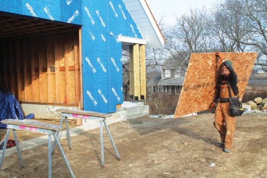

Watch someone work who has spent a lifetime doing manual labor well, and you’ll see efficiency in action. Learn from these guys—when they pick up a couple of sheets of plywood or a stack of lumber, there’s no struggle, no strain, no wasted energy. When they use a shovel, they’re rarely bending over, they’re facing the right direction, and they never lift it half full. They pace their efforts so at the end of the day, they’re still working efficiently. Learn to do that, and at the end of your career, you’ll still be outworking the young pups.
When working with sheet goods, pick up one corner and roll it onto your shoulder in one smooth move to help preserve your body over the long term.

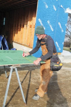

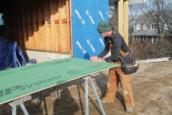

Good carpenters learn a thousand little tricks for saving time and energy and getting good results faster; the best ones never stop teaching themselves. You can learn a lot by watching how experienced craftsmen do things, but the real secret of tricks is ingenuity and application. For example, watch a drywaller, and you will never measure a 91-inch piece of plywood again—you’ll cut 5 inches off a full 8-foot sheet. And to do that, you’ll mark it with a square, or your tape and a finger clamp, or the 5-inch edge dimension of your saw base.
To trim a full sheet of sheathing to 91 inches, measure 5 inches from the short end instead of pulling a tape measure and T-square to measure and mark 91 inches from the long end. To mark the cut, you can slide a rafter square along the edge of the sheathing (above), or simply lock your hand on the tape and slide your finger along the edge, holding your pencil on the end of the tape. Similarly, it’s a waste of time to mark a notch in sheathing with a T-square or chalk line; marking a notch like this by sliding your hand along the edge with a pencil and a tape takes about five seconds (right).

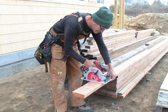

When cutting studs or joists to length off a stack of lumber, skip the pencil line and use a rafter square to guide the saw and make a square cut.

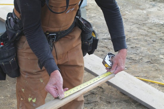

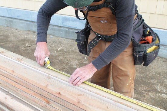

You don’t need a pencil to mark cuts that don’t have to be perfectly square and a precise length, such as when you’re furring out a ceiling or wall with 1x3 strapping for drywall. For longer lengths, just pull a tape and mark the cut with the corner of the tape measure.
You don’t need a pencil to mark cuts that don’t have to be perfectly square and a precise length, such as when you’re furring out a ceiling or wall with 1×3 strapping for drywall. For longer lengths, just pull a tape and mark the cut with the corner of the tape measure.
For shorter lengths, use the tape’s hook to mark the cut.
