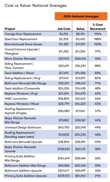

National perspective. Sorted by the highest return on investment, this table ranks all 23 projects in the 2024 Cost vs. Value report.
The project with the highest average ROI on a national basis is replacement of the garage door (with an average 194% ROI), followed by replacement of the exterior door (188% ROI) and the installation of manufactured stone (153% ROI). The one exception, sitting at No. 5, is a minor kitchen remodela modest face-lift of kitchen surfaces that offers a 96% return on investment when done prior to the sale of a house.

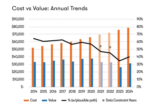

A look at yearly trends (see chart, below) shows that project costs have increased consistently over the last decade, while perceived values have fluctuated in recent years. This fluctuation has resulted in a fall in the overall ROI as post-pandemic disruptions roiled housing markets. However, 2024 shows a definitive turnaround with a solid 5.2% increase in average ROI for the 15 CVV projects that have been in the report since its inception in 2002.
Historical perspective. This chart shows trends based on 15 of the 22 Cost vs. Value projects that have been included in the report since it began in 2002. Note: Data for the 2021 and 2022 CVV reports are shown as separate dots to represent the period with technical issues involved in the data collection, while the connected line represents a plausible path of average % return for the 15 historical projects.
