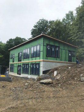

My co-worker Ed Backus and I installed the deck ledger during the framing stage of the house to make sure that the ledger flashing would be properly counterflashed with the door sills and sill flashing and that all the layers of flashing tapes were properly lapped from the start of the project. Flashing the ledger under doors can be difficult as an afterthought if the doors are already installed with taped sills.

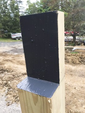

Prior to installing the 6×6 support posts, Ed Backus applied liquid flashing membrane (above) to the post bases (below left) and the notches for a 2-ply dropped beam (below right). Backus first wrapped the posts with masking tape to give the application a finished look.

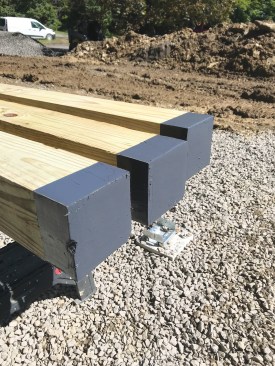

The 2×10 beam bears on 6×6 pressure treated posts connected to the precast concrete piers with metal hardware that provides a 1-inch standoff. We treated all end cuts of the beam and posts, including the shoulders that nest the beam, with Huber’s Zip Liquid Flash to prevent the end grain from wicking in water and shortening the life of the framing. We covered the top faces of all the deck framing with Vycor self-adhered flashing membrane, which we ripped to width using a site-made slitting jig.

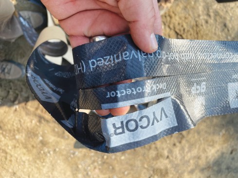

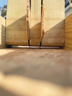

To make a slitting jig, the author kerfed a 2-by block cut to the width of 4-inch-wide Vycor Deck Protector SAF tape, fitted the kerfs with utility knife blades held in place with shims, then tacked in place between a pair of scrap 2x4s as shown (left). Pulling the 4-inch-wide tape through the jig resulted in pairs of 1 1/2-inch-wide strips that were then used to cover the tops of the 2-by joists (above).

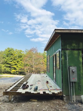

During installation, we opted to create a random pattern for the decking—similar to a hardwood floor—rather than a racked look where each subsequent course has a repeated break in board length. Working from the ledger out, we started every course of decking with the offcut from the previous course, then infilled with full 16-foot boards.
To ensure that the visible fastener heads would be aligned, the author snapped chalk lines on top of the pressure treated decking to mark the joist layout. The width of the deck was planned so that there would be no ripped deck boards; decking was installed from the ledger out toward the rim joist.
We face-screwed the decking to the joists with PamFast coated fasteners. To keep the screw heads aligned, we marked the joist locations by snapping baby-powder chalk lines, then eyeballed the spacing off the edge of each board.

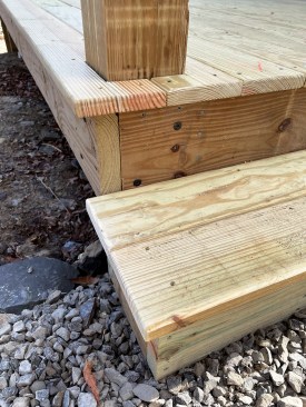

We eased over all the end cuts with a 1/4‑inch roundover bit on a cordless router to match the long edges of the boards from the mill. For now, the client has chosen to leave the decking unfinished.
The author used a router fitted with a 1/4-inch roundover bit to ease all the end cuts on the decking and stair treads.

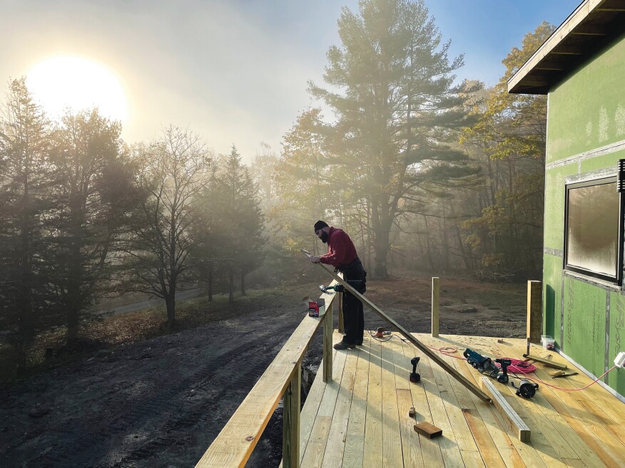

Posts. Before installing the posts, we set up a drill press and spacing jig and predrilled all of the holes for the cables. We wanted to make sure the holes for the coarse-thread fittings in the 6×6 corner posts and the stainless steel grommets through the 4×4 intermediate posts would be seated squarely. Then we dry-set the posts to the frame with a few Irwin Quick-Grip clamps, shimmed them plumb, then fastened them with plenty of solid 2×8 blocking and structural screws.
Top rail. The top rail (some people call this a “drink rail”) of our railing system is a pressure treated 2×6 on the flat, running over the tops of the 6×6 corner posts and the intermediary 4×4 posts. A 2×4 rail runs post-to-post under the 2×6 creating a “T.” We fastened the 2×4 to the 2×6 from the underside using 4-inch-long GRK Multi-Purpose Screws, countersunk 1/2 inch into the 2×4.

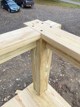

Corner detail. At the two outside corners of the deck, a carpenter might typically miter the top rail, but I find that inevitably this miter will open up as the pressure treated lumber dries out. Instead, I suggested creating a half-lap joint. Ed quickly agreed, and with a stout corded router and a little bit of layout work, he executed the plan flawlessly.

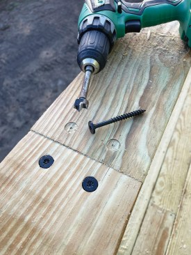

We fastened the 2×6 top rail into the tops of the posts with 2 7/8-inch-long FastenMaster HeadLok structural screws, carefully laying out their positions because they would be exposed. Before driving the screws, I predrilled a slight recess for the screw heads with a 5/8-inch Forstner bit, which helped eliminate any mushrooming or flattening of the wood grain. The customer loves the intentional look of the black fastener heads.
HeadLok structural screws were used to fasten the 2×6 top rail to the posts; to create a slight recess for the broad-headed screws, the author predrilled the screw holes with a Forstner bit.
This is the half-lap detail used at the corners.

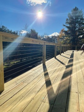

Cable installation. The cable rail fittings came in left-hand and right-hand versions, with a course thread on the side that is screwed into the post, and an open end on the other side where the cable is inserted. After each section of cable is precisely cut to length per the manufacturer’s installation instructions, the cable ends are inserted into the fitting and a hydraulic crimping tool is used to swage the fittings. In this system, the cable is then tensioned by simultaneously screwing the left-hand and right-hand fittings at the end of each length of cable into the end posts (for more on cable railing installation, see “Foolproof Cable Railings” by Tom Salas, PDB, Jun/15).
