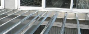

One objection that crops up with steel joists is their shiny look – it’s just not what people expect to see. Most customers end up being fine with it, particularly when I show them photos of steel decks with a nice fascia (Figure 1). Screw through the outer joists into the fascia from behind and even the fasteners become invisible. It is also possible to order the steel powder-coated, for looks and additional protection.
Figure 1. Once wrapped in finish material, lightweight steel-framed decks look pretty much like any other deck.

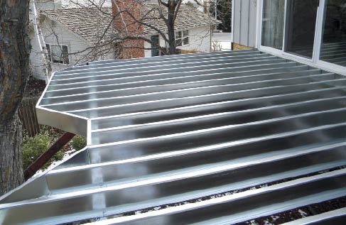

Start installation by attaching a ledger of track pretty much as you would a wood ledger (Figure 5). Flash the ledger just as you would a wood ledger, using bituminous membrane, vinyl, or galvanized steel flashing to avoid any corrosion problems. I fasten the ledger to the house with two 1/2-inch-by-21/2-inch lags every 16 inches.
Figure 5. Attach the steel ledger to the house as you would a wood one, with 1/2-inch lag bolts and standard flashing details.

In wetter climates, it might be a good idea to pitch the deck slightly away from the house to prevent water from collecting in the rolled edge of the flange, though that’s not a big issue in Colorado with our dry climate.
Next, I build and install the beam. The beam is built up from joist and track material (Figure 7), either as a single beam or a double beam, depending on the spans and loads. The single is one piece of joist and one piece of track screwed together every 12 inches; the double beam is two pieces of joist and two pieces of track, also screwed together on 12-inch centers. I cover the top of the beam with adhesive membrane to keep out water (Figure 8). Screws through the joist flanges will secure them to the beam.
Figure 7. Light-gauge steel beams are assembled by screwing together joists and tracks.
