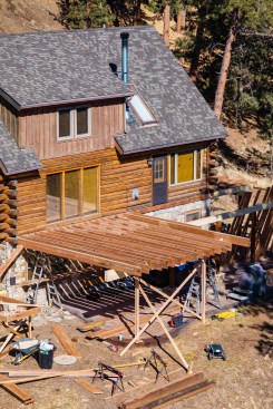

Site conditions also need scrutiny. Many of Moeller’s customers have mountain lots with granite and hard rock, sometimes requiring rebar embedded directly into stone; closer to town, shifting soil can call for helical piers instead of standard footings. These are expenses that need to be quantified ahead of time.
Moeller has also learned to check an existing deck’s attachment to the house before assuming how he can replace it. A deck tied into a cantilevered room, for example, may no longer be legal under current code, so the structural engineer will need to provide options. “That’s why we absolutely need to inspect the site and the current conditions,” he says.
