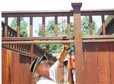

The spindle assembly on top of the fence came next. I juggled the spindle spacing so that a common spacing would work in all the post bays. And to hide slight discrepancies in the 8-foot post spacing, I didn’t place spindles against the posts.
I was able to get three spindles from a 3-foot-long PT baluster. I put a 15-degree cut on the spindle bottom to correspond with the bevel I made on the bottom spindle rail. After laying the cut spindles into a jig I’d made, I screwed them into the top rail (Figure 4).
Figure 4. The 2×2 spindles capping the fence are laid into the jig and screwed to the rails with 3-inch-long #7 trim-head screws. The tops of panels are predrilled and screws are started to make final assembly easier (top). Keeping the spindles away from the posts helps hide slight discrepancies in the panel caused by warped posts and varying panel sizes (bottom).
