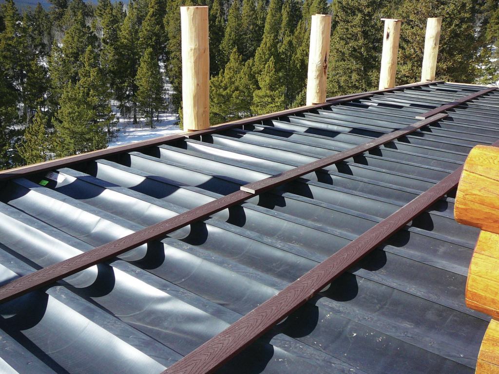

DEK Drain
Although DEK Drain comes in above- and below-joist varieties, a company rep told us that its Topside product accounts for 98% of sales. A flashing strip is installed at the ledger board, and a rubber membrane is draped over joists and sloped toward a gutter attached to the support beam. Four-inch-wide cap strips are installed over the membrane at each joist and serve as gaskets. The panels are temporarily fastened in place with ½-inch staples, then permanently secured by the deck boards. Cost is $5 to $6 per square foot. DEK Drain, 866.335.3724, dekdrain.com
