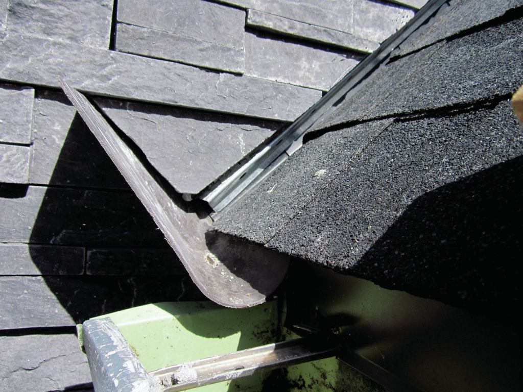

To do it right, we used a pre-formed kick-out flashing by DryFlekt at the base of the run.

Kickout flashings. Because ACMV is so intolerant of water, kickout flashings are crucial for avoiding moisture problems below roof-wall intersections. The kickout has to be sized to accommodate the thickness of the particular siding.
