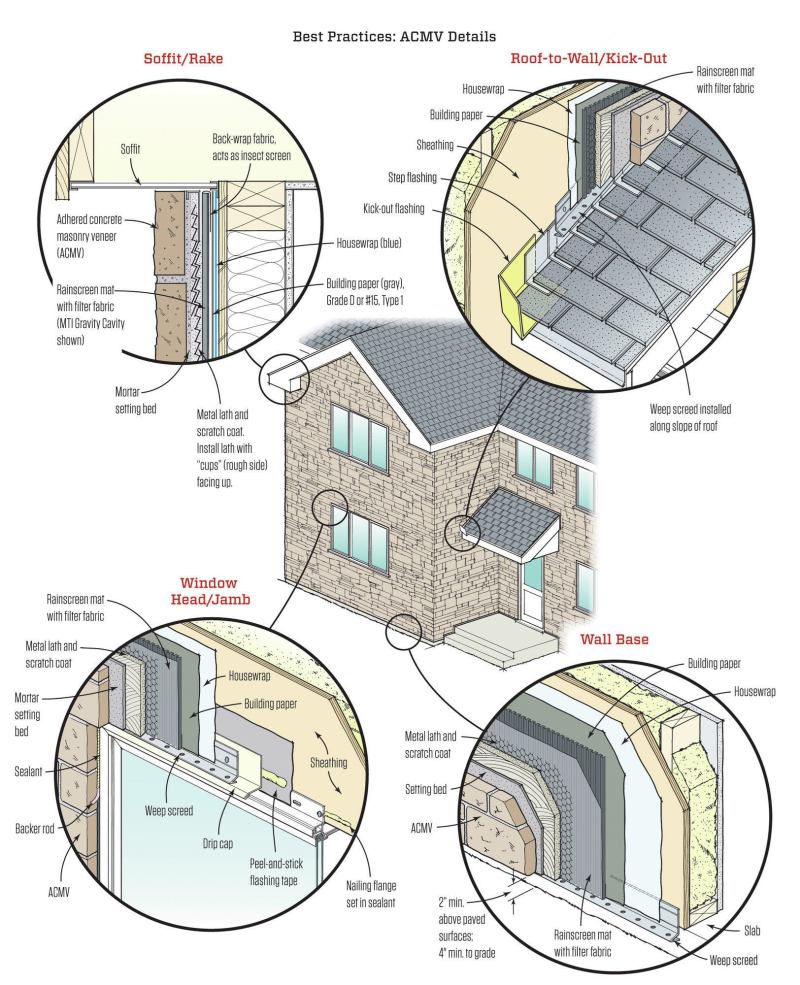

Drainable System
If you get anything from this article, let it be this: ACMV must drain. This is true of any cladding system, but with ACMV it’s especially important because all those chunks of concrete hold a lot of water. If that water can’t drain, it’s more likely to get sucked into the framed wall than it is to evaporate to the outside. Brick veneer works the same way, except that most builders know (and code demands) that there is a minimum 1-inch air space behind the veneer (although a 2-inch gap is recommended by the Brick Institute of America). While there can still be problems with this detail (namely from mortar droppings and squeeze-out that fills the space and creates numerous bridges for water to wick to the framing) for the most part the assembly works to allow moisture to drain to the outside from behind the brick. To create a drainable system, I always use a rainscreen material, such as Keene Driwall, which is shown in the photos for this job. Recently I have been using MTI Cavity Gravity, which was developed for brick walls but also works with EIFS and ACMV. It stays rigid, which makes applying the lath easier and helps to maintain an even thickness for the scratch coat.
A rainscreen material makes the whole wall very forgiving, so you can get away with holes, thin spots in the scratch coat, and other mishaps in the assembly that are bound to occur no matter how diligent you are when inspecting the work. But what you can’t skimp on is providing a place for the water to drain at the bottom. In fact, if you provide drainage but don’t allow it to exit, you can accelerate the water damage because a build-up of water will concentrate at the base of the walls.

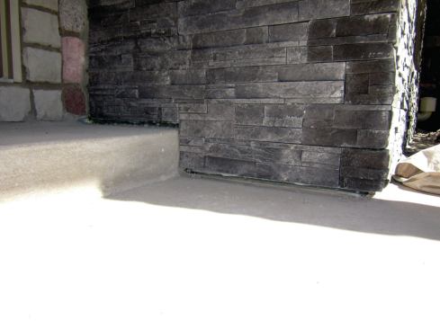

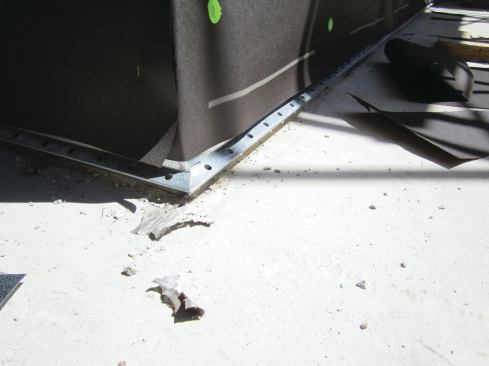

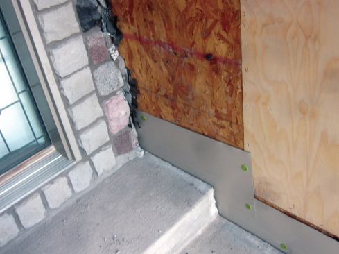

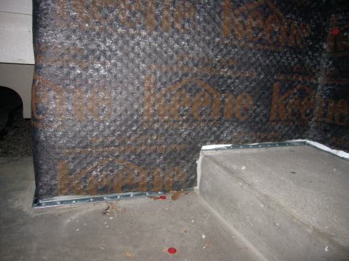

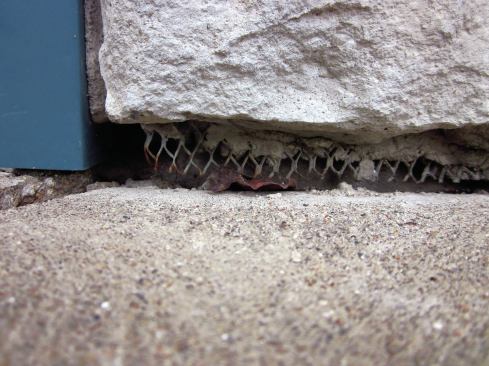

To ensure good drainage at the base of walls, we always apply a weep screed. This is the essential piece that will allow drain water to exit the cladding assembly. At the exterior steps on the house, we had to install aluminum flashing first to bridge over the sheathing transition. This flashing extends down the wall into the drainable subgrade beneath the steps and sidewalk. This gave us a clean surface against which to adhere the sealant after installing backer rod in the gap between the concrete steps and the flashing.
After installing the weep screed, we cover the walls with housewrap and building paper, and finally, install the rainscreen material. Lath and the scratch coat will go over the rainscreen mat, followed by mortar and stone.
I get a lot of flak from builders about specifying both housewrap and black paper, but it doesn’t cost that much more, especially if it prevents the high cost of a remediation. Without the rainscreen material, black paper would serve as an essential sacrificial layer over the housewrap, allowing water to drain between the two sheets. By itself, housewrap can form a capillary bond to mortar or when the two materials are pressed directly against each other. Either way, this can allow water to pass through the housewrap.
With a rainscreen material, this is less of an issue, but I like having black paper to slow solar vapor drive. Because ACMV holds a lot of water, it is prone to evaporation toward the inside when the sun is beating down on a wet wall. Housewraps are made to be permeable to promote drying, but that means moisture vapor can pass through them from outside to inside. The black paper will not prevent solar vapor drive, but it will slow it down. If we can slow down the wetting time, we have a better chance of avoiding problems.

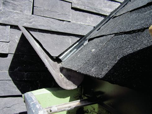

Roof-Wall Intersections

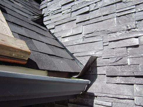

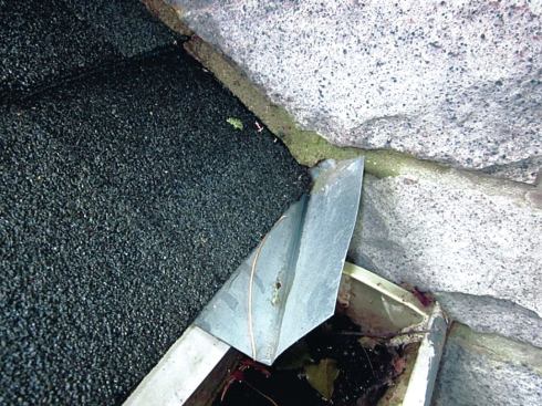

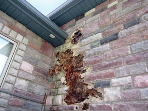

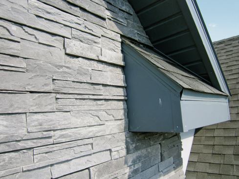

The intersection where a roof meets a wall turns out to be one of the most important details on the entire exterior. On this particular house, we found some attempt to install kick-out flashing above the gutters on roofs intersecting sidewalls. The kick-out shown had probably been installed after-the-fact, and it was much too little, much too late. You can see clearly the tragic result of having such a wimpy kick-out flashing.

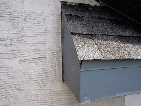

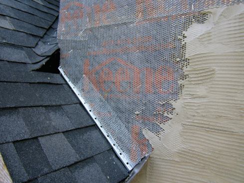

To do it right, we used a pre-formed kick-out flashing by DryFlekt at the base of the run. A steep roof, like the one shown in the photo, will require a sizable area to prevent spillover that would load the wall with water. The illustrations show in detail how this kick-out needs to be integrated with step flashing woven into the roof shingles.
Over the step flashing, we completed our assembly, installing a weep screed along the slope of the roof. (Technically, you should hold the weep screed 2 inches above the shingles. But this detail looks strange, so we bring it right down to the roofline and have never had problems.) The weep screed was followed by housewrap, black paper, rainscreen mat, and lath, all terminating to a weep screed at the roofline before applying the scratch coat.
Note the small cricket at the end of the valley above the kick-out. This is a variant of the kick-out and it performs the same critical task of diverting water away from the walls.
We have to constantly remind ourselves that ACMV absorbs and holds a lot of water, so we need to do everything possible to avoid loading the stone with water. Wide overhangs and meticulous detailing on gutters and valleys are critically important.

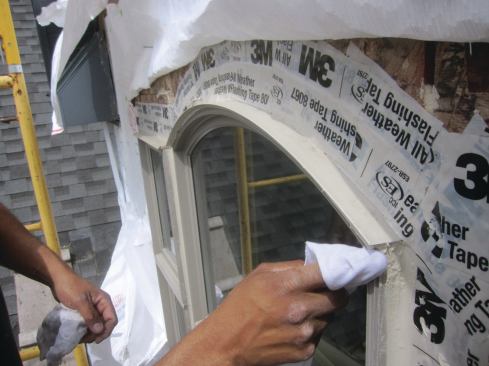

Windows and Doors

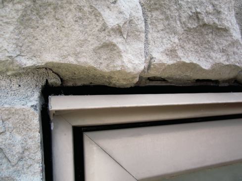

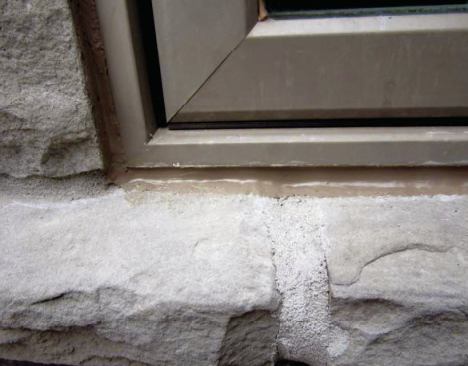

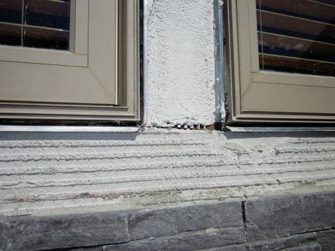

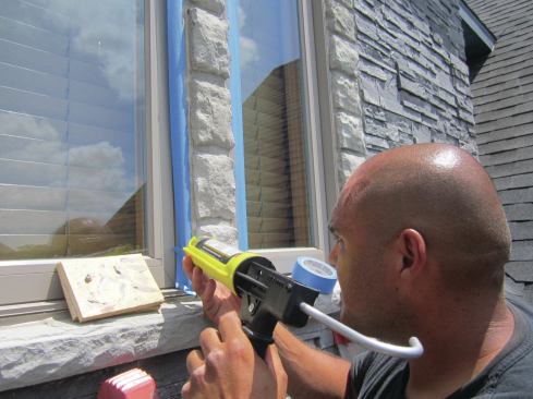

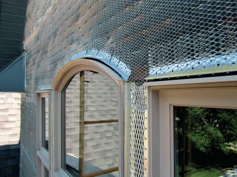

Around windows and doors, care needs to be taken to integrate flashing tape and housewrap. On the sides and bottom, the flashing should lap over the housewrap; but at the head, the housewrap should lap over the flashing. If we had installed the windows to begin with, we would have installed a drainable sill pan that lapped over the top of the housewrap below the window. But on a remediation job, we have to work with the existing window installation. In this case, I am not too concerned that the sill is taped off, because the weep holes in the window frame drain to the outside of the tape where the rainscreen mat will be. I’d rather make sure that the water streaming off the glass and flowing over the sill doesn’t seep into the wall along the top of the housewrap below the window. At the head we install a weep screed, followed by metal lath. Again, it’s critical that water be allowed to drain, otherwise it can collect, eventually seeping inside. Along window jambs and sills we install metal casing bead, spaced about 3/8-inch from the window flange.
After the stone gets installed, the gaps formed by the casing bead will be filled with backer rod and (after taping off the windows with blue painter’s tape) finished with a bead of sealant. When we peel off the blue tape, we get a joint with crisp edges. Though I like this detail, I’m not too concerned about these joints around the opening because the whole assembly behind it is drainable. This also applies to the gaps in the scratch coat, which I’d rather not have. But I do like having the flexible joint between the window frame and the stone to accommodate the thermal expansion of dissimilar materials. What usually happens is that the masons will simply fill the gap between the window and the stone with mortar, and the mortar cracks almost immediately. If nothing else, this looks bad. But usually the wall is not drainable, so the crack also allows for the speedy flow of water into the wall.

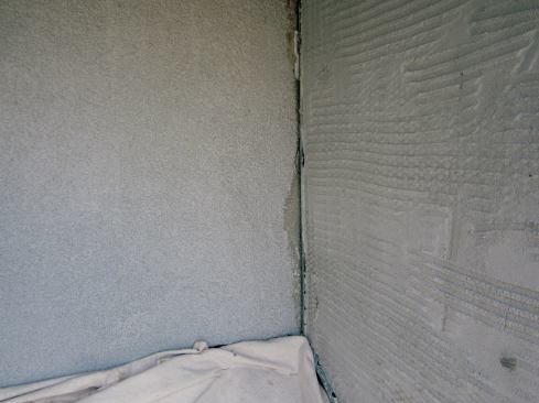

Inside corners
Nothing special has to happen where stone wraps around an inside wall corner. It is the same materials on each face of the wall, and there’s no reason for them to move at dissimilar rates. But on the inside corner, one wall will get stone and the other has EIFS.

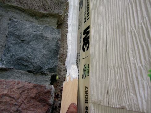

In this case we wanted a flexible joint to accommodate the potential for these two walls to move at different rates. We did this using the same detail we applied at the sides of window and door openings: installing a metal J-bead spaced about 3/8-inch from the corner. The gap then gets filled with backer rod and sealant before the stone is applied.

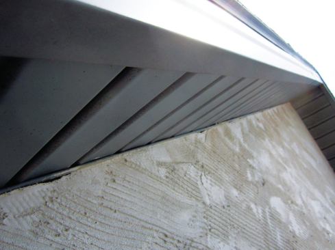

Top of Wall
At the top of walls, we can bring the rainscreen mat right to the J-bead supporting the soffit. Some experts would argue that the top edge should be finished off with a metal J-bead held away from the soffit and the gap sealed with backer rod and caulk. But I don’t think this joint will ever see much water, even along the rake. If anything, the top of the rainscreen should be allowed to vent, which it will through the inevitable gaps in the scratch coat and around the vinyl soffit bead, which is never installed too tight.
Rake Returns
A rake return, like the ones on the gable ends of this house, is a different animal. Here we have a vertical joint that will see its fair share of wind and rain. We use the standard detail for any vertical joint, and just like the one used around windows and doors: We install a J-bead with a gap that we finish off with backer rod and sealant before the stone is applied. Along the small section of roof above a rake return, we need a weep screed above the shingles.
By now you are probably getting a good idea of what works with ACMV: The assembly needs to be drainable using a rainscreen material over a well-detailed weather barrier. We believe in a two-layer weather resistive barrier to slow any vapor drive to the interior when you have a cladding material that stores a lot of water. All horizontal transitions need a weep screed to allow water to exit the assembly, and all vertical transitions between dissimilar materials need metal J-bead with a small gap so you can create a flexible joint by installing backer rod and sealant. If you follow these rules, you will have a fighting chance of avoiding expensive repairs.
