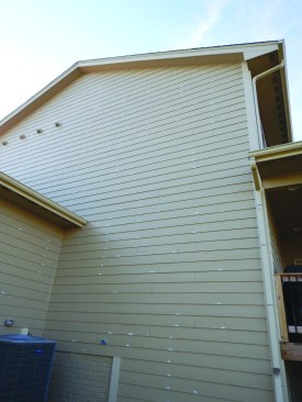

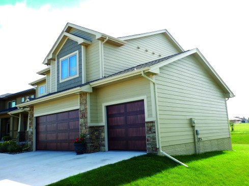

I see a lot of failed siding jobs. The one shown in the photos in this article is typical of the fiber-cement siding jobs I am asked to look at—I could go out right now to hundreds of homes that are in a similar condition. Each one usually looks fine from a distance, but when I examine the house up close, I see the same installation errors again and again. For some of the jobs, I am called out to investigate because they have gone to litigation. For others, it’s a homeowner complaint. But almost all of them are very expensive to repair.
On this house, the siding had been so haphazardly nailed on and the fiber-cement boards so poorly attached that wind caused the siding to vibrate. This vibration transferred through the framing, creating a loud hum when the wind blew that kept the homeowners awake at night. As it turned out, there were problems beyond the inadequate nailing—none of the detailing designed to protect the walls from water had been done correctly. If the siding didn’t fall off first, leaks would eventually wreak havoc on the interior.

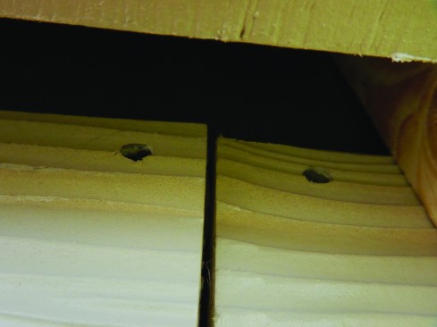

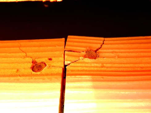

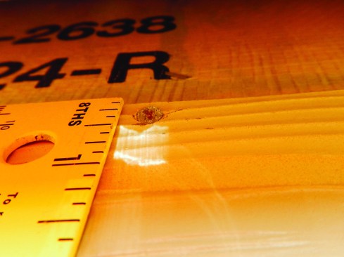

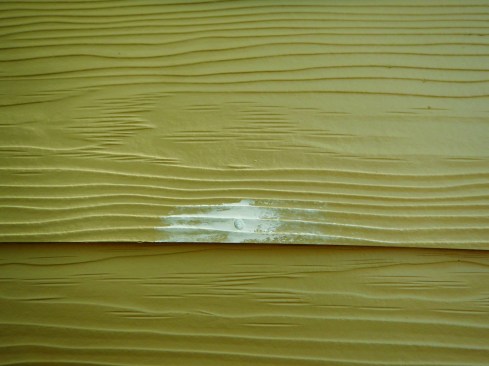

The material used here was MaxTile’s MaxiPlank; and according to its ESR, exposed fasteners (face nails) must be placed at least 3/4 inch up from the bottom edge. Mostly, this job had been blind-nailed to begin with, but the installers had occasionally placed face nails to hold boards down, and these were only about 3/8 inch from the bottom edge. At least the nail shown here had been set more or less flush to the surface, whereas all the face nails the builder had retrofit not only were too close to the bottom edge, but also had been overdriven—and the divots had been filled with spackle.

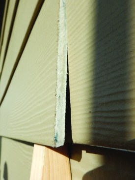

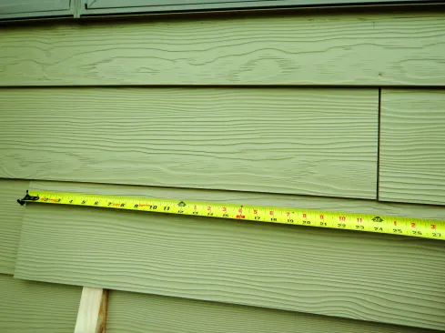

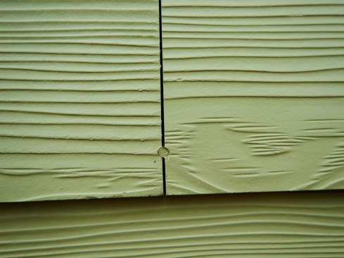

In my initial report, I documented a number of other nailing problems. For starters, the ESR is clear about placement for exposed fasteners at butt joints: Butt joints must be located over studs (or a metal plate must be used for butt joints between studs, but none were in evidence on this job), and the nails placed 3/4 inch up from the bottom edge and 3/8 inch from the ends.
On this job, however, the butt joints were not located over the studs. The house was framed on 16-inch centers, while many of the butt joints were offset by 24 inches.

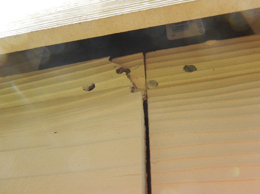

At the butt joints, the builder had initially made an attempt to hold the ends down with a single nail strategically placed to hold both ends—an incorrect detail that I see all the time. I have also seen installers try to pin the ends down. Neither solution will provide enough holding power to secure the siding.
For blind nailing, the ESR specifies that fasteners must be placed a minimum of 1 inch down from the top edge of the board, and a minimum of 3/8 inch from the ends. My inspection showed that a majority of the nails were much closer to the top edge and many were overdriven.
The reason for requiring a minimum distance from board edges and ends is clear: When a fastener is placed too close to an edge, the material tends to break around the fastener when boards expand and contract with changes in temperature, or when wind forces push and pull on the material. The vibration caused by loose boards fluttering in the wind no doubt accelerated this failure and is why so many of the fasteners on this job had completely failed.

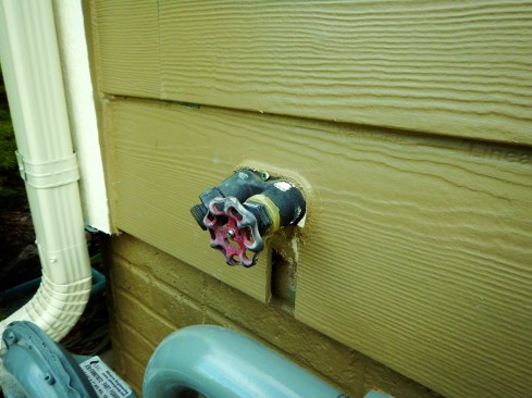

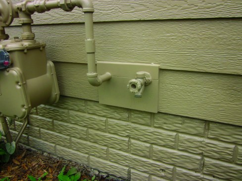

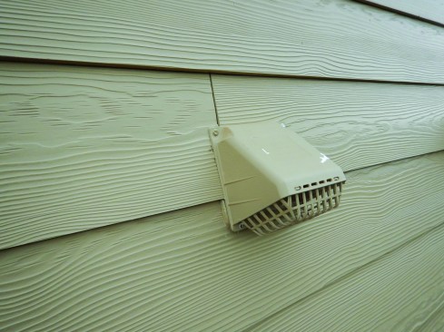

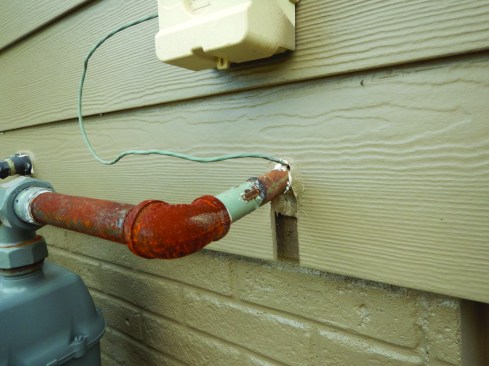

There were a number of egregious water-detailing problems too. One of the worst was a siding break made directly above a dryer vent. Water leaking through this joint hit the vent pipe and followed it to the interior, where, not surprisingly, we found water marks. At all the other penetrations—at the gas line near the meter and the hose bib—the siding had simply been slotted around the pipe or vent, which not only looks bad, but also leaves the wall open to serious water and air leaks.
The correct way to detail an existing pipe or vent penetration is to use a split mounting block. When one of these is used, a hole saw is centered along the split, and half the block is slid over, and the other half under, the pipe or vent. The split, which is beveled so it drains downward, is tightly sealed with caulk.
Butt joints. Fiber cement won’t rot, but it is not completely impervious to water. It can absorb water at ends and edges, and swell. This not only looks bad initially, but the movement of swelling and drying and freezing and thawing will gradually cause the material to deteriorate at vulnerable edges.

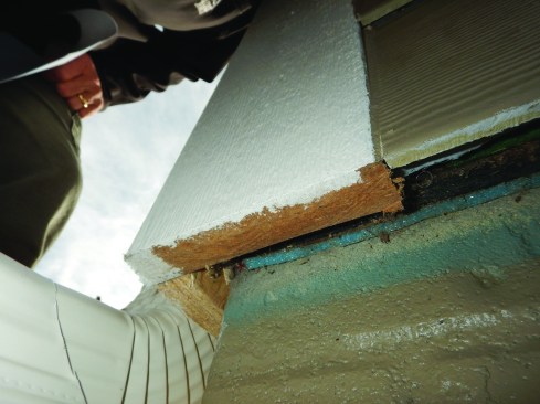

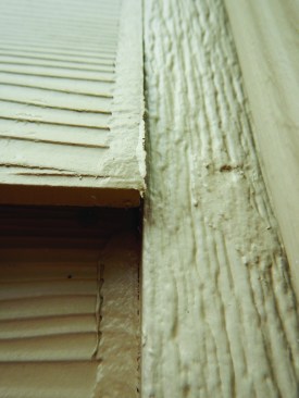

It’s critical that board ends butting against window and door openings, or against corner boards, be cut at least 1/8 inch short to accommodate expansion. On this job, the boards were frequently butted hard against the trim. This left no room for the material to expand, and it also created an inferior caulk fillet that failed quickly and allowed water to seep into the joint when the siding boards contracted.
Cut edges. The installers on this job also failed to prime the cut ends of siding and trim boards, as specified in the manufacturer’s instructions to protect the material from water. This is particularly important for exposed edges at the base of the wall. Water running down the face of the wall can turn under that lower edge, and splash-back will further wet this area.

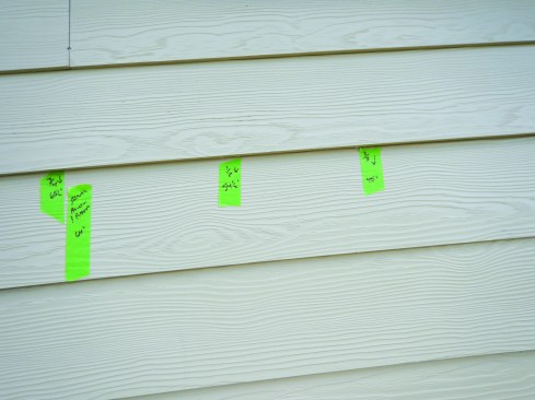

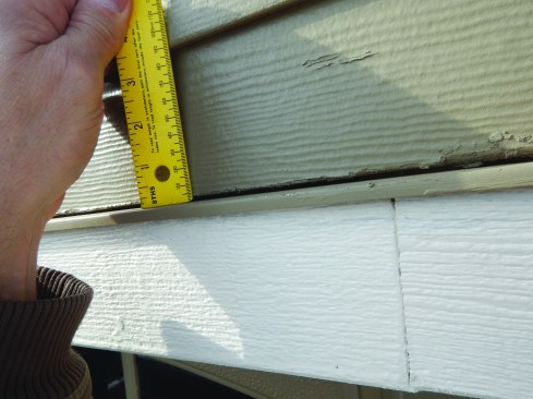

Clearances. All fiber-cement manufacturers specify minimum clearances where siding hits a horizontal surface. This can include horizontal trim, such as above the head trim on an opening, above the mounting block for exterior penetrations, or where the siding lands on the top edge of water table. At least 1/4 inch is required, and this gap should remain uncaulked. However, the installers on this job left only about 1/8 inch above the window heads.

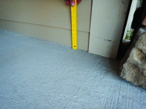

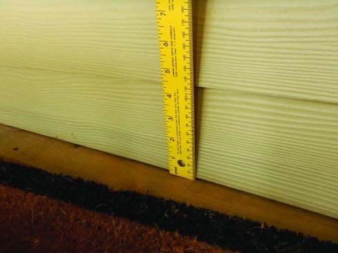

The clearance between the siding and a deck, porch, or hardscape surface, or along the rake of a roof, is much greater. For MaxiPlank, this clearance is supposed to be at least 1 inch to 2 inches. (But Hardie, for example, requires at least 2 inches in our climate zone. Don’t assume all fiber-cement details are the same.) On this job, the installers brought the siding right down to the porch floor and to the sidewalks.

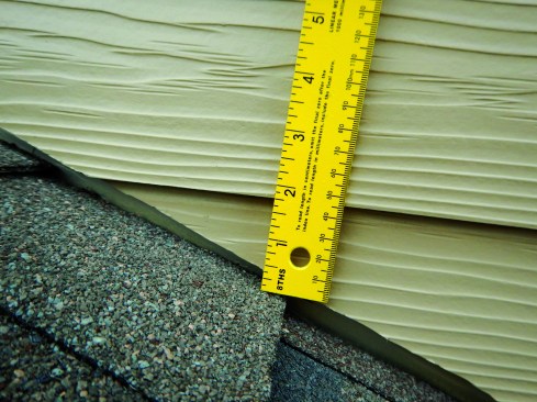

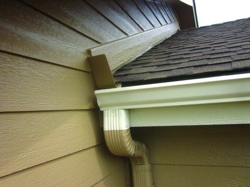

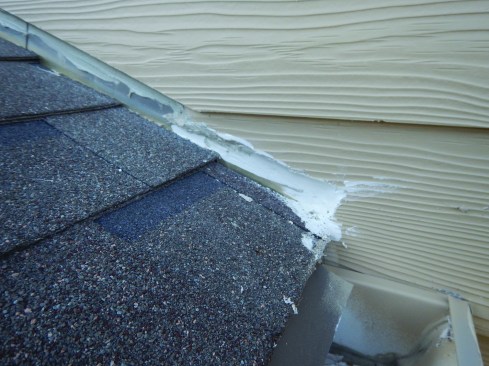

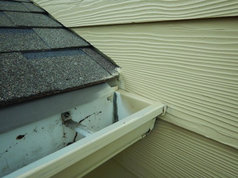

Sidewalls. The installers also brought the siding down onto the roof surface where sidewalls intersected a roof. And they left out any kind of kick-out flashing where the bottom edge intersected with the wall. When this was called out on my initial report, they cut back the siding and smeared a lot of caulk into the corner in lieu of a kick-out flashing.
A true kick-out flashing, as shown in this photo of one of my siding jobs, is a large flashing that gathers water and directs it into the gutter. Note, too, how I detail the rake: I run a trim board along the rake, keeping this the required distance above the roof surface, and bring my siding board down to the trim, maintaining a 1/4-inch gap that gets caulked. Details like this let me stay profitable and allow me to sleep at night.
