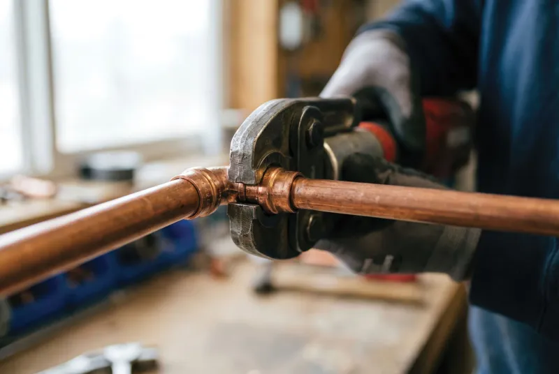

A quick description for those who aren’t familiar with the tool: A press tool hydraulically compresses a ring within specialized fittings onto the pipe. The jaws of the tool are first lined up over the part of the fitting that contains the rubber compression ring. When the tool is activated, the jaws close completely around the ring and squeeze it until the tool reaches its maximum pressure. The tool then releases, resulting in a secure leak-proof joint that requires less time and skill than threading or soldering. Fittings match common pipe connections, such as shutoffs, elbows, and conversion joints.
There are manual versions of the tool but the one I got was the Milwaukee cordless Force Logic. It works both with brand-name fittings (like ProPress) and the generic press fittings that you see at the box stores. There are also different-sized press jaws that can be switched out on the tool to let you work on various pipe diameters. The tool is most often used to get a fitting onto copper pipes but can be used on other materials, such as black iron, stainless steel, and PEX.

The advantages for me have been, first off, no fire. Not having to solder with an open flame in old homes, often in tight spaces, is huge. I am okay at soldering, but it is not something I do every day, whereas pressing a leak-proof fitting on a pipe does not take much practice.
The speed with which the fittings can be installed helps me work efficiently, but the biggest plus is I can get an end cap or shutoff valve installed even if the pipe still has water in it. Often, closing the old main water shutoff would still allow a trickle of water through. Or, I wouldn’t be able to get the system to drain well enough and there would still be water, preventing me from soldering a fitting on. Not having to worry about completely drained pipes saved me many times and let the work proceed quickly.
In the homes I work on, we are usually connecting to original copper and then switching to a plastic tubing like PEX (for cost reasons). The flexibility of being able to choose materials is great. I have also ended up using the tool for boiler pipes: They are often the hardest to get all the water out of, but now I can isolate the area temporarily with a shutoff valve and move on with the work and reconnect later.
