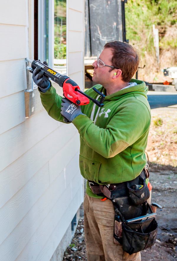

Here is how the gun looks when configured for 10-ounce tubes. It can be purchased this way (model 2441) or adapted by changing out the drive rod and carrier. The gun is said to be able to dispense up to 150 10-ounce tubes per charge. The actual number would depend on the temperature and the type of material you're dispensing.

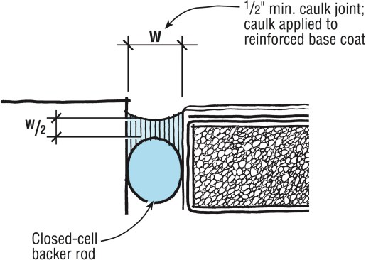

Shape
Ideally, caulk joints should be configured to span a gap that is half as deep as it is wide (below). The caulk should not bond to the back (three-sided bonding), but only to two sides, so it can flex as it expands and contracts.
A good caulk joint should bond to only two sides, not to the back. Use backer rod to control the depth, which should be half the width of the joint.
Corner fillets do not move freely and generally peel off the two surfaces. If a joint depends on a caulk sealant, open it up slightly to allow caulk to fill the gap. If a corner is tight, don’t caulk it; the caulk will fail faster than any finish applied to it and will only complicate refinishing.
Backer Rod
Backer rod should be used to fill large gaps and control the depth (Proper Joint Design, above). Most backer rod today is made out of foam and comes in diameters from 1/4 in. to 2 in. and up. Choose a backer rod that’s just a little larger than the joint so it will stay in place and allow you to control the depth of the sealant.
Foam backer rod comes in open-cell and closed-cell form. Open-cell backer rod compresses more and is easier to work with, but it’s like a sponge and can absorb water. In critical areas that may absorb moisture from the substrate, use a closed-cell material.
Bond-breaker tape. The main purpose of backer rod is to keep sealant off the back of the joint, thus preventing three-sided bonding. If the joint is too shallow to fit backer rod, apply bond-breaker tape to the back of the joint.
