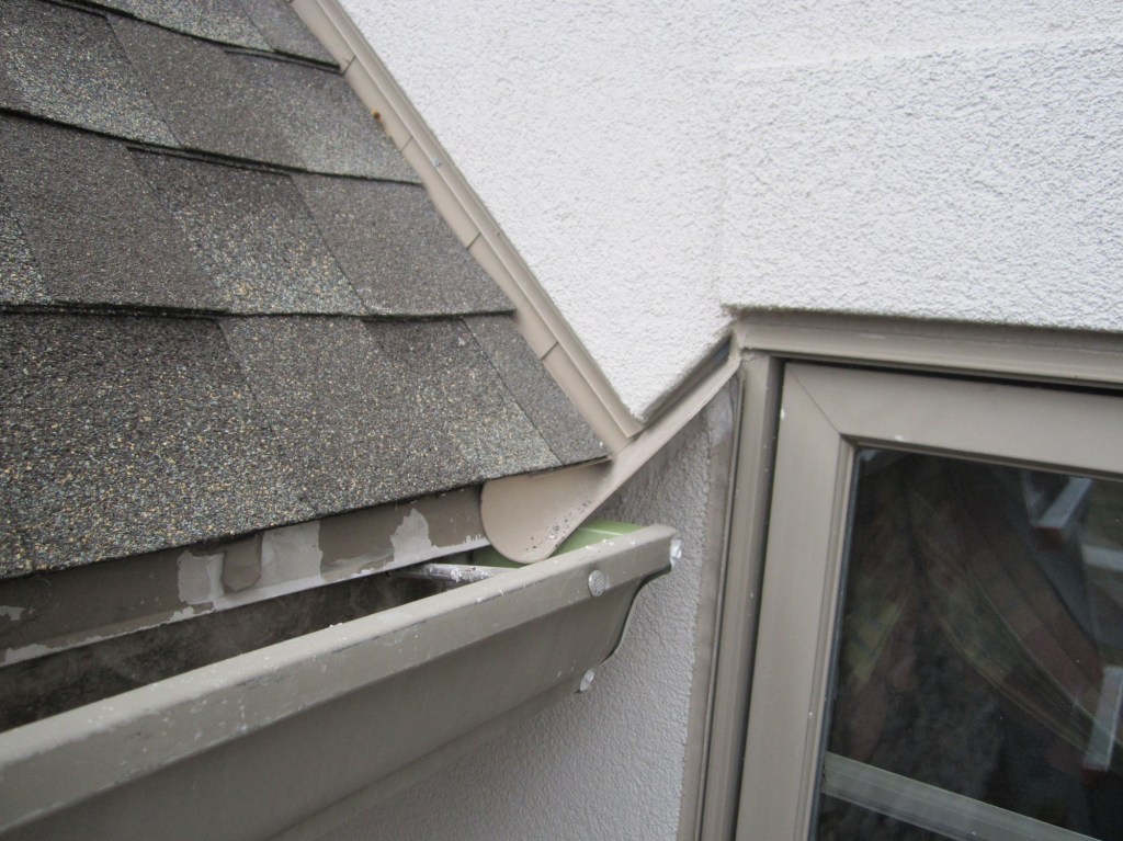

The photo above shows a correctly detailed kickout on an EIFS stucco exterior. This kickout is particularly important because it terminates directly at a window opening—a fairly common occurrence, but one that can be especially devastating: If the kickout is wrong, chances are high that the window flashing is worse, and there is little hope of keeping water out of the wall. Water can quickly find its way to interior finishes, leading to extensive mold—problems that carry enormous liability and a higher price tag. It would be so much easier and less expensive to invest in $15 worth of flashing to begin with.

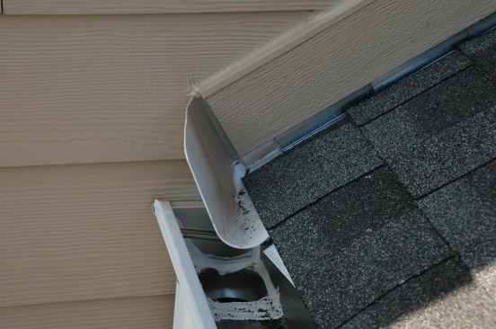

The details are essentially the same for all cladding types. The process starts with a large, one-piece kickout flashing with a return that is big enough to prevent run-off from overflowing the top. We typically use ones made by DryFlekt. Unlike with a site-made metal kickout, you don’t need to worry about making bends, and the flashing won’t corrode. The ones from DryFlekt are made of a thermoplastic polyolefin, or TPO, which is pretty good at resisting UV degradation and stands up well to a wide range of temperatures, so it’s unlikely to become brittle and crack. We have put in hundreds of these over the last decade and have never had a problem.
A pre-made, one-piece TPO kickout, like this one from DryFlekt, is large enough to deflect roof runoff into the (yet-to-be-installed) gutter.

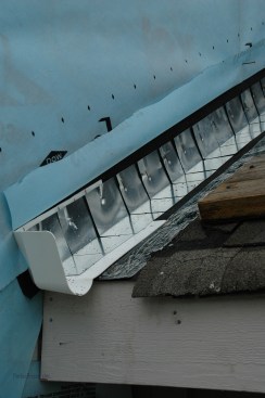

We usually begin by installing a piece of peel-and-stick flashing, folding it into the corner between the roof and the wall. The kickout goes in next, followed by standard step flashings. The job shown at left is typical for a reroof, where we cut in and begin detailing the intersections first. The roofer, of course, will come along later and slide new shingles between the steps. And the WRB will be folded down.
With horizontal siding, the author installs a trim board along the  rake, keeping it a minimum of 1 inch above the roofing.

We bed the edge of the WRB in a thick bead of sealant, and then bring the siding down, keeping it above the finish roofing. Consult the manufacturer’s installation instruction for the distance here. Often 1 inch is the required minimum but we generally hold it up about 2 inches. For stucco, stone, or masonry veneer, we terminate the cladding with a weep screed held off the roof 1 to 2 inches. For horizontal siding, we typically install a trim board along the rake, which will simplify future reroofs (see photo at right). This board has a simple aluminum Z-flashing along the top edge to protect the exposed edge of the trim board and can be applied directly over the WRB, because any water that gets behind the WRB will drain out onto the step flashing.
