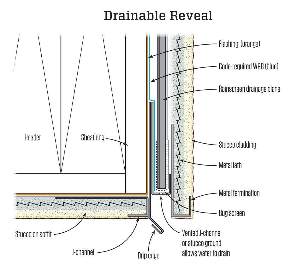

One solution that works on cantilevered areas is to build a drainable reveal.
Stucco buckets. One distinct and especially thorny problem Ms. Williamson points out is a problem we earlier dubbed "stucco buckets" - overhangs where stucco wraps from the vertical wall to the horizontal surface without anywhere for liquid water to drain out (see "Avoiding Stucco Buckets"; Nov/18).
One solution is a drainable reveal, with variations that work for stucco (shown left), as well as thin brick. Another option described in "Avoiding Stucco Buckets" is to divert the water with a channel that drains the water away from the bucket (the closed cladding above an opening).
