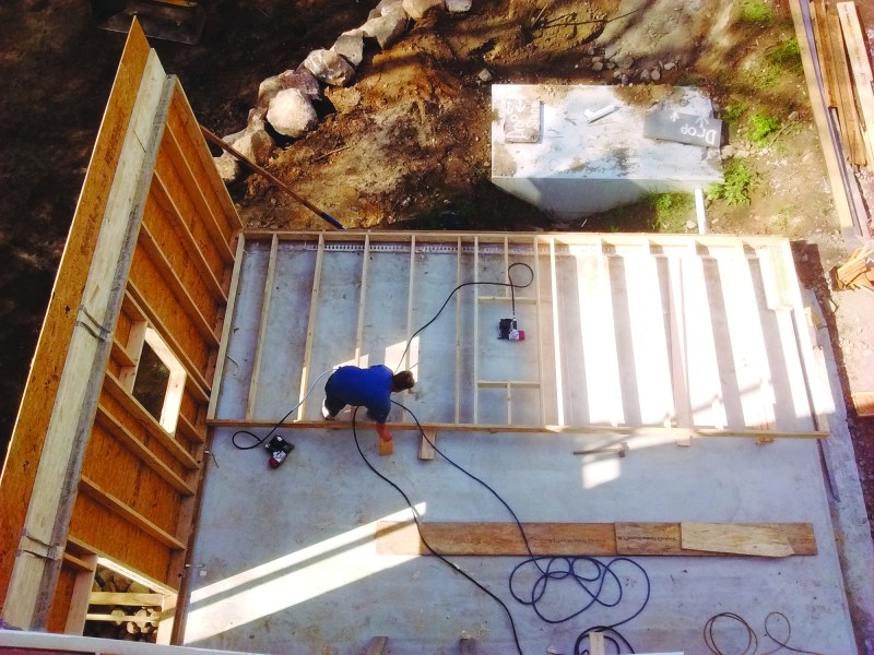

Same openings—different treatments. The openings in the upright wall use a rimboard header, while the nonbearing gable end wall on the slab doesn’t need a header.

Do You Even Need A Header?
For several code cycles, there has been a subsection for nonbearing walls (2018 IRC R602.7.4). It says: “Load-bearing headers are not required in interior or exterior nonbearing walls. A single flat 2-inch by 4-inch member shall be permitted … for openings up to 8 feet in width.” There is a limitation that the space between the flat head board and the bottom of the top plate can’t exceed 24 inches.
So we don’t need a structural header unless the walls bear the ends of floor joists, roof rafters, trusses, or a concentrated load. And in most cases, you don’t even need to install cripples or blocking between the top plate and the flat rough-opening head board. Besides eliminating the header, you can also skip structural jack studs because there is no load for them to bear, saving even more lumber.

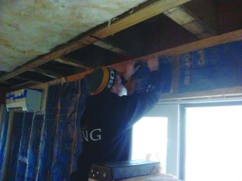

Rim-Board Headers
When our company was looking into ways of increasing the efficiency of our framing, we wondered why we needed to frame a header into the wall when we potentially had a header above the top plate in the form of a rim board (see photos, below). Often, the rim board can bridge a window or door span, provided you follow a couple of code requirements. Subsection R602.7.2 and companion figure R602.7.2 in the 2015 and 2018 IRC illustrate requirements for creating a rim-board header (see illustration, above).
Rim-board headers are sized according to the same span table used to size regular headers, so they can be single ply, double ply, or more. There can be no joints in a rim-board header anywhere over the opening or within 6 inches beyond the outer bearing stud.
Minimizing the size of headers means increased insulation in the wall. A rim-joist header allows full-depth wall insulation in the spaces above a door opening, where there would have been solid lumber years ago.

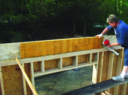

Box headers. In certain situations, sheathing attached with a strict nailing schedule can be combined with a framed opening to create a box header. Box headers can be 9 or 15 inches tall, and the structural sheathing can be on one side or both sides. A separate span table is included for single-sided and double-sided box headers.
Excerpted, with enhanced illustration, from the 2018 International Residential Code; Copyright 2017 Washington, D.C.: International Code Council. Reproduced with permission. All rights reserved. www.ICCSAFE.org
Box Headers
A box header is made by installing a structural panel on the outside face of the framing (for a one-sided box header) or on the inside and outside faces of the framing (for a two-sided box header). The panels span between the top plate of a wall and a flat 2-by at the head of a rough opening. When nailed according to the code schedule, the sheathing and framing work together as a header, eliminating the need for a lumber header. Box headers use a minimal amount of lumber, so there is more space for insulation. You just need to follow the conditions outlined in figure R602.7.3 (see illustration, above).
To create a box header, first frame in the cripple studs between the top plate and a flat 2-by at the head of the rough opening with jack studs supporting the ends of the flat 2-by head. Make sure that the structural sheathing and the top plate continue through the opening with no joints. Follow the fastening schedule of 8d common nails spaced 3 inches apart and driven into the plates and cripples. The sheathing must be a nominal 1/2 inch thick, and the strength axis must run parallel to the wall length. If you are already framing with structural sheathing, then single-sided box headers are easy to incorporate. And even if you typically sheathe walls with 7/16-inch panels, you can substitute 15/32-inch sheathing where needed. The tiny difference in thickness shouldn’t cause any problems.
The code lists opening spans for 9- and 15-inch-tall box headers. But box headers can’t be used in all situations. They’re allowed only for walls that support just a roof and ceiling, or for walls supporting a roof, ceiling, and a floor with an interior center bearing wall. In many cases, the exterior wall sheathing alone can span an opening for a single-sided box header. Take the example of a first-floor 3-foot 2-inch header in a two-story 26-foot-wide house with a center bearing wall. A single-ply 9-inch-tall box header is good for up to a 4-foot span, and a 15-inch-tall box header works for spans up to 5 feet.
Two-sided box headers offer greater spans, but they throw a wrinkle into the fabrication. If you apply an interior structural panel to the face of the studs, you will need to pad out all the studs to match the plane of the panel before installing drywall. If you’re framing walls with 2x6s, another option is ripping 1/2 inch off the plate, tops of the king studs, and the head board. All that finicky detail is probably more work than the benefit gained from getting a wider span.
