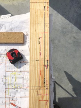

To keep track of all the details and ultimately ensure a successful execution, we make extensive use of story poles in the layout process. Everything from elevations to the sizes of posts and beams and how they connect with the wood framing can be accurately tracked on a story pole.
Working from a set of plans that he has already marked up, the author lays out the steel work for each location in full scale on a story pole.

Story poles. In the field, the marked-up plans make it easier to accurately lay out where everything goes, whether I’m marking up the foundation or the top of a framed wall. The project shown in this article included a poured concrete slab in a crawlspace foundation (see “High-Performance Crawlspace Foundation,” Sept/20) and numerous steel columns located on either the foundation wall or the slab floor, with several columns extending to the roofline.
Rather than attach the steel columns directly to the footings and bury them between block work, or attach them to footing pads below the concrete slab, we decided to elevate the steel attachment points. We did this by reinforcing the CMU walls with additional rebar and grout wherever there was an attachment point and by forming a reinforced concrete “pedestal” above slab height on the interior of the foundation for each interior column. This way, if any of the steel columns needed adjustment later for plumb, they wouldn’t be buried under the concrete.
Knowing how critical it was to have all the steel placements work out with the framing, we brought our framer on-site shortly after footings were poured and the CMU work was just underway. Working together on the layout gave us confidence that our steel column locations were accurate.
Using the top of the CMU wall as our benchmark elevation, I created story poles for each location with all the framing elements laid out to scale. On this project, we started with the house’s main steel columns, which were located in the great room. To match the overall height of the house, which was about 30 feet, we scabbed together several long 2x8s to create the story poles.

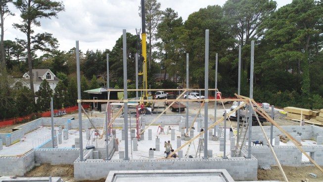

Steel Columns

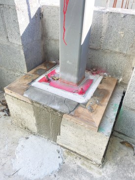

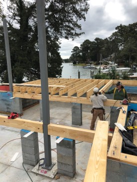

We had provided the steel fabricator with plywood templates for each column location that indicated the exact positions of the threaded bolts that hold the columns in place, so there were no surprises when erecting the steel. But we still needed to fine-tune their height and make sure they were plumb. One way to do this is by using a pair of nuts on each bolt with the flange sandwiched between them and tightening or loosening the lower nuts at each corner of the mounting flange to adjust the position of the column. In our case, the fabricator supplied us with bars of steel stock in different thicknesses to be used as shims as needed between the flange and the pier. In both methods, after the column is locked into place, the gap between the flange and the pier is filled with non-shrinking grout.
The steel columns were shimmed to final elevation with steel shims and grouted later with non-shrinking grout.

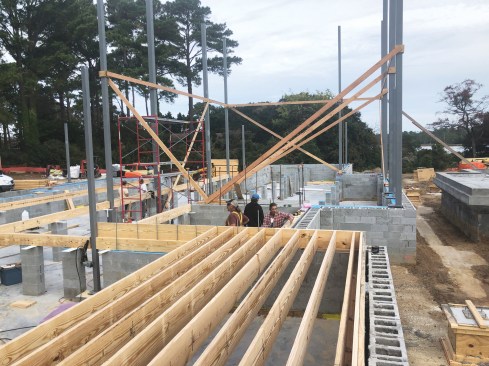

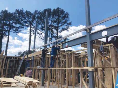

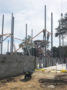

To stabilize the steel columns after they were erected, the framing crew locked them in place with 2-by braces fastened to 2-by collars clamped around each column.
Once the first round of columns was erected, our framer devised a simple solution for bracing the free-standing steel. While the fabricator assured us that the base plate bolts would hold the 30-foot-tall columns in place while we worked on the framing, we didn’t want to end up with a bunch of fallen steel if a coastal storm swooped through. To connect the tall columns to each other with simple 2-by bracing, he assembled slightly undersized sawn-lumber “clamps” that snugged up tightly around the steel when the screws holding them together were tightened. Then the braces could be fastened to the wood clamps with structural screws, tying the assembly together.

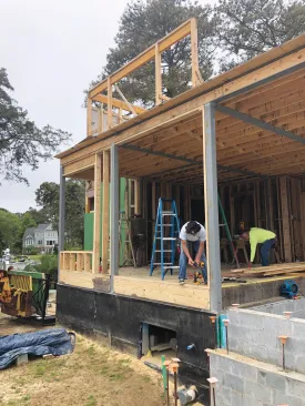

The framing crew worked on the large house one section at a time, so that the steel columns for one area were delivered and installed while the steel supplier fabricated the columns for the next area.
In the main part of the house, we commenced with framing the traditional “box” floor system, though at each column location, the mudsill and rim joists were interrupted. After setting all the sawn-lumber joists and laying down the subfloor, we were able to mark out the first-floor walls, which confirmed that our meticulous foundation layout was correct.
Once the steel columns were in place, the framing crew began installing the sawn-lumber floor system (left). In some places, the framing had to be notched to fit around the steel (above).

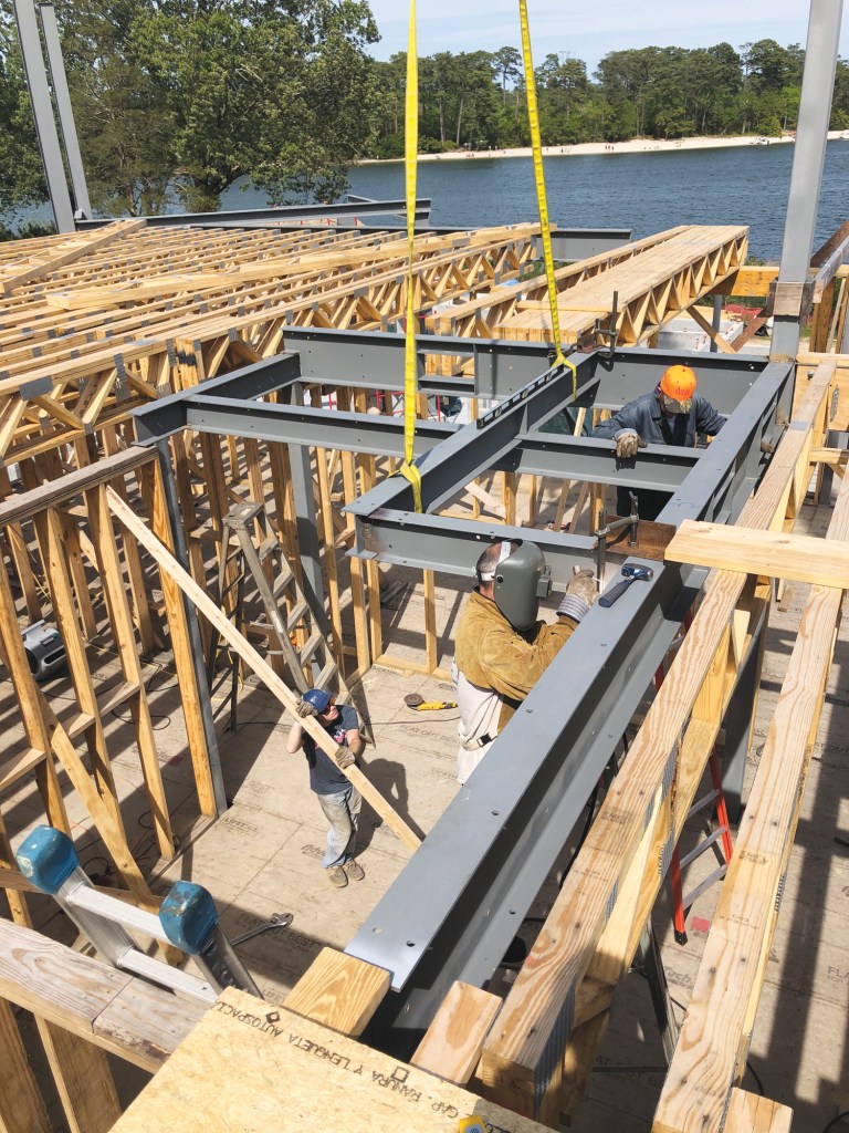

Beams

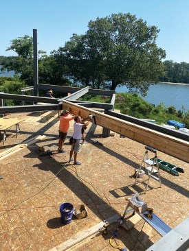

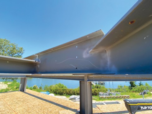

The next step was to take the measurements for the horizontal beams that were part of the second-floor joist system. We took all the measurements at floor level because that was the most accurate place to measure from. Despite popular belief, steel is not always straight, and any measurements taken higher up on the columns had the potential to be off.

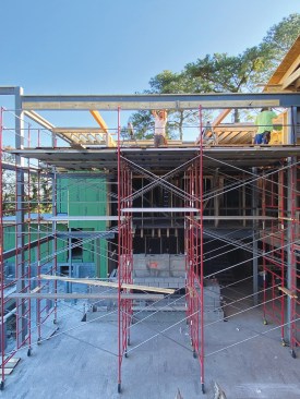

Scaffolding. In some parts of the house, we would be installing horizontal steel more than 16 feet above ground level. To safely and efficiently install the beams for the master suite, which was located partly over a future crawlspace for the outdoor living area, we assembled extensive temporary scaffolding. Where we had a level first-floor system in place, we assembled staging, with wheels on the lowest sections so we could move the staging around as needed. Not only did this allow us to be at the proper height to take accurate measurements and make templates for some of the more complicated steel intersections, it also allowed us to install all the steel and truss joists comfortably and safely from the same scaffold.
The framing crew erected an extensive temporary scaffolding system over a future outdoor living pavilion to install the complex steel framing for the master suite.

Templates. As this area came together, there were several locations where we needed to make templates for the steel fabricator because of how certain beams intersected with other beams. Some had flanges notched into webs, while others had some 45 degree angles notching over other beams. Some of these adjustments could be made in the field, but some of the beam intersections were so complex that our framer carefully assembled plywood templates for the fabricator’s reference.
Rather than attempting to cut and fit complex steel beam connections in the field, the framing crew mocked up plywood templates.
On the templates, the crew recorded lengths, notch sizes, and other critical dimensions.
As we progressed to the rooflines, we needed to keep several more beams at the top of this space under rafter-bearing height and above soffit height. The clearances were tight, but our careful planning paid off and everything came together nicely.
The templates were supplied to the steel fabricator, which could then accurately prefabricate beams that could be welded into place with few modifications.

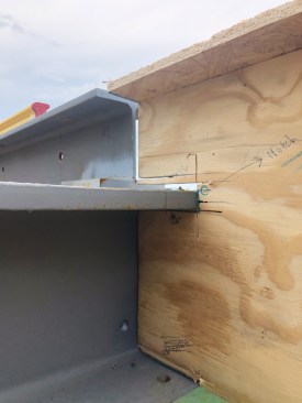

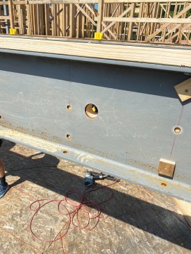

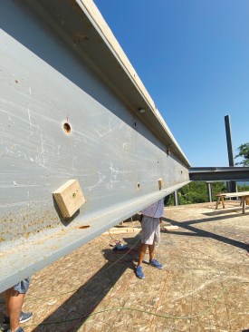

Packing out. Almost all the beams needed to be packed out with sawn lumber to connect to the wood-framed joist systems. The process of packing out a steel beam is—not surprisingly—time consuming. On this job, the structural plans called for using 5/8-inch-diameter carriage bolts 16 inches on-center at staggered locations to fasten the sawn lumber to the steel. While the steel fabricator had drilled the necessary 11/16-inch-diameter holes in the beams, it’s still challenging to hold a 2×10 or 2×12 in place against the web of a beam while someone else safely drills the holes out for the bolts from the other side.

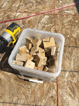

To quickly clamp the 2-by material to a beam for safe, hands-free drilling, our framers cut some 3-inch-square scraps of plywood to make what they called screw blocks. They drove wood screws through these screw blocks and through three or four holes in the steel beam into the back of the 2-by to hold it in place, then the remaining holes were drilled out with an 11/16-inch-diameter bit to match the holes in the steel. Once the holes are drilled, we can then push a few bolts through some of them and thread on nuts to hold the 2-by in place while the screw blocks are removed and the remaining holes drilled out.
Steel beams have to be packed out to adapt them to conventional wood framing. The crew started by cutting 3-inch-square plywood blocks and driving screws part way through the center of the blocks.
As the screws are then driven through bolt holes in the web of the beam and into the back of 2-by stock sized to fit the flange, the plywood blocks act as washers that hold the 2-by packing in place.
Holding the 2-by packing firmly in place with the plywood screw blocks allows holes for bolts and other penetrations to be safely and accurately drilled out (left). The top plates are held in place by 1/2-inch diameter lag screws driven up through holes in the flange, and so had to be installed before completing the beam pack-out.
Most of the time, both sides of a beam needed to be packed out, and the process is basically the same—run screw blocks through to hold the new 2-by in place, then drill it out. After both sides are prepped, the through bolts can be installed and tightened as the screw blocks are removed.
Sometimes, we were able to pack out the beam with only one 2-by member on each side of the web, because the sawn or engineered joists were narrower than the distance between the upper and lower flanges. However, any time we were attaching truss joists, the beam had to be packed out flush, which required some creativity to achieve the desired thickness. We realized quickly we would need numerous sizes of CDX plywood on-site and made sure to have four or five sheets each of 1/4-inch through 3/4-inch plywood to be able to rip up what we needed.
Where the beams needed plates, we drove 1 1/2-inch-long by 1/2-inch-diameter lag screws through holes that the steel fabricator had made in the flanges into the bottom of 2-by stock sized to match the width of the flange. On vertical posts, we fastened wood members to the steel using Reamer Tek self-tapping wood-to-steel screws.

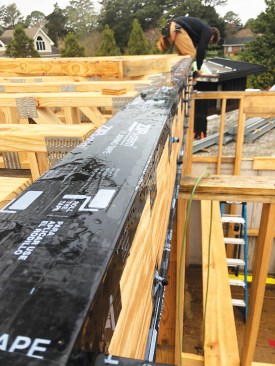

Because this job would be exposed to weather for a long time before dry-in, we opted to wrap the tops of the packed-out beams with Zip tape to help keep water out of the assembly and prevent the lumber from swelling and thus shifting any joists around.
Where truss joists would be hung with joist hangers from the beam, additional layers of 2-by material and plywood were added as needed so that the packing would be flush with the steel beam's top and bottom flanges.
To protect the packed out beams from water during the construction process, workers wrapped the tops of the beams with Zip tape.

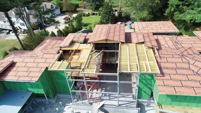

Detailing the Building Envelope
Because of the size of the project, we worked in sections, erecting the steel and framing in one location while ordering the materials for the next. Once the steel framing was packed out, framing and sheathing the structure was straightforward.
Going into this project, we knew getting the air-sealing right and meeting the performance standards that we like to build to was going to be a challenge. In Virginia Beach, where we work, a blower door score is not yet required for code but is in the process of being adopted. Once that’s in place, we will need to hit a blower door score of 3.0 ACH50 to pass code. So from day one, even though we realized that we would not reach passive house standards, we have taken as many steps as possible to ensure good air-sealing details, with a goal of scoring below 2.0 ACH50 (as of the writing of this article, we have not tested the house.)
Large gaps between the steel and the wood framing were filled with fluid-applied flashing membrane.
After the steel was packed out, the structure was framed and sheathed conventionally.

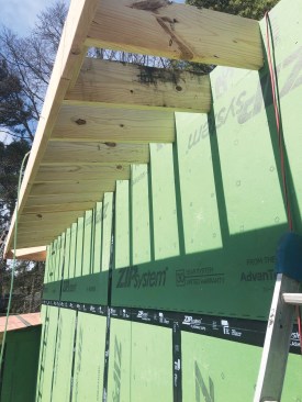

Starting at the sill-plate connection to the CMU foundation wall, we used two heavy beads of ProClima’s Contega HF, a highly elastic adhesive caulk, below a foam sill sealer, and another two heavy beads between the sill sealer and our 2×8 mud sill (we borrowed these details from Jake Bruton, a Missouri builder who has written about air-sealing for JLC; see “Air Sealing That Works,” Apr/18).

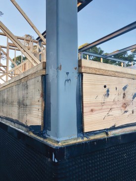

After our floor system box was framed, we sealed the gaps between the framing and steel columns with Zip System liquid-applied flashing. While this step is probably redundant, since the Zip R6 sheathing that we used to sheathe the house is the air-sealing layer, we figured the gaps were big enough that it couldn’t hurt to take care of them while we had access to these locations.

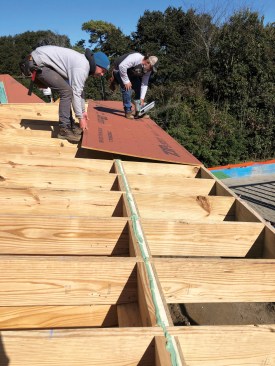

To air-seal the joint at the wall-to-roof connection, workers cut blocks of sheathing to fit snugly between the rafter tails.
They also installed blocking in the rafter bays, then sealed the roof sheathing to the blocking with Contega sealant.
We like to use Zip System sheathing on our projects because it offers a straightforward air-sealing approach that’s easy for our trades to execute. We followed standard Zip System installation practices until we got to the roofline, where in a perfect world we would have connected the wall plywood to the roof plywood in a continuous layer. But this project featured a large overhang and built-in gutters hanging on the ends of the rafters, so it wasn’t feasible or cost-effective to frame the overhang after boxing in the building envelope with sheathing. Our solution was to cut pieces of the Zip-R sheathing and a 2-by to go between each rafter bay to continue the Zip layer up to the roofline. From there we laid a bead of the Contega sealant on top of the blocking prior to the roof sheathing being installed to air-seal the wall-to-roof connection.
All joints and penetrations through the sheathing of the large home were sealed with either Zip tape or liquid flashing.
Once the roof sheathing was completed, our painting crew came in and sealed all the blocking between the rafters with Zip liquid-applied flashing. Later, they’ll seal around every pipe and wire that passes through the air barrier as well. We’re confident that the methods we’ve used will result in blower door scores that meet our goals when we are ready to test later this year.
