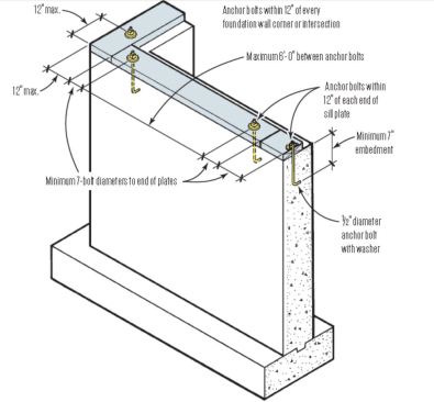

2. Improperly Placed Anchor Bolts
When it comes to footings and foundations, we expected the biggest offense to be improper rebar placement. We were wrong.
Given the anchor-bolt requirements (these conform to the 2012 IRC), it’s often easier to use epoxy anchors. J-bolts require coordination between framing and concrete crews.
Although some inspectors mentioned rebar, the error everyone cited was surprising: missing or improperly placed foundation anchor bolts. The ICC study also listed this as one of the violations that’s become more widespread, though it’s not clear why.
A common mistake Byle sees is bolt locations that don’t work with the mudsill joints. “You need a bolt on each side of every joint on the sill,” he said (see “Anchor Bolt Placement,” left). “But a lot of concrete guys just put bolts every 6 feet, rather than asking the framer where the joints will be.” The problem could obviously be avoided by better coordination between the framing crews and the concrete crews. Mathewson pointed out that anchor bolts are a lot harder to fix than some other problems, so it’s worth the effort to get them right the first time.
It’s worth noting, too, that the 2015 IRC now requires the anchor bolts to be placed in the middle third of the width of a foundation plate. This complicates bolt placement even further. For a 2×4 plate, that means you’ve only got about 1 3/16 inches of tolerance to get it in the right spot.

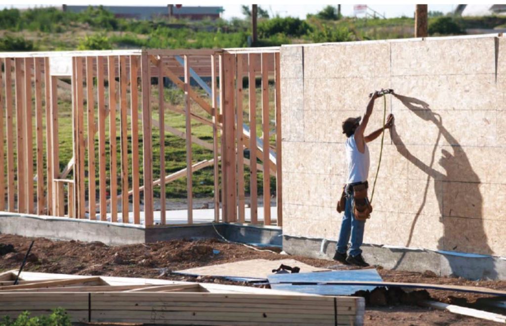

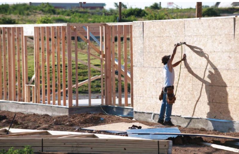

3. Braced Wall Errors
Code-mandated braced-wall requirements can be a head-scratcher for someone encountering them for the first time. “The requirements are new to a lot of builders and a lot of them are still climbing the learning curve,” Shapiro said. (See “Bracing Walls for Wind,” Jul/13.) But even when the bracing requirements are spelled out clearly on the plans, it’s the little details that often escape framers. The most common oversight Shapiro finds is missing blocking for braced wall panels. Code requires nailing along all panel edges, and that may require blocking between studs on tall walls or when panels are run horizontally. Fortunately, blocking is usually easy to add.
Code requires nailing along all edges of braced wall panels. This may require blocking between studs on tall walls or when panels are run horizontally. (photo: Chris Ulster)

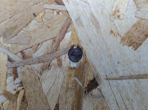

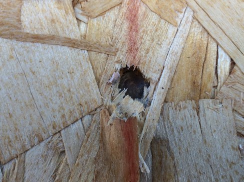

The problem Mathewson sees most often—overdriven nails in bracing panels—can take a bit more work to correct. “If you overdrive a nail, you can reduce the strength of a 7/16-inch panel to that of a 3/8-inch or 1/4-inch panel,” he said. (As an aside, he pointed out that this is a problem with nailing off hangers as well. Overdriving a nail dimples the steel, causing it to lose strength.)
Over-driven nail (left).
Flush-driven nail (right)

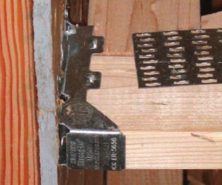

One of the biggest problems Mathewson sees is gaps at the ends of joists or trusses supported by hangers (photo at left). It doesn’t take much: Gaps can be caused by a girder truss that’s slightly crooked or out of plumb, making the time required to use a string line and level well spent.
Manufacturers of structural hangers usually specify a maximum gap of 1/8 inch between the end of the joist and the girder. Anything bigger will put moment arm on the hanger and drastically reduce its load capacity. When hangers are double-shear nailed (toenailed), large gaps leave the nails completely missing the carried member. “People get upset over this because they think I’m being punitive,” he said. “It’s not me, it’s the manufacturer’s load requirements.”

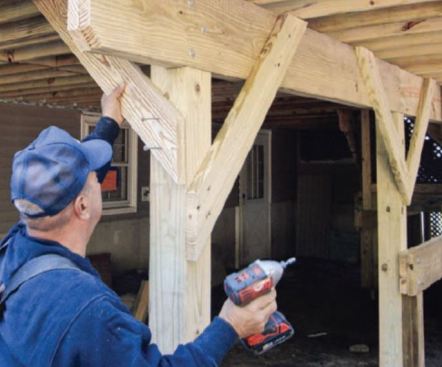

Despite more attention paid to decks, including the requirement in some jurisdictions for lateral connectors, he and other inspectors still see lots of issues with deck connections. On retrofits, he often recommends that the contractor build a freestanding deck with the deck frame an inch or so away from the house and the structure independently supported on posts . This eliminates the difficulty of properly flashing and fastening the ledger to the house.
He also finds builders falling down on deck shear-bracing requirements. Typically, diagonal post bracing is required (photo at right ). To further resist racking, builders can also use flat-framed 2-bys run diagonally on the underside of the joists . “Racking is a source of failure over time. If the deck isn’t properly braced, fasteners will work loose,” Byle said. He added that it doesn’t take much: “Something as simple as kids running around and banging into rails can put stress on the fasteners.”

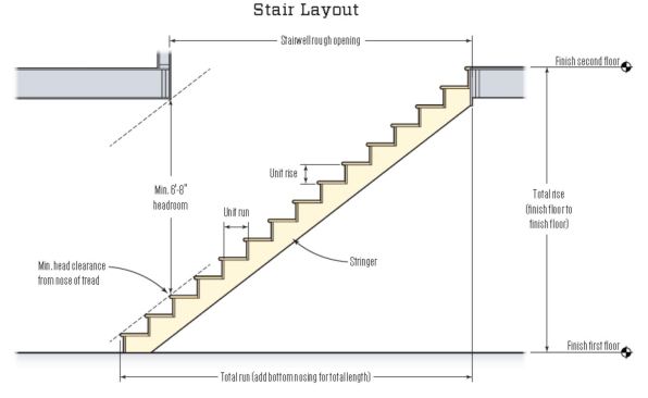

6. Stair Rise/Run Errors
Rise/run problems can arise where the builder doesn’t have enough horizontal space for a planned stairway. Headroom is a limiting factor (see “Stair Layout,” below), and Byle has seen a lot of builders try to squeeze the stairs in by simply pitching the stairway a little more steeply, resulting in a rise that may be too high or treads that are too narrow.
Headroom is often the limiting factor for a given stair opening. Building codes require a minimum 6 feet, 8 inches from the tread to the ceiling. Shortening the stairs only works if you can maintain tread and riser requirements. The steepest residential stairs allowed by the model building code (IRC) has 7 3/4-inch risers and 10-inch treads, however, these limits may vary by state.
Another common problem Byle sees is that builders, who may get the correct riser heights and tread depths, often don’t adjust for the added thickness of the flooring at the bottom. That leaves them with a bottom step that doesn’t match the rest of the stairway.
In Hampton, Va., building official Steve Shapiro finds a lot of rise/run errors on stairs leading up to porches from sidewalks. “I get the impression that people start at one end and work their way up or down,” he said. “Then they end up with a top or bottom riser that’s too short.” Some builders may assume that the inspector will overlook this on an exterior stair, but Shapiro pointed out that the riser and tread requirements apply equally to the interior and exterior of a home.
Keep in mind that liability associated with stairs goes beyond inspection failure. Byle, who also works as an expert witness, said that stairs come up again and again in construction litigation cases: “If the stair isn’t dimensioned correctly and someone falls, the jury is going to side against the contractor regardless of whether the stair actually caused the fall.”

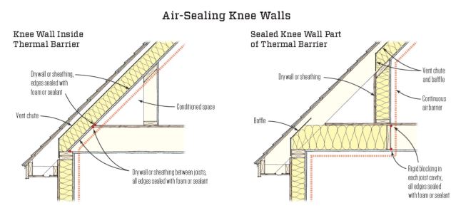

With more jurisdictions adopting energy codes, air-barrier gaps have become an issue. As is the case with fire blocking, these are often in hidden spots, such as behind bump-outs for gas fireplaces. “In the old days, the fireplace was just a hole in the wall,” Mathewson said. “Now you have to wrap the thermal envelope around the back of it.”
He also sees a lot of missing air barriers behind HVAC chases and attic knee walls. On a knee wall, this can be corrected by putting a rigid material like drywall, OSB or Thermo-Ply on the back of the wall (see “Air-Sealing Knee Walls,” below), but a lot of framers aren’t doing it.
Click here for enlarged version.
Knee walls are an area of the home where airsealing is often incomplete. The walls and roof might get done, but frequently the floor is left wide open. The best way to handle a knee wall area is to move the thermal barrier to the roofline (left) and stand up the knee walls after the ceiling has been drywalled. For production builders who may have less control in scheduling trade partners, the knee wall can serve as the thermal barrier (right), as long as sheathing is installed on the back side. Also, note the blocking between floor joists. Without this critical framing addition, ventilation air from roof vents can flow freely though the floor cavity.

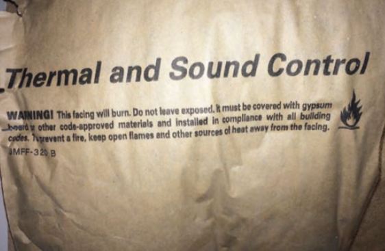

Speaking of knee walls, the backing is more than an air barrier; it’s also needed to cover kraft-faced insulation batts. These are often left exposed in knee-wall areas and in basements.
The warning label on paper-faced insulation batts clearly states: “This facing will burn ...” It cannot be left exposed but must be covered with drywall or other type of sheathing permitted by code. This applies in concealed framing cavities, in knee-wall areas (even if the knee-wall area is inaccessible), in attics and in crawlspaces. (photo: Glenn Mathewson)
The warning label on paper-faced insulation batts clearly states: “This facing will burn …” It cannot be left exposed but must be covered with drywall or other type of sheathing permitted by code. This applies in concealed framing cavities, in knee-wall areas (even if the knee-wall area is inaccessible), in attics and in crawlspaces. (photo: Glenn Mathewson)
Big mistake. “You can’t leave the paper exposed,” Mathewson said. In fact you can’t even leave a gap between it and the wall covering. “The paper is coated with a bituminous material and is highly flammable,” he said. “You don’t want airflow over the surface that could feed a fire.” The label printed on the insulation clearly states that the facing will burn and that it must be contact with the wall or ceiling covering.
