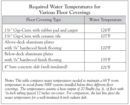

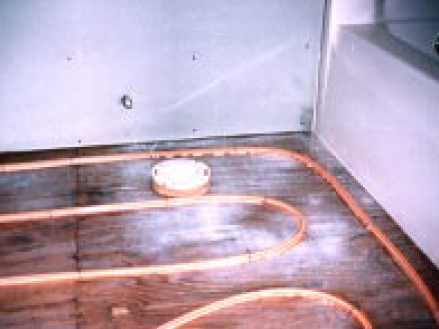

Finish flooring. Poured-in-place underlayments provide a good base for tile, carpet, or vinyl. Water temperatures in the tubing will vary, depending on the thermal resistance of the flooring material (see “Required Water Temperatures for Various Floor Coverings”). However, don’t install conventional hardwood strip flooring directly over a radiant floor. Instead, use a “floating” hardwood floor system (see “Radiant Heat & Wood Flooring”). Be aware that some strip flooring manufacturers will not warranty their product for use with radiant heat even when installed as a floating system.
Raise toilet flanges with plywood shims to accommodate the extra thickness of the slab.

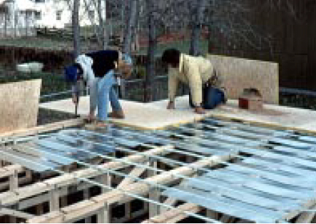

Instead of using a slab to transfer heat from the tubes to the living space, a dry system relies on preformed aluminum plates. These systems fall into two categories, depending on whether they’re designed to be installed above or below the floor decking.
In a typical above-deck dry system, aluminum heat-transfer plates are supported on plywood sleepers. The plates and tubes are covered with a plywood cover sheet before the finished flooring is installed.
Above deck. The first type, the “above deck” installation, is shown in the illustration above. Aluminum plates that fit around the tubes are supported by 3/4-inch-thick plywood sleepers that fill the entire space between the tubes. A cover sheet of 3/8-inch plywood is then laid over the top of the fins. Although hardwood strip flooring may be nailed directly to the sleepers, I don’t recommend it. If your clients want wood, steer them toward a floating system.

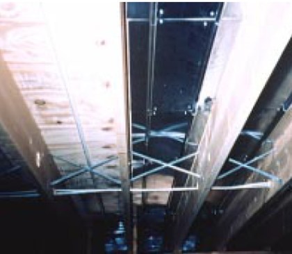

In a below-deck dry system, the aluminum plates wrap around the underside of the tubing. In new construction (top), the tubing and plates can be installed before the subfloor.

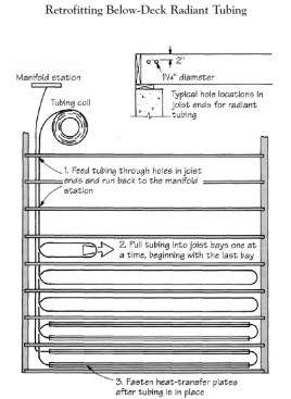

Below deck. The aluminum plates can also be installed beneath the floor deck, as in the images above. There are two ways to do this. In one, the tubes are laid on top of and perpendicular to the framing; then the space between the tubes is filled with wood sleepers. The sleepers support the single-tube aluminum plates and the whole assembly is covered with 3/4-inch-thick plywood subflooring.
In the other below-deck installation, the tubes are routed between the joists, and double-tube plates are used to span the entire width of the joist bay. With this method every zone is supplied by a single length of tubing that must be pulled through holes in the joists and fed out into the joist bays one at a time (Figure 4).
In most dry systems, only about half the surface of the tube contacts the aluminum plates. This lessens the rate of heat transfer from the tube compared to wet systems. To compensate for this, higher water temperatures are required — 10°F to 20°F higher than for a thin-slab system. These higher temperatures don’t pose a problem for the tubing, but could preclude use of lowtemperature heat sources such as hydronic heat pumps.

If the job requires a dry system — which is usually the case when retrofitting floors with limited bearing capacity — the below-deck installation with the tubing running parallel to and between the joists is usually the least expensive. No sleepers or furring strips are needed, and you don’t need an extra layer of plywood for a cover sheet. The limitation of this approach is that you’ll need ready access to the underside of the floor deck, which must be free of pipes, ducts, and other obstructions.

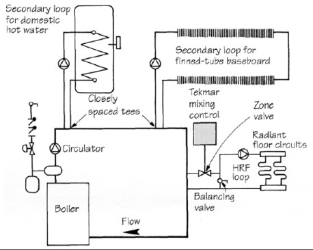

Hybrid Hydronic Systems
One big advantage of hydronic heating is its versatility. Using a single boiler, you can install radiant heat beneath the floor tiles in a bathroom while running finnedtube baseboard everywhere else. The same boiler that’s used for space heating can also be used to heat domestic water, by routing the boiler’s output through a heat exchanger in an indirectly-fired hot water tank. The problem is that these loads require very different water temperatures. A radiant floor may use 105°F water, while the hot water tank needs to be kept at 160°F.
Figure A. The most common way to run a domestic water heater and an HRF system from a single boiler is to place each load on a parallel piping loop. A four-way mixing valve controls the temperature in the HRF system.
The most common solution is to place each load on a parallel piping loop (Figure A above). A parallel loop for domestic hot water originates near where the hot water supply exits the boiler, and ends close to the return. A motorized four-way mixing valve at the beginning of the HRF loop blends high-temperature water from the boiler with cooler return water from the radiant floor. This lets you adjust the water temperature in the tubing much as you would use hot and cold water valves to adjust the water temperature in the shower. Mixing valves can be expensive, however: A typical 1- inch-diameter four-way valve with its associated control system can cost from $600 to $950 for parts alone. For small jobs like single bathrooms, that can be greater than the cost of the radiant floor system itself.
Figure B. An alternative is to place each load on its own secondary loop and use a 24-volt zone valve with an injection-mixing control unit to regulate the temperature. The valve mixes pulses of hot water from the primary loop with cooler return water from the HRF loop.
You can save money by using an alternative piping arrangement and a relatively inexpensive control unit (Figure B above). A continuous piping loop, called the primary loop, runs uninterrupted from boiler supply to boiler return, while each domestic hot water and hydronic heating load is connected to a separate secondary loop with its own circulator. The secondary loop’s supply and return tees are placed within a foot of each other on the primary loop. The temperature of the HRF loop is regulated by a standard 24-volt zone valve that’s placed between the primary and secondary loops. It’s operated by a Model 351 Injection Mixing Control that’s available from Tekmar Control Systems (see “Sources of Supply,” at end of article). Together, the valve and the control list for around $300 (the control lists for $233, while a typical 3/4-inch motorized zone valve costs about $75).
The Tekmar unit receives signals from three temperature sensors, one in the heated space, one on the warm water supply pipe to the HRF distribution system, and one outside the house. When the unit decides that the HRF system needs heat, it opens the zone valve to inject a pulse of hot water from the primary to the secondary loop. At a tee just beyond the zone valve, the hot water mixes with cool return water from the HRF system. The amount of mixing is regulated by a balancing valve that’s carefully set when the system is installed, then left alone.
