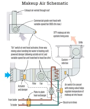

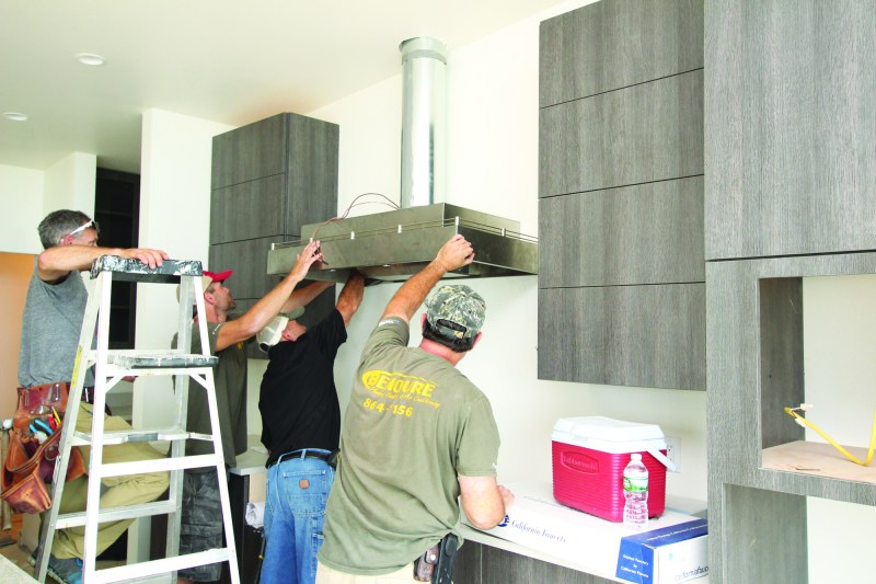

Here’s the wrinkle, says Bradley: “This house is getting a gourmet-quality kitchen. This cooktop is going to have 168,000 Btu worth of burners, restaurant quality, with a restaurant-quality vent hood. We’re looking at a 600-cubic-foot-per-minute (cfm) outflow, on a house that’s going to be super-tight.” That 600 cfm of exhaust is “guaranteed,” says Bradley: The unit can sense airflow and ramp up to as much as 900 cfm at the intake point in order to achieve an effective outflow of 600 cfm.
Knowing how tight the house was going to be, Bradley was concerned. Fresh air for the house was to be supplied by four pairs of Lunos e2 ERV fans, plus one Lunos Ego unit in the bath. Lunos units alternate between drawing in air and expelling air, with an energy storage core serving to recover heat. But the kitchen fan could easily have overcome the small, low-voltage fans on the Lunos systems, causing them all to admit outdoor air at the same time and disrupting their heat-recovery functioning. “This could have been a building-science nightmare,” Bradley says.

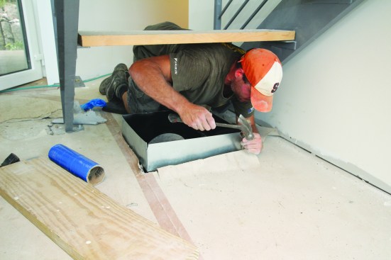

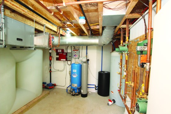

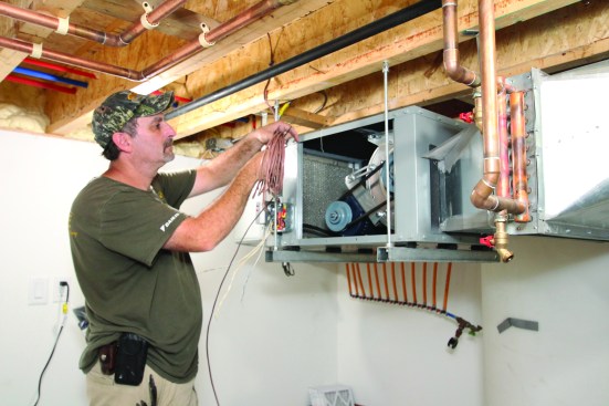

Bradley turned to Paul Blanchard at wholesaler F.W. Webb’s branch office in Williston, Vt., for guidance (fwwebb.com). The photos (above) show the system that Blanchard cooked up, as installed by Benoure Plumbing, Heating & Air Conditioning of South Burlington, Vt. (benoure.com). Complicating the problem was the fact that this house, built on a superinsulated slab, has no real basement aside from a small 12-foot-by-12-foot under-floor area for mechanicals. It was into this mechanical space that Bradley and Blanchard had to squeeze their makeup-air duct system.
A dampered louver at the exterior wall is controlled by a relay that’s wired into the switch for the kitchen range hood. Also wired to the kitchen switching is a control for the intake fan. Bradley says, “We were able to tie into the low-voltage control at the hood, and we ran wires all the way back to the basement so that when the cook selects low, medium, or high, it will cause the combustion air makeup fan to ramp up accordingly. It’s designed to marry what is going on at the vent hood.”
Vermont has cold winters, and dumping 600 cfm of fresh air into a heated room in the dead of winter could cause some discomfort. For that reason, Blanchard provided for heating the makeup air by placing a hydronic heating coil in the duct run between the outdoor intake and the floor grille where makeup air emerges into the upstairs living area. The heating coil is equipped with a thermostat and control circuitry that senses the indoor temperature and the temperature of the indrawn outdoor air, and it warms up to temper the incoming air as needed.
