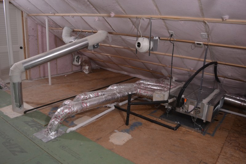

An encapsulated, semiconditioned attic houses the mechanicals for one of the author’s highperformance homes. A fan-powered freshair intake draws in a continuous 20 to 30 cfm. Below that, a five-zone air handler distributes conditioned air to occupied rooms below. Behind the sloping kitchen exhaust duct is a makeup air intake, which opens whenever the kitchen exhaust vent downstairs creates a negative pressure.

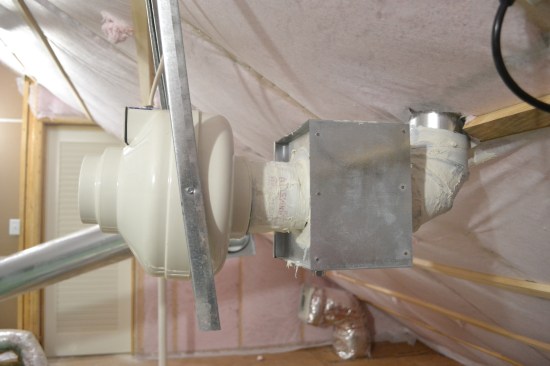

Here’s a closer look at the home’s air intake ports: a fanpowered inlet that supplies continuous fresh air

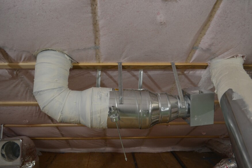

A makeup-air inlet with a weighted passive damper opens only if exhaust vent fans depressurize the house.
The minisplit’s air handler circulates air through the home 24 hours a day. The variable refrigerant flow (VRF) heat-pump system has an inverter compressor in the outdoor unit that varies the power consumption and output, and the indoor air handler has a linear expansion valve that also varies the amount of refrigerant entering the coil, to satisfy the instantaneous demand. The system efficiently supplies just a trickle of heating and cooling as needed by any of the five zones. The continuously operating, quiet, and efficient fan is well suited for the distribution of fresh air.

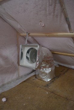

A large jump duct in the attic floor allows free airflow between each bedroom and the buffer space for pressure relief.
We bring that fresh air into the house with two independently operating intakes located in the buffer space. A Fantech FR-125 inline fan with a 4-inch duct serves one intake vent, controlled by a Fantech switch in the laundry room on the main level. The fan can move as much as 200 cubic feet per minute (cfm), but we initially set it to 20 or 30 cfm and advise the homeowner to keep it there.
The continuous stream of fresh air drawn in by this fan is dumped directly into the attic, where it is tempered and preconditioned by mixing with air in the space. Then the air is drawn into the open return side of the air handler (located just a few feet away from the inlet) and distributed via the air handler to the occupied rooms in the house below.
The other intake vent provides makeup air as needed for the 400-cfm kitchen range exhaust vent. This intake is connected to a 10-inch Broan barometric damper, which opens whenever there’s negative pressure in the house. A lever with a counterweight allows the damper to open only as far as needed to provide the volume of air that the range hood needs. Again, the outdoor air moves first into the semi-conditioned buffer space, where it mixes with return air that is coming from conditioned rooms in the house through a series of large jumper ducts in the ceiling of each bedroom and through louvered doors that separate the attic and the conditioned space. Should there happen to be another source of makeup air (such as an open window), the range hood might not depressurize the house; in that case, the damper stays closed.
When the kitchen exhaust is running for typical short durations, most of the air entering the kitchen will be tempered air that has already mixed with other attic air, rather than hot or cold air drawn directly from outside, so the kitchen doesn’t get a direct, harsh blast of outdoor air. Most of the air drawn into the attic through the dampered vent will end up being conditioned by the minisplit and distributed into the rooms of the house via the air handler and its five supply ducts.
