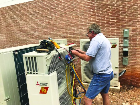

Gilbert Rosipal of Air Rite By Design of Austin, Texas, wires up a Mitsubishi variable refrigerant flow (VRF) outdoor unit. Controls in the compressor allow the system to ramp its power up and down gradually, dialing back to as low as 15% of full capacity when appropriate to address “part-load” conditions.
Heating and Cooling Equipment
These days, we prefer to specify VRF equipment, which represents the future of the hvac industry. VRF stands for Variable Refrigerant Flow, and modern VRF equipment offers advantages in at least three areas: efficiency, occupant comfort, and zoning capability.
In the old days, air conditioner or heat pump compressors had two modes of delivering power. Either full on, or off. More recently, dual-stage and unloading compressors have come into the market that add a second option, at either 50% or 65% of full capacity. VRF is a generation ahead of that dual-stage equipment. What VRF supplies is the ability to continuously vary the capacity of the machine. Quick reminder that capacity (power) is a rate, not an amount (energy). The goal is to vary the rate of heating or cooling to match the rate of heat leaking out or in through the enclosure.
I use a car analogy to explain the difference. Suppose you hop into your truck to go somewhere, and the rules are, you have to floor the accelerator all the time, and you control the speed of the truck by turning the ignition key on and off. That’s standard single-stage equipment. With VRF, you now have a gas pedal: You can smoothly vary the power output of the engine depending on how fast you need the vehicle to go. A four-ton VRF compressor like the Mitsubishi City Multi can smoothly vary its power all the way from 48,000 Btu/hr down to 15% of that, or anywhere in between.
This capability in the VRF equipment provides the ability to efficiently manage “part-load” conditions, when standard equipment suffers from the problem of over-sizing. ACCA Manual J is the industry standard manual for sizing hvac equipment. Manual J is often referred to as a load calculation. A word is actually missing there: It’s a peak load calculation. The Manual J load is representative of the peak heating and cooling loads you’re going to see in your climate zone for 1% of the hours throughout the year. Designers size their equipment to handle the peak load. But the vast majority of the time, your building will not see loads that high. It will see loads at what we call “part-load” conditions, when one-stage equipment runs in less efficient stop-and-start mode, that also causes more wear and tear on components. VRF equipment with its ability to give variable capacity is able to meet part-load conditions more efficiently.
Matching power to the load is not the only reason that a VRF compressor such as the Mitsubishi City Multi is more efficient than a standard compressor. The other reason is the design of the compressor motor. The electronically commutated motors in these units are driven by an inverter, and the inverter has the capability of adjusting not just the frequency of the current being delivered to that motor, but also the voltage. By playing with those two parameters in concert with one another, the motor achieves the highest power factor possible at any given speed and any given load that the motor is under. This improves the Energy Efficiency Ratio (EER) of the equipment (which expresses how many Btus of heat are moved for every watt of energy that you have to purchase). Simply put, you’re getting more heating or cooling per watt out of the VRF equipment at any speed. We’re getting more mechanical work than we were with the previous generation of equipment, for the same amount of power. So even at peak load, a 4-ton VRF system with inverter drive runs much more efficiently than a 4-ton single-stage or dual-stage system sitting next to it.
You can think of this in terms of the amps required to start and run the compressor motor. A standard single-stage four-ton unit will take about 100 amps of power to get started, and then will run at about 40 amps continuously once it gets going. A four-ton Mitsubishi City Multi will start out at about 2 amps, then it will ramp up slowly if necessary to meet the demand, up to about 24 or 26 amps. When the temperature in the space approaches the set point, the VRF unit will slowly reduce power and creep up to the set point, and, guided by its software, will then run just hard enough to maintain the temperature at exactly that set point. The traditional equipment will overshoot the set point, shut off, and then wait until the temperature rises above the set point again before it starts up again.
In practice, the lower amp draw combined with the the precise control of the VRF unit adds up to a savings of 20% to 40% in energy consumption. And because with a properly functioning controller the unit maintains a rock-steady set point, it also provides better comfort, without swings in temperature.
One last automotive metaphor that fits here. Remember carburators? They went away. They’re no longer used not because they did not work, but rather because fuel injection systems performed the same functional role more of distributing fuel to the engine efficiently and reliably. If you take nothing more from this article, please reset your view of VRF. VRF (which has been around since the 1980s) is not new, it’s not a fad that will die out. In fact, it could be that not to switch to VRF is the risky decision. Consider this, in 10-15 years when you need replacement parts, what will be occupying the shelf-space in distributors’ warehouses? Beyond the availability of parts, as someone who used to rebuild carburetors, both the parts and the installer expertise are needed to make things work. Will future generations of installers resist or appreciate the ability to connect a computer?

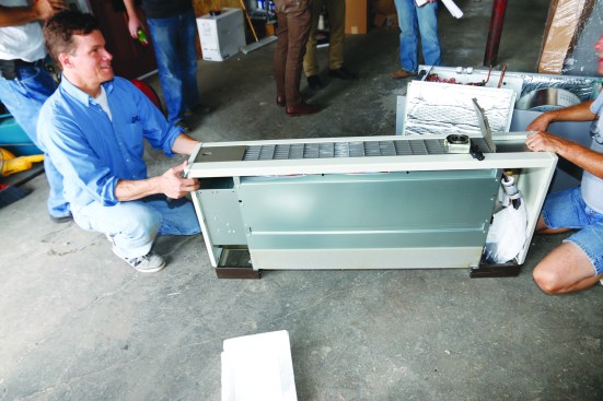

The author examines a Mitsubishi PFFY compact air handler. This small unit is useful for handling the heating and cooling requirements of peripheral zones in a building and can be one of multiple air-handling units connected to the same outdoor VRF compressor.
Air Handlers and Zoning
The outdoor compressor is linked to indoor units by refrigerant lines. Depending on the size and model of the compressor, a VRF compressor can handle anywhere from several indoor units up to dozens of units (in the case of big commercial equipment running on three-phase power). The homes we’re designing for typically have single-phase power, so we’re restricted to the equipment that can run on single-phase. We typically call for one or more Mitsubishi City Multi S-Series compressors, rated at 3, 4, or 5 tons, each of which can serve 8 independently controllable indoor units.
The indoor units could be anything from wall-mounted units or ceiling cassettes to variable-speed vertical or horizontal air handlers (commonly known as “multi-position”) much like the form-factor of air handlers for a traditional system. Our clientele has not embraced the visible wall-mounted units, so we typically specify one or more Mitsubishi multi-position air handlers and conventional ductwork. This form factor also leverages our ability to impact architectural decisions early in the design process. Again we benefit from non-split-incentive decision making: most homeowners understand that impairing access to their AHUs impairs the ability to provide quality installation and maintenance.
When it comes to zoning and duct design, there have to be conversations with the owners and the architect. Many in the industry, particularly residential, have grown accustomed to a process based only on an installation and not on any planning during the design stage. Architects don’t always consider the ductwork when they’re drawing house plans, but they should. I want architects to be thinking about the ductwork early enough in the process that the ductwork can be allowed for. Not leaving room for the “lungs of the home” or building is not really a full design. Perhaps calling it “ductwork” conceals that fact that we are talking about the distribution system that delivers thermal comfort and indoor air quailty. By “leaving room” I mean two things: Both room in the design process, and room within the architectural and framing designs. The simple concept of an integrated process, one that aligns architectural, structural and mechanical designs, is catching on strongly because it’s simple, effective and improves outcomes.
As for zoning, that requires a conversation with the customer on how they plan to live in the space as well as an analysis of the building. We zone the building by load profile and use profile. Load profile means, for example: “This room is facing east. That room is facing west. Those are different load profiles. This room’s on the first floor with very little exterior load and glazing. This room’s on the third floor. So those are different load profiles.”
You can also zone based on use profile: “This is the bedroom, it’s not occupied during the day. This is the central core. It’s rarely occupied at night. Those will be different zones. This is the man’s office. He wants to have it at a certain temperature. Or this is the woman’s sanctuary inside the house. She wants to keep it in her comfort zone. These two rooms are occupied by a teenage daughter and an 8-year-old son. They’re not going to want things the same, so give them each their own control.”
In the case of the east and west sides of the building, we may choose to give each zone its own outdoor compressor. That way, during a season with chilly nights and warm days, if the sun starts to overheat the east side in the morning while the west side is still cool enough to need heating, we can handle both needs at once.
But most zones aren’t going to have opposite needs, so multiple zones can usually be run off the same compressor using refrigerant lines and controls. In that case we give each zone a dedicated air handler and air distribution system that serves that area. Because we can have multiple air handlers served by the same outdoor system, VRF gives us the flexibility to do that and keep the initial cost down. This also minimizes the footprint necessary for all the equipment.
Sometimes, we get into a situation where the zones are too small even for the smallest air handler. In that case, we do “air-side zoning” — we zone the areas using dampers and controls in the duct system served by a single air handler. And occasionally, there’s a point load that is best handled by a wall-mounted unit, such as a laundry room or a garage.

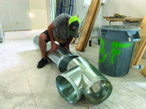

An installer for Air Rite By Design of Austin, Texas, assembles metal ductwork on a jobsite. Positive Energy specifies metal duct for all installations because of its durability and for sanitary reasons. Once installed, the ductwork is buried inside permanent building assemblies and is difficult and expensive to access or replace, so durability is a key aspect of quality.
Duct Systems
Duct board box plenums and flex-duct supply lines are typical in the industry in our market. We don’t do things that way: We specify metal duct for all our designs. In our view, flex-duct and duct board air distribution systems need to go away. Why? Well, think about it. People put a lot of effort into constructing a durable, functional enclosure. You have one chance to get it right, and then it’s inconvenient to fix it forever. The ductwork is the same way: It’s a durable, functional, passive assembly; you have one good chance to get it right, and then it’s inconvenient to fix it forever. And together with the enclosure, the duct system defines the breathing zone of the occupied space. The air distribution system is a permanent, durable part of the home that serves you well forever, or serves you poorly forever. Metal duct is appropriate for that situation.
Metal is a durable material. It will last the life of the home, if attached well and done well. And it’s a recyclable material, so at the end of its life cycle there is something we can do with it.
Metal has a natural galvanic action that retards the growth of indoor micro-biological organisms. That includes mold and bacteria, and even viruses and protozoa and all kinds of little living creatures. With air quality in mind, we always aim for fiber-free air distribution systems. The nooks and crannies of ductboard and turbulence created by flex duct spiral pressure liners do not help keep distribution systems clean.
Clean is another way of saying free of food, or substrates on which to grow unhealthy indoor microbiomes. If you think flex duct and ductboard is “fine” please keep in mind that your assessment is not an immutable physical law. It’s an assessment based on comparative metrics. Be clear on what your comparing to and what outcomes are priorities. You “eat” air all the time, is poor IAQ “fine”? Perhaps in the way that a greasy burger and fries is a “fine” diet compared to starving in sub-Saharan Africa. What really makes flex duct and ductboard the norm is the fact that it supports a beneficial economic outcome. Our industry is based on both interchangeable parts and exploitable and interchangeable labor. But that’s a topic for another day.
You get one good chance to get it right. This is perhaps the key consideration: an air distribution system moves tens of thousands of pounds of air every day. It will do so with either a lot of friction, very little friction, or somewhere in between. Using low-friction metal distribution systems based on the principles of fluid mechanics is analogous to having the right amount of air in your tires. Rolling resistance resists motion. So does friction in duct systems.
If you buy an efficient car, but then you drive on tires that are nearly flat, you’re going to lose a lot of the efficiency in that vehicle to rolling resistance. Of course you can always inflate your tires. You’re not going to roll around in your Prius with your tires half flat. But if you have ductwork with high friction resistance — like most duct board and flex duct the way it is typically installed today — you’re stuck with it forever. Just because you and your clients don’t see or value the ducts does not mean they don’t matter. Air distribution systems matter for the life of the home. It only makes sense to do it right when you’ve got the chance.

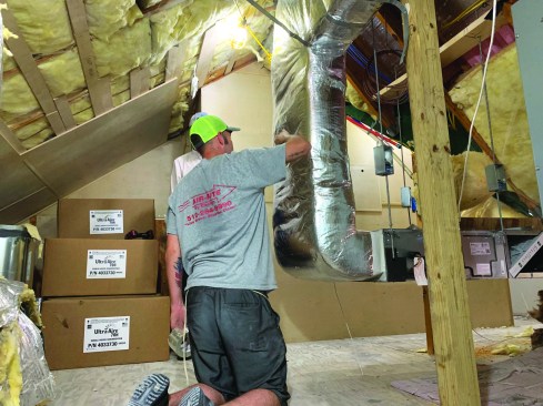

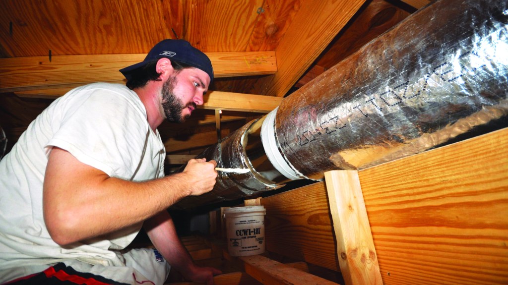

An installer for Air Rite By Design tapes insulation on a duct. Even though the ducts are within the conditioned envelope, they still must be insulated. At right is a multi-position air handler for a variable refrigerant flow (VRF) system. The air handler is suspended from the roof framing with threaded rod and vibration-damping couplings.
