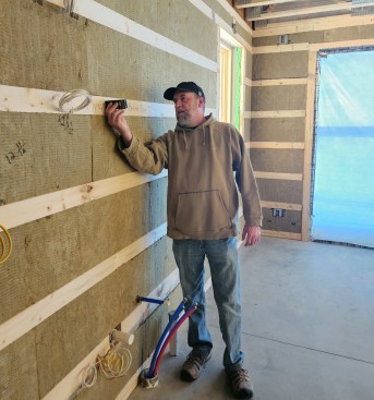

This article is based on the methods specified in ANSI/RESNET/ICC 380, which uses measurements for floor area from the exterior finish of the building. That means the author will need to add the thickness of the exterior walls to measurements like the one he is taking here.

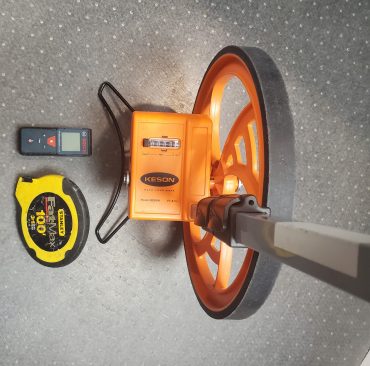

The author’s tools: laser measure, measuring wheel, and long (100-ft.) tape measure.
I prefer to use a laser measuring device, but I sometimes will also use tape measures and measuring wheels. Lasers work well if you have a line of sight between the two areas being measured; occasionally, it will be necessary to add measurements of several different rooms together to achieve a total length. I do round measurements to the nearest quarter foot.
