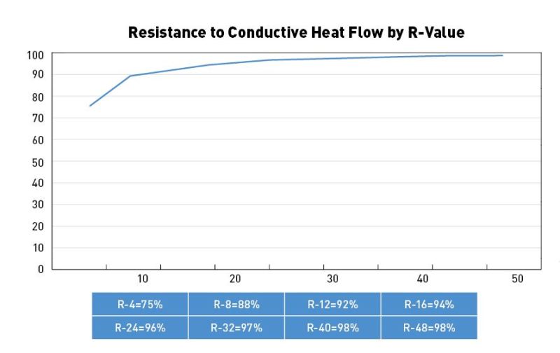

This graph, along with the table showing R-values as a percentage of resistance to heat flow, illustrates the diminishing returns that result from scaling R-value.

Scale
The first and most critical weakness of R-value is the scale’s disconnect from practical understanding and application. The scale derived naturally from a mathematical formula (R-value = temperature difference across the insulation barrier divided by heat flux through the insulation barrier), but most people cannot extract actionable meaning from a static R-value rating. Benchmarking the percentage of conductive heat flow resisted by an insulation material against 100% (0 to 100% scale) would more intuitively communicate its relative effectiveness compared with competing products. R-value does have the helpful feature of being additive, meaning that insulating products may be stacked (or different insulation products combined) to achieve a cumulative R-value sum. Conversely, a percentage metric is not additive, which we discuss in the next section, but this difference could be clearly explained in labeling.
The R-value of an insulation product is the reciprocal of its thermal conductivity coefficient (TCC), and the percentage of heat flow blocked or resisted by that material is one minus the TCC. As an example, the TCC of an R-16 product is 0.0625 (1/16), and the percentage of conductive heat flow blocked or resisted (under typical conditions) is 94% (1 – 0.0625, rounded). Labeling an insulation product as achieving 94% resistance to heat flow would be far more instructive to decision makers than R-16. The “under typical conditions” qualifier above is needed for both R-value and its associated percentage of resistance to heat flow, as both metrics will vary slightly based on operating temperature, temperature difference across the insulation plane, and the building plane on which the insulation is installed (driving force). But the variances are small, and a more actionable number with caveats would be more practical than a precise metric that means little to consumers.
One simple improvement would be to require labeling that includes the percentage of conductive heat flow resisted. For the example above, the product might be labeled R-16=94%*. The asterisk is needed to qualify the additive differences between these two metrics, to acknowledge ratings under typical conditions, and to disclose limitations against other forms of heat flow. This is discussed in more detail in “Summary and Solutions,” below.
Diminishing Returns
The second weakness with the R-value metric is that it ignores the diminishing returns of adding more of the same insulation, or stacking insulating products, which results in misconceptions about the value of increasing insulation levels (see “Resistance to Conductive Heat Flow by R-Value,” above, for an illustration of the diminishing returns of scaling R-value). We have noted the helpful feature of R-value being stackable. However, without the percentage scale outlined above, most consumers will assume that insulating value is proportional to the combined R-value rating. For example, if we go from standard cavity insulation in a 2×4 wall (R-11) to a 2×6 wall (R-19), we do gain 42% more R-value (an increase of R-8). But many, even those who work in the building industry, assume that we get 42% greater resistance to heat flow, which is false. The 2×6 wall slows heat flow by only 4% more than the 2×4 wall.
The R-values that building codes in most temperate climates currently require in floors, walls, and ceilings are on the waning end of diminishing returns. In many cases, adding thickness (and additional R-value) of the same insulation only negligibly reduces heat loss while incurring significant financial and environmental costs. To restate this concern, there may be fractional advantages in reduced conductive heat flow by increasing R-value beyond the code requirements, yet there will also be added labor and material costs, affecting both finances and resources. The returns are less than optimal for the individual payer and society at large, yet the perception persists of net benefits gained by bulking up the thermal envelope with insulation R-values. Depending on the building structure, it is often advantageous to combine different insulating products to reduce heat flow. The thermal advantages come from factors other than conductive losses, such as limiting thermal bridging and convection. One common example is continuous exterior rigid insulation, which, in combination with stud cavity insulation to meet R-value code for walls, helps reduce convection losses and breaks thermal bridging through framing members.

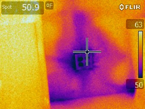

In this typical cold-season thermal image of a recessed electrical outlet in an exterior wall, the purple and pink show cold spots resulting from air leakage and compromised insulation.

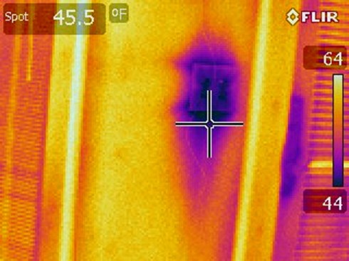

Similarly, the  purple and pink spots on this thermal image of a light switch in an exterior wall show the cold areas due to poor insulation and air-sealing.

The third concern with the predominant use of R-value is that without labeled caveats, it invites the misconception that R-value determines the effectiveness of the thermal envelope. R-value is not misleading for what it claims and reports, but without context, it opens the door to misunderstanding. R-value is a measure of resistance to conductive heat flow, but there are also convective and radiative losses through thermal envelopes that insulation at any R-value will not resist; this is described in a concept called effective R-value. Additionally, myriad other weaknesses get designed and installed in buildings. Even after the thermal envelope is carefully engineered and crafted, we poke holes in it to meet other code requirements or to make the indoor space more livable and aesthetically pleasing. Bath fan vents, dryer vents, and range hoods vented to the outside open holes through the thermal envelope and are often dampered with just a thin rigid flap (minimal R-value and ripe for convective losses). Beyond those perpetual passive intrusions, occupants use those vents to force conditioned air outside during operation, pulling in unconditioned air as replacement—a significant heat loss unrelated to thermal envelope insulation.

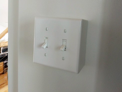

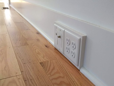

Utility penetrations also impact the thermal envelope. With careful planning, most plumbing pipes can be kept out of insulation planes, but required drain stack vents are open holes through the ceiling and roof, and they are often sealed with a single membrane around larger gaps in the upper thermal insulation plane. Electrical outlet and switch boxes are required by residential codes at prescribed spacing around walls, including exterior walls. These displace insulation and dramatically reduce R-value, creating permanent and excessive weak points in the thermal envelope, as illustrated by the thermal images above.
Though this issue is independent of our call for improved metrics and labeling, it is further evidence that required R-values in building codes alone are not a sufficient measure of thermal effectiveness. Regardless of wall thickness or installed R-value, pulling electrical boxes out of insulation cavities will avoid significant compromises of the thermal plane. Below are a couple of examples of functional surface-mount options .
Surface-mount outlets, cable, and Ethernet can be integrated with baseboard.
The surface-mount wall switch is an example of a fixture on an exterior wall that avoids wall penetrations.

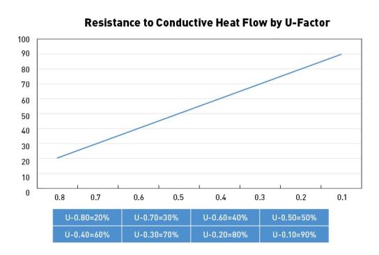

The calculation to provide the percentage resistance to conductive heat flow from a U-factor rating is simple: One minus the U-factor. Since U-factor is already a proportionate measure of how well a window insulates, the scale is not misleading like the R-value rating.
Converting U-factors to percent of conductive heat flow resistance yields the values shown here, which cover the typical range for windows and doors.
Converting U-factors to percent of conductive heat flow resistance yields the values in the table at the top of the facing page. The chart above does not represent the full range of U-factor ratings, but it covers most fenestration options and code requirements in temperate climates. Even the best insulated windows, sold at a high cost premium, typically lag the insulating value of the walls they are placed within, and that results in mismatched elements in a thermal envelope. For example, where we are writing in U.S. climate zone 4, the local building code requires a fenestration U-factor of 0.32, which is equivalent to an R-value of 3.1 (1/0.32) and 68% (1 – 0.32) resistance to conductive heat flow—well below the R-15/93% code requirement for walls in this jurisdiction. Consumers can upgrade windows, at relatively high cost, but even the best-insulated windows will resist conductive heat flow less than walls insulated to minimum code requirements.

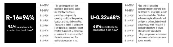

The authors propose a labeling scheme like this for insulation products (above left) and windows, doors, and skylights (above right) to better convey to buyers the effectiveness of the products to limit heat flow. The U-factor label also helps buyers understand the link between U-factor and R-value.
The sample labeling scheme shown above would be one way to include the percentage resistance to conductive heat flow, which is an immediately actionable metric that’s critically important for comparing different insulation products. Listing a broader range of the R-value scale would help consumers place specific products in the scope of possibility, and this range with the percentage scale would clearly reveal the diminishing returns to R-value. Finally, caveats could be added to disclose known limitations.
The U-factor scale does not suffer from the diminishing returns problem associated with R-value, but as a static metric, it does not support an intuitive understanding of heat flow. Also, it’s egregious that we have no requirements for linking U-factor and R-value. The sample labeling scheme shown below would be one way to include the percentage resistance to conductive heat flow, which is an immediately actionable metric that would also provide the link between U-factor and R-value.
Additionally, listing an R-value range on the U-factor label would help consumers consider how fenestration products compare with wall assemblies.
Finally, as suggested with R-value labeling, caveats could be added to U-factor labels to disclose known limitations. Windows have other important specifications, like solar heat gain coefficient, visible transmittance, and air leakage, and those also need to be included. The Federal Trade Commission (FTC) and National Fenestration Rating Council (NFRC) should want to improve information to consumers about the products and systems they regulate, and these samples provide what we believe are needed additions to product labeling. These changes will better inform consumers of the effectiveness of the insulation products they buy, provide a linking standard to compare U-factor and R-value ratings, and begin dispelling the misconceptions associated with diminishing returns to R-value.
