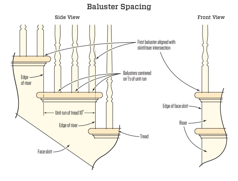

The first rule is that the balusters should be spaced evenly: The on-center distance between balusters should be the same for the whole stairway (see Baluster Spacing, below). This distance is dictated by the unit run of the stair (the horizontal distance between the face of each riser and the one above or below), which is typically between 10 and 11 inches on residential stairs. The IRC requires a minimum 10-inch run per tread, but Massachusetts and several other states allow runs down to 9 inches, which will make for a safe and comfortable stair if it’s designed correctly.
The distance between the baluster centers must be an even fraction of the run: 1/2, 1/3, or 1/4, depending on the number of balusters per tread. Generally, it looks better to have several balusters closer together, and code requires that no space between balusters be wider than 4 inches. For a 10 1/2-inch run, the balusters would be spaced 3 1/2 inches on-center (one-third of 10 1/2 inches). For a 10-inch run, the spacing would be 3 1/3 inches (don’t panic, your framing square has a 12th scale and 4/12 inch = 1/3 inch).
The baluster closest to the front of the stair sits directly over the miter between the face skirt and the riser. Divide the run of the tread by the number of balusters to find the exact on-center spacing.
Tim Healey The baluster closest to the front of the stair sits directly over the miter between the face skirt and the riser. Divide the run of the tread by the number of balusters to find the exact on-center spacing.
The location of the shortest baluster on each tread determines the location of the others. This baluster is always located with its front (downhill) face directly over the riser below and its outer face over the face of the face skirt—that is, the outer corner of the baluster should always be lined up directly over the point of the miter joint between the face skirt and the riser. This will always look right. If laid out properly, the longest (or rear) baluster on each tread will have the same spacing between it and the short baluster on the next tread up. It will look like you meant to do it that way. And, the centerline of the handrail will be one-half of a baluster in from the face skirt.
