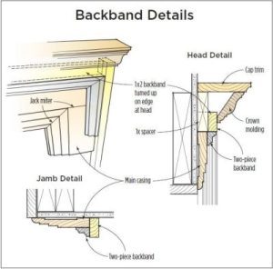

A flat, nominal 1×2 cap with a coved edge detail finishes off the crown.
Backband. I produced the profile for the two-piece backband on the router table, first hogging off the waste wood on the table saw. The backband turns vertically across the head casing for a slightly wider reveal.
I nailed the casing to the jambs with 1 1/4-inch 18-gauge finish nails and the outer edges to the wall with 2-inch 16-gauge nails. The backband is glued and nailed with the 18-gauge nails. The crown return miters are nailed with a 23-gauge micropinner.
The 2 1/4-inch crown molding on the head casing was the only stock molding I used in the assembly. A flat, nominal 1×2 cap with a coved edge detail finishes off the crown.
