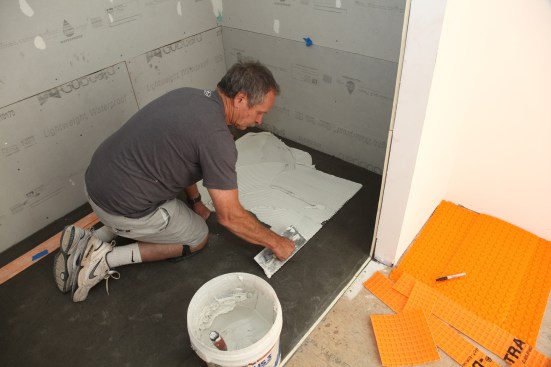

After the mud base is in place, the next step is to install Ditra Heat mat.
Thinset for the Heat Sheets
Using a 3/8-inch square-notch trowel, I spread unmodified thinset mortar from the line I drew over to the shower drain. Before laying down the sheets, the thinset should be combed in an even layer with the ridges all going in the same direction.
